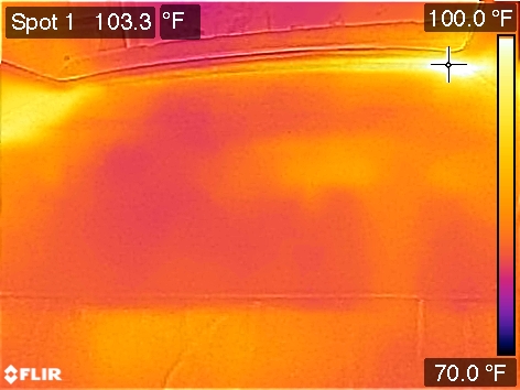

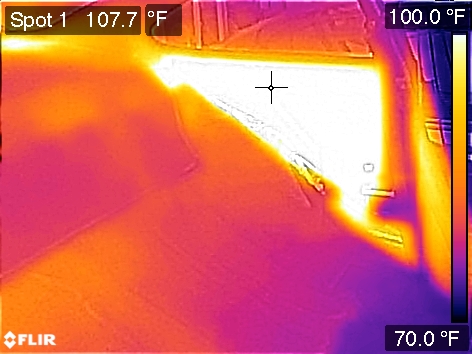

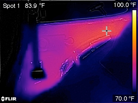

Since you're putting AC in this one, it will probably make sense to do some thermal control on the interior...The seatbelt panel and rear firewall from top to seat area get very hot...The best way to keep AC efficiency up is to keep heat out...These are some thermal shots of my car while it was sitting at idle for about 20 minutes (note that the photos were taken about ten minutes apart, so the left side looks much cooler than it would, also the rear was covered in carpet and sound deadening):
http://ensaster.com/pics/vehicles/sm.../flir/left.jpg http://ensaster.com/pics/vehicles/sm.../flir/rear.jpg http://ensaster.com/pics/vehicles/sm...flir/right.jpg
Marc I would love to but I do not know if it will be running yet
Tremelune, main reason on no second cooler in the fender being the ac system from classic retro fit goes in the other fender. No time to make up a rock deflector yet, after monterey will address alot of things that I just dont have time for at the moment.
The ship has sailed on the reinforcements for coil overs.
I have the second skin products on the interior rear firewall to keep out heat and MLV over that. The seat belt panels will not be used so the carpet will be going right on the metal, I do not trust it staying put over the insulating layer or the layer itself coming apart and sagging down.
