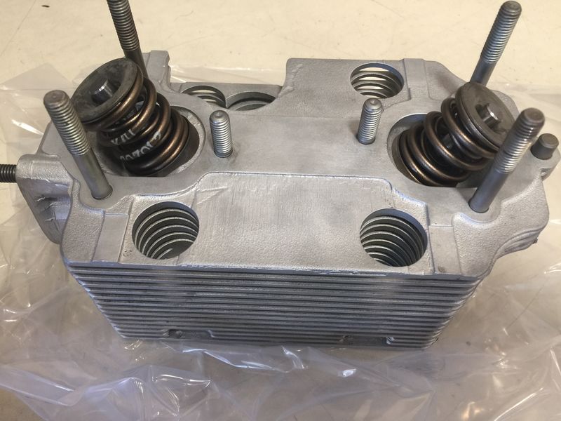

Hooo wee that one head with the toasted valve is ugly. Lucky that valve head didn't snap off and beat up the head, piston and cylinder. Lotsa leakage below that head too. How many broken studs did you guys find?
Ryan H 03-14-2017 06:42 AM
Actually none! I was surprised...

GaryR 03-15-2017 10:21 AM
If they are stock that is one thing I would replace anyway!!
al lkosmal 03-15-2017 12:11 PM
+1 on replacing the exhaust studs
GaryR 03-15-2017 12:16 PM
Absolutely, have the machine shop do it while the heads are being tweaked. Then use a copper based never-seize liberally on the new assembly!
Ryan H 03-15-2017 01:16 PM
Without a doubt. I'm replacing or updating everything that needs it or could potentially need it.

- Len at Sleepers Speed Shop has finished design for a new adjustable spindle and we'll be building a coilover to mate it to. Should be a very nice setup!
- Based on a thread in the engine building forum I've shipped my heads to Craig Garret to be rebuilt and upgraded with Eibach valve springs. We'll also be utilizing a pair or cams from Web.
- We're off to paint in a couple weeks as the engine gets re-assembled!

Ryan H 07-11-2017 12:48 PM
Craig is almost finished with the heads. Now I'm starting to acquire all the pieces for the bottom end rebuild.

al lkosmal 07-11-2017 02:54 PM
Heads
Craig just finished a set of heads for my current 3.0 build. He does very nice work. You will be happy...
http://forums.pelicanparts.com/uploa...1499813516.JPG
regards,
al

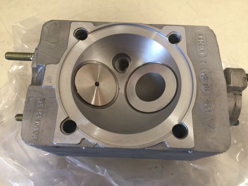

Ryan H 08-22-2017 07:50 AM
Quick update!
Heads are back from Craig and they are amazing. He was fantastic to deal with. I'll be running the Closed Course Motorsports ITB manifolds and Craig was kind enough to port match the heads. Super guy! We also installed Eibach valve springs.
