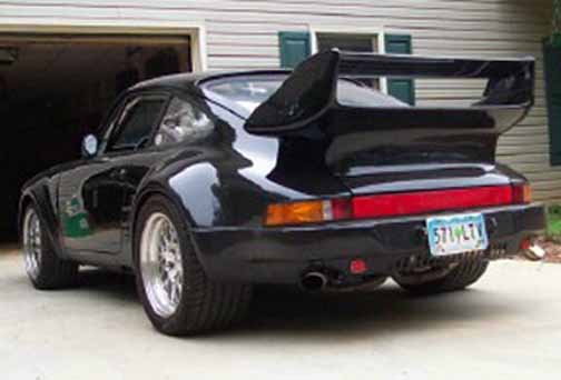

The fun has begun! Only the rear has been mounted so far, hopefully the front will be just as easy.http://forums.pelicanparts.com/uploads/Photo0003.jpg :)
KTL 04-02-2003 02:17 PM
Nice!
Post some details how you hung it if you could.
How do the fenders line-up? More pics?

The transaction with Brad went very smoothly. His parts are of a very good quality. The rear bumper lined up fairly well requiring only a little massaging. The factory screws/speedclips and bolts can all be reused in mounting the bumper (I did, however, replace the screws with new #10 zinc sheet metal screws from Home Depot). I had to remove the rubber strip to get the nice clean look. Also, on the corners where the turn signals are located, I had to do a little grinding with a wheel because there was some metal that protruded a little too far into the bumper shelf. All told including removal of old bumper and muffler and fitting of new rear bumper, I'd say I have about 3-4 hours in it, tops. I'll go zap some more pics for you.
Next question, does anyone have any good exhaust ideas? I'm considering adding the second outlet to my factory muffler or going the flowmaster route. I don't want to hack the bumper up til I figure that out though.

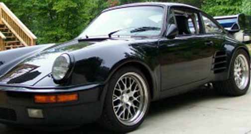

lin7310948 04-02-2003 05:47 PM
Ruf spoilers
a picture of 78 930 with Ruf spoilers...mounted very simply...no reinforcement behind. Car weighs approximately 2300 pounds.

lin, e-mail me the picture and I'll post it for you. Better yet, tell us what program you are using, and we'll teach you how to fish! ("Feed a man a fish. you feed him for one day. Teach the man to fish, and you feed him for life!")
MotoSook 04-02-2003 06:16 PM
Here you go lin....nice! Tell us more about it.
http://forums.pelicanparts.com/uploads/lins930.JPG
http://forums.pelicanparts.com/uploads/lins930 b.JPG
