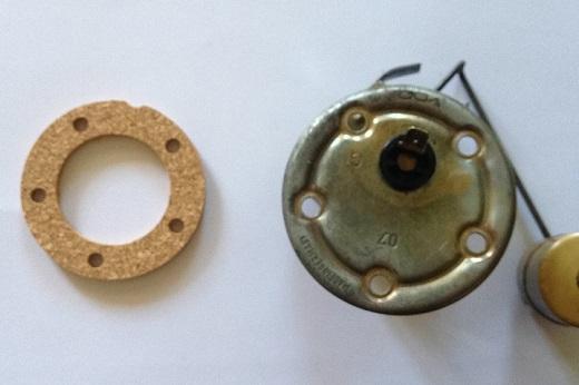

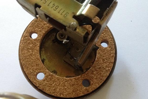

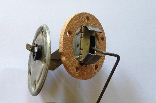

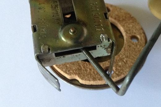

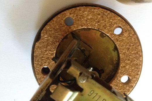

look very easy...gasket will slide over the oil sending unit only one way when it`s fit.
Last picture is when the holes are not lined up.
and not aligned
that little cut on the cork should face this side of the oil level sending unit.
