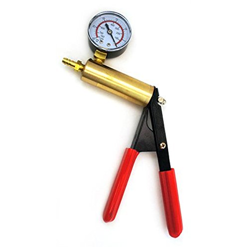

OK so I apply a vacuum to the port on the top (the one by the PN) or the port on the end/side?
I need to get a vacuum pump then, something like this I assume?

Yup a 089. Yes vacuum to the side port not the top. Top port is only a vent.
550mbar max to the side port. Wur should hold that vacuum with no issues.
this will raise your pressure with 0.6 bar roughly.
Next you measure the CCP with pump running but engine off.
Note the ambient when you do that and report back.
if you have a vacuum hose small diameter you can bypass the Thermal valve.
If the car does no longer have the issue you found the source.
Intrested to see what CCp you show in the summer when using the right procedure.

Hi all. So my Vacuum pump arrived and I have retested:
As before:
* Fuel pump on at zero, WUR (Cold) measured for 1st minute.
* WUR Electrical connector "ON" at green arrow.
* Fuel pump off at 8 minutes / blue arrow.
Orange trace: WUR Vacuum line attached (previous test)
Purple trace: Vacuum pump attached to WUR at 400mmHg (~550 mbar): Looks like Orange trace +1 bar.
Grey trace: Engine started, so this is my Control pressure as the WUR warms up.
Touching the throttle after 18 minutes killed the engine (as usual). Grey & Purple do not match... Is this a sign the TTV has not opened?
BTW I checked the connector on the TTV:
* 14 ohms across the pins.
* At FP on, TTV goes to 12V for 30 sec then switches off.
Not sure what I have learned here... Any suggestions what to try next?

so, pull a vacuunm on the WUR and see if it holds. once warm, connect the vac pump to the hose going to the WUR and check vacuum going to WUR.
check WCP with vacuum and without vacuum.
that hand pump is a nice tool to have around. I am surprised at how much I use mine. just used over the weekend.
