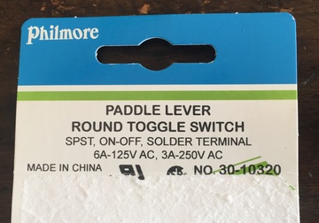

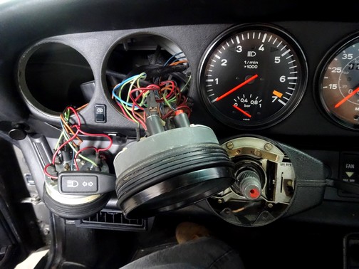

Bypass switch
http://forums.pelicanparts.com/uploa...1515079760.JPG
Top is bypass switch for brushless turbine. (Fuel pump kill* is bottom switch.) Paddles left = OFF. I soldered wires to bypass and kept heat on switch terminal(s) too long---not a good idea with this type switch. Inside switch, slot holding actuation pin deformed from heat rendering switch nogood. (This type switch can be opened easily. Used Pegatanke to recreate pin’s slot. Switch is back in business.)
http://forums.pelicanparts.com/uploa...1515078503.JPG
Paddle switch ref.
Pic before switch install. There’s a rectangular slot in gauge panel. Covering on panel appears stock suggesting this slot also being from factory. I don’t recall ever seeing anything in a 911 gauge panel at this position… anyone?
* Fuel pump kill switch is alternative to turning ignition OFF to kill motor. In case throttle sticks---which I’ve experienced and am not too fond of---rather than turn ignition key and risk locking steering wheel at a possibly inopportune moment… fuel pump kill is option. CAUTION: Takes a few moments for fuel pressure to drop enough to kill motor. Surly there’s a "spark kill" that would be better / instant. I also kill pump when parking long-term (to potentially squelch favorite car’s unwelcomed total bye-bye.
....rear wiper switch is good possibility.

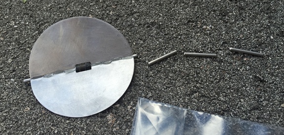

Air valve in making... doors. Now thinking would have been smart to put anti-seize on post & hinges. (Oxidation is likely going to have its way in there.) Adding this to list of to-do refinements. Thanks to Coastr for air-valve thinking.
http://forums.pelicanparts.com/uploa...1517151112.jpg

Valve is coming out to antiseize hinge-contacts and hinge-post. Post can only come out downwards when intake stack is assembled. Rod of same diameter is used to access post. For mental game: Think about how hinged valve doors with springs re-install (with intake stack remaining in car and assembled. Reason post can only go out and in from below is duct arches over valve area.)
http://forums.pelicanparts.com/uploa...1517588051.JPG
Tried pulling low temp welded hinges off door panels by hand----three hinges came off easily. Two were difficult. Three were solidly connected… I melted those off. Rather than repeat low temp aluminum weld, went with epoxy. Is much easier union to create and bond at each hinge is solid---cannot pull these hinges off by hand. Believe these parts could be successfully low temp welded (but more experience than I have is needed. With Muggy Weld’s Super Alloy 1 product (350 dF), heat needs to stay away from fluid-flux. Seems once flux is scorched… is not an effective bond. When all's done correctly, bond is strong.)
Antiseize heading to parts.
Tape is needed to position doors then pull them against seat so post can be inserted. (Pretensioning keeps valve closed when installed.)
Tape is part of solution needed to re-install valve. Multiple short post segments is rest of solution. These segments install temporarily and are pushed out of top as post is inserted below. Measure of each short segment is slightly less than “escape space” above valve. (Is good to install these short segments when removing valve---keeps springs & barrel from falling into filter well when hinge post is removed.)
Post being inserted from below. Short segment escaping above.
With antizeize (on everything that moves) and stronger hinging, air-valve should need no further refinement.
When installing duct above wheel---with insulation added and now floating on duct---was evident that duct was not jamming up and into crevice between fender and body as far as it did when naked. I left install as is thinking if there was a rub… tire would not tear system apart. Way CEET duct is made, it’s very spongy-strong---has excellent shape retention. In order to form CEET to a shape other than round… target shape needs to be dramatically exaggerated well beyond target shape wanted. I did squash duct for crevice-fit but not enough (to compensate for installing with floating insulation---the float being the problem.) Force necessary to adjust CEET duct to sit higher up in crevice… is good idea to remove it from fender to make this adjustment.
