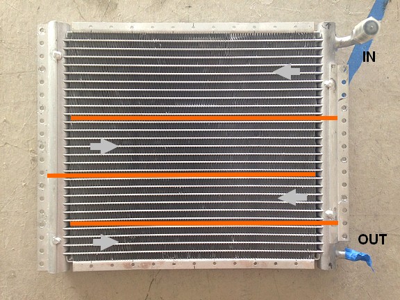

Repositioning inlet/outlet fittings
Way this condenser came, fittings pointed straight out the side. Changed them to 90 degree elbows thinking that might work. Test fit proved it didn’t---alignment between male and female were not quite right. This is due to the condenser being tilted forward at the top and angled in at the rear. Nothing is perpendicular. Might have been possible to accept the misalignment---as in force it to work. Thinking vibration and stress in the fitting areas might turn ugly downstream, that led to sorting this out sensibly now rather than later.
Wondering exactly how this condenser is made, particularly in regard to what bulkheads must be in the side posts to control refrigerant flow, I called the manufacturer and spoke with the engineer dealing with this type unit. Get a person who enjoy's discussing their contraption and even a simple product like this condenser turns mystical. Hat's off to engineers!
http://forums.pelicanparts.com/uploa...1511900361.JPG
Fellow pointed out the slight dimples located on the fin-side of the posts. This indicates where each bulkhead is.
This thing has 3 bulkheads.
The resulting flow.
Am dealing with fittings tomorrow. Today am reorienting myself to where things stand with the electrical. (I go on vacation and some things I filed in my head... not there when I get back. Reorientation is essential. I make lost of drawings---that helps.)

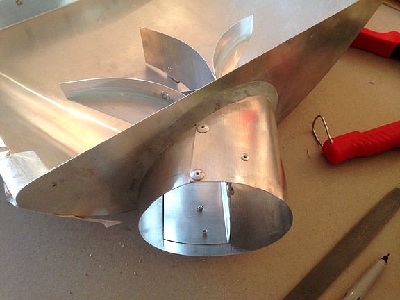

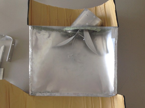

Bucket buildout
http://forums.pelicanparts.com/uploa...1512911474.JPG
Raw bucket. Bondo in bottom corners fills minor deformations that came with bending the metal into form. Deforms don’t matter since this is not a beauty contest and… bucket will be covered with insul. I wanted to check two bondo types to see if one was better so did it here. (Grey and red bodo perform the same as far I can tell.)

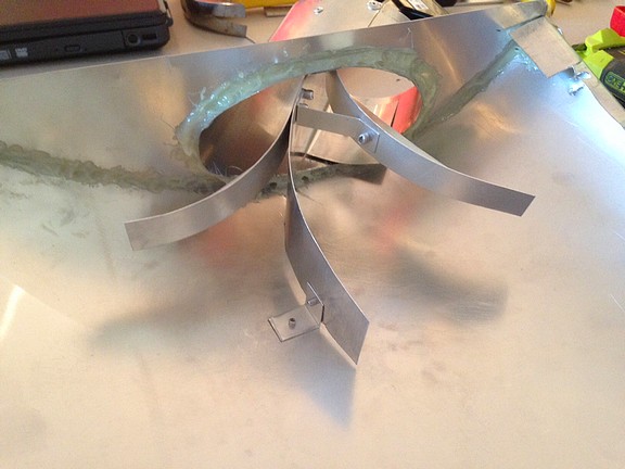

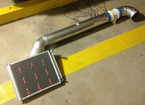

Air flow through condenser was tested (with bilge blower) early in project. Found were some areas getting much more air than others (as was expected given the pointing of the inlet.) To improve air spread, deflection to the top corners and towards the front was needed.

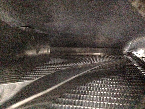

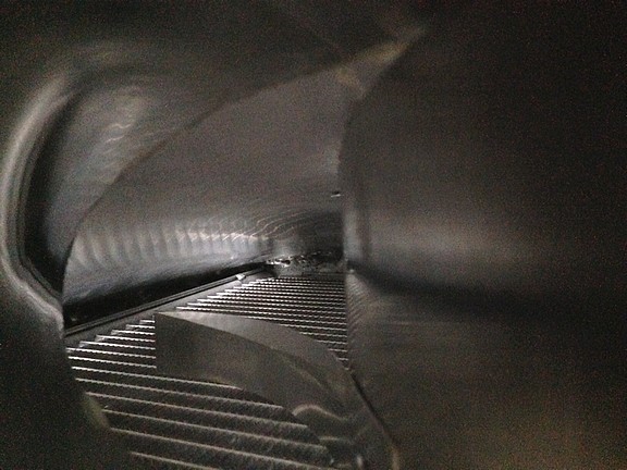

Checking inside to make sure deflector parts do not contact condenser’s surface. (Top pic looks at rear area. Bottom looks at front.)

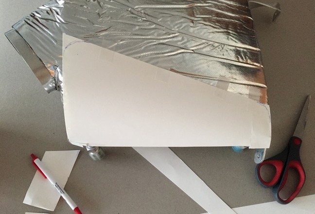

To keep bucket from heat-sponging, it gets insulated. Insulation is foil capped foam with peel & stick base. Am not using peel & stick to allow insul to be easily removed downstream if needed. Is attached at all ends with foil tape.

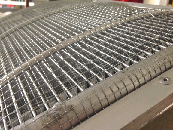

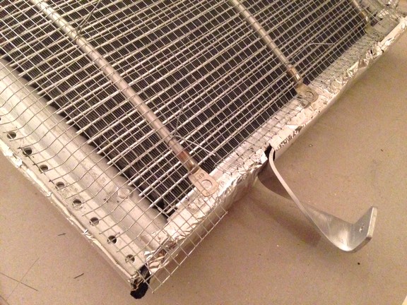

Screen was created (early during project) to protect condenser’s exposed fins. A foil mold was taken with the unit in the fender to determine what dimensions were tolerable.
http://forums.pelicanparts.com/uploa...1512912231.JPG
While installing screen... it looks heavy. Not in weight but in form. Am not liking this direction now. Knowing the condenser's area, a horizontal screen between the condenser and exhaust area seems a better solution. As I look at the screen sitting loosely on condenser, the question of whether to now do a fitting for a redesign comes to mind. Answer… not happening---gona move on with what’s in hand.
Trim holds screen in place.

http://forums.pelicanparts.com/uploa...1514317635.JPG
http://forums.pelicanparts.com/uploa...1514317297.JPG
Unit is OFF in this pic.
Based on my digging (like a rabid dog who's lost his bone) through options to move significant air with a small unit... don't believe brushless turbine can be beat. Problem is electronics required. I went down brushless path to see how that direction would pan out. It's far too complicated to sensibly deal with relative to getting air through a condenser.
Am NOT saying there's NO suitable 12v air mover out there for a ducted solution be it centrifugal or otherwise---am saying I didn't find it.
If you know of a compact 12v blower that can push 70 mph of air (as measured by an in-air-stream anemometer)... post it please---that would be a major find.
http://forums.pelicanparts.com/uploa...1514317954.JPG
2.75" O.D. housing brushless turbine currently in system. This is second test with anemometer held in vice.

Condenser's front guard
Guard was to be a flat plastic plate mounted ahead of condenser on a bracket. Plan changed due to angling condenser's ports (to better face hoses)... this created an interference with the planned guard. Decided to keep moving ahead and solve this puzzle later. Now is later.
http://forums.pelicanparts.com/uploa...1514895132.JPG
Insulation on bucket's leading edge... would surly get torn up due to debris abrasion.
0.02" aluminum sheet.
Putting bend in to wrap guard's leading edge around front of condenser.
http://forums.pelicanparts.com/uploa...1514896490.JPG
Backing plate is behind guard to keep rivets from cratering sheet metal.
Condenser's ready to install.
