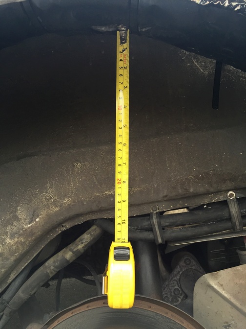

Discseven 02-02-2018 12:36 PM
http://forums.pelicanparts.com/uploa...1517608438.JPG
Starting reference... 11 1/16".
Adjustments... Channel for engine release cable has been pulled down slightly by crevice area. Duct area that fits into crevice has been wedged-formed more. Duct area just ahead of crevice has been squashed. Above is inside view of duct is looking away from intake end. 3" OD duct would now seem a better solution in terms of fitment above wheel. How air flow would react to narrower passageway is questionable. (Am staying with 4" OD.)
http://forums.pelicanparts.com/uploa...1517609635.JPG
13/16” raise accomplished. (Realize now I did not place tape measure in same position for second reference. Tape measure is in a more vertical position second time. Might make a 1/16" difference. So 3/4" riase.) Can raise more but need to lengthen duct so it can arch up further. Have extended as much as possible now by resetting existing couplings. Got maybe 1" more duct length. Would need to replace a coupling with longer version to get length needed. Will run this position and see what happens.
