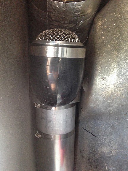

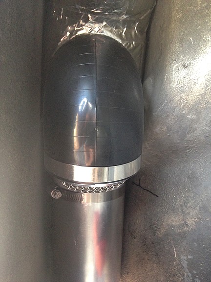

Discseven 09-05-2017 07:24 PM
http://forums.pelicanparts.com/uploa...1504667609.JPG
Stack's prepared---with Coastr's air-valve (TY Coastr)---to mount cradle-bracket and…
...air-valve’s intlet's up against tub. Quick solution = pointing inlet up or down…
= Debris catcher.
Points in same direction as main intake a few inches below. Doesn't make sense IMHO.
http://forums.pelicanparts.com/uploa...1504667609.jpg
Distance from inlet edge of valve’s tube to end of useable horizontal space = 6 ¼”. Short cobra fits. See: intakehoses.com. Not thrilled to wait for more parts now or pizz away $s overnighting.
http://forums.pelicanparts.com/uploa...1504668066.JPG
Adding short section of tube... can do right away. This moves 90 backwards putting inlet in area of inward flare of wheel well. (Can see inward flare in wheel pics above.) Will get cobra if this doesn't fly. Plan: get this and bracket done tomorrow.
