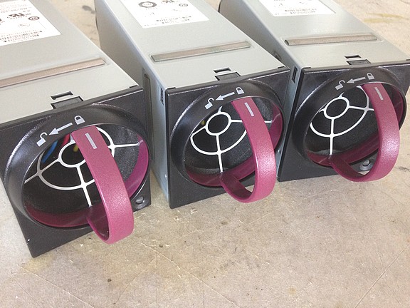

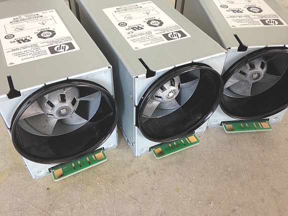

HP server cooling modules are received. One turbine (extracted from module) is heading to bucket-system as #2 unit. Purpose for #2 is to increase air volume delivery to bucket/condenser. Other two modules are spare parts in reserve. Reducer couplings & clamps are not in yet. (If you know news and my location... you know progress may experience slight delay.)
http://forums.pelicanparts.com/uploa...1504880715.jpg
Was going to run 16awg from ESC to single brushless motor. Addition of second motor ups amps to 30 vicinity over an estimated 10' cable length.

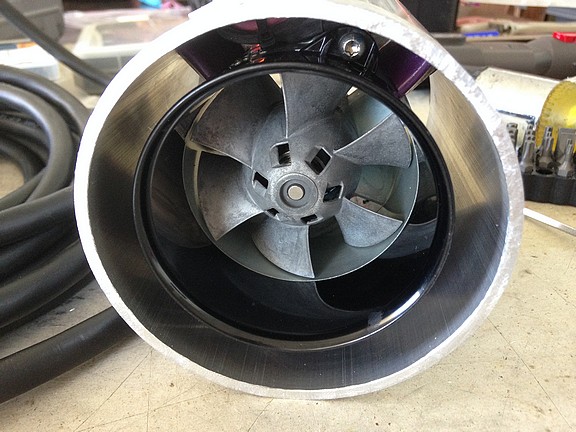

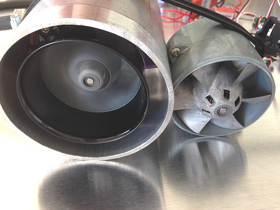

#2 Turbine Config in Duct
http://forums.pelicanparts.com/uploa...1505482949.JPG

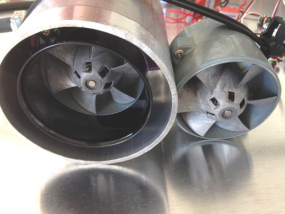

Burned motor next to “adjusted” replacement. Adjustment = cowlings, cowling fastener points, and footers are cut off casing. Is necessary in order to fit casing into rubber reducer couplings (being used to fit this turbine into duct line.)
#1 Turbine
Compared to mounting turbine inside 4” aluminum tubing---as was done with #1 unit---this is simpler approach. Reason for mounting turbine #1 inside aluminum tube on rubber fenders is to reduce turbine noise. Having bench-run system, seems minimal benefit from this config since noise comes out ends of system regardless of what envelops turbine. Noise control here seems primarily matter of running motor(s) at a chosen speed level.
Current thinking = position #2 connected to bucket. Slight turn in duct needed (as duct approaches bucket) may be possible to create with rubber couplings. Test fit in fender will answer if this is possible. If push comes to shove… inlet to bucket can be modified to make turn. Another option, position motors head-to-tail where #1 is currently positioned. Not inclined to this as result will surly be lower CFM at condenser.
Second ESC is ordered. When it comes, will assemble system and bench. Added hard duct and #2 turbine will eat up half the existing length CEET duct currently occupies. Point being to dump as much high friction duct as possible. How two inline turbines affect each other… unknown to be answered.

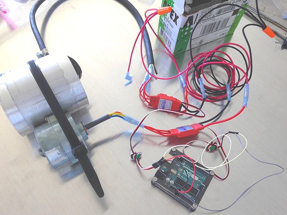

http://forums.pelicanparts.com/uploa...1505591000.JPG
16awg stranded 4-wire cable (suited to single ESC config) next to 16awg stranded 6-wire needed for dual-ESC config. Both cables are same 3/8” O.D. Am going heavy duty on this as it will run exterior as well as near engine. Not sure if center tunnel is way to run this through cabin or just lay it on floor board. Source = ProWireandCable.com . 3-wire cable needed for where 6-wire splits to serve each motor... believe HomeDepot has that.

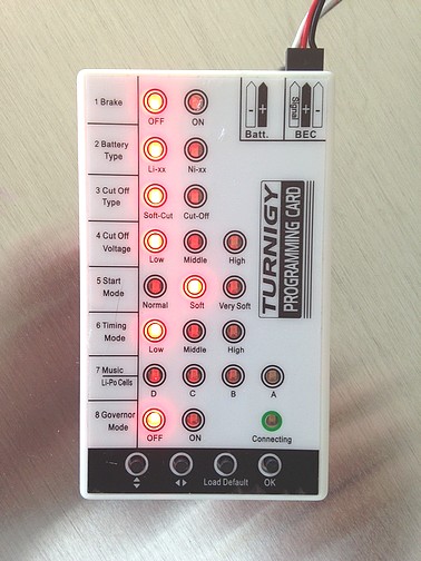

Making sure ESC #1 and #2 mode settings match. These settings are now applied to both ESCs. Looking at card, am wondering if "music" would be good to have turned ON. There are different tunes that ESC plays to signal status. Would be indication of ESCs working (or not.) Something to think about.
Testing two brushless motors now with dedicated speed controllers
Wiring is as last sketched/posted (minus 12v 40amp relay and AC circuit connection.) Power is supplied by 12v motorcycle batt. Will update sketch to include fuses Treme input and post later.
Power OFF.
Power ON. #1 is ramping up and #2… nothing… half second later #2 starts and ramps up without stuttering. 5v power for this test-run was served to Arduino (to turn Arduino ON) from ESC #1 only. Is that causing #2’s delay? Switched 5v power for Arduino to come from ESC #2 and… no difference in start up… #2 still delays half second. Disconnected #1 from system altogether and tested #2 alone. It ramps up as it should.
Ran start sequence few times and result is always the same.* Both motors seen above are at full speed---“full speed” for time being is at 80% of motor’s capacity. Faster than 80% and turbine-whine becomes a bit much as heard when benching units. In car… things may be different. (If not well secured… these quickly have a mind of their own. As HColes mentioned earlier, HP developed these turbines to deal with the greater heat their new blade servers were generating. Looking into this, I found that an HP executive was/is an RC enthusiast and it was he who introduced idea of Electric Ducted Fans (EDFs from RC jets) as a potential solution to company's blade server cooling needs. HP intentionally altered RC EDF design to their more robust solution. Result is brushless turbine being applied here.) HP units tested are "reconditioned" costing $9.99 each NI shipping. My take on "reconditioned" is there's no telling how many hours a given unit has run. Or, what reconditioning constitutes in terms of actually mechanically servicing a unit. Provided system installs in car as planned, and provided there's durability of blades given permanent 1/8" particle filter---Glen-filter (TY Glen)---installed... if there is blade durability, plan is to replace "reconditioned" units with new. New HP cooling modules are priced anywhere from $25 to $95 on eBay. Takes seconds to remove turbine unit from module. Then each unit must be "trimmed of certain appendages" to fit into system.
* Given consistency of #2's delay and correct operation of both motors following start... no concern with this scenario here. Beyond bench, have to ask how delay will work in assembled system with #2 few feet behind #1? Am not seeing any issue with this. If you do... pls say so.

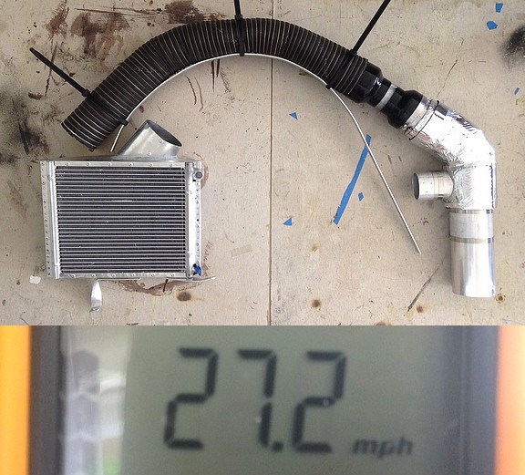

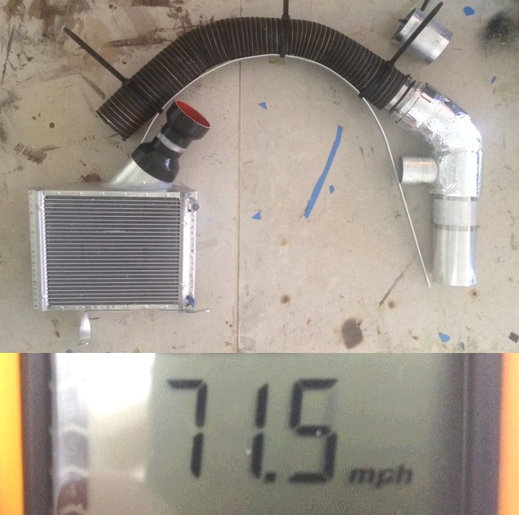

Air speed comparison at bucket inlet
Air speed into bucket is measured at end of duct, just before air enters bucket. Anemometer is positioned at center point of duct for each read. CEET duct here is not yet shortened as will be necessary provided turbine #2 is installed just ahead of bucket. Few inches of extra CEET for this test doesn’t matter. Unlike prior air speed test, CEET duct is bent for this test. Bend is not exactly as it will be in fender but close enough to simulate resistance generated from bend. Both motors are programmed to run at same speed. (Is possible to program Arduino so one motor runs faster/slower than other.)
When looking at results, should bear in mind each turbine is ducted differently. There’s a “house’d” version and “reduced coupler” version. Look back a few posts if you’re interested in differences.
http://forums.pelicanparts.com/uploa...1505762392.JPG
House’d turbine positioned just after intake stack. This config was previously air speed tested. Speed here is fairly close to test result done days ago with straight CEET duct and smooth bore metal duct. Slight speed loss here. Bend in CEET ductis likely cause. (22.0)
Not looking to split hairs where measuring air speed is concerned. What’s of interest is any significant delta.
House’d turbine followed head-to-tail by reduced coupler version. Combo is positioned just after intake stack. Would be difficult if not impossible to fit this config into fender (due to total straight length measure of combo unit.) Is possible to shorten head-to-tail total length but doesn’t matter given obvious inefficiency compared to other results. (25.0)
Reduced coupler turbine positioned just after intake stack. (27.2)
Reduced coupler is connected to end of CEET duct for this test (so exhaust side of coupler is "end of duct.")
Reduced coupler turbine positioned just before air-bucket. Triple checked this reading to make sure reading repeated. It did. (71.5) Went back to triple check result when this turbine is positioned just after intake stack. (27.2) Is correct.
EDIT: Is now day after these air speed tests were done. At moment this config---turbine just ahead of bucket---is preferred. Set this up again now to confirm air speed and reading was 50 mph. Having tested multiple times yesterday with same reading in 70 mph area... something's changed but cannot see what yet. Delta here is too much to ignore. Answer needs finding.
EDIT: Answer to air speed anomaly = multiple variables at play:
  1. Clock position at turbine's exhaust where meter is held... it matters in this case---With system in operating position (as if installed in car) and looking at exhaust side of turbine and 12 o'clock at top, highest speed (72 mph) reads at 4 o'clock. All other clock positions are lower and relatively even. Rotated turbine 180 degrees on duct... highest speed remains at 4 o'clock. Is is CEET duct and/or bend in CEET?
  2. Where meter is positioned at exhaust matters greatly. For this study, center of meter's impeller was aligned directly with exhaust areas of turbine. (This was also done for yesterday's test.) Because motor occupies center area of turbine, cannot position meter at center as is possible when measuring ducted air speed. Will comment on anomaly & findings status in new post.
Same as prior... Reduced coupler is connected to end of CEET duct for this test (so exhaust side of coupler is "end of duct.")
House’d version just after intake stack and reduced coupler version just before bucket. Another triple check. Reading confirms. (71.7)
What air speeds reveal:
  1. Bend in CEET reduces air speed slightly where house’d version exists ahead of it. Speed reduces dramatically where reduced coupler exists ahead of CEET (likely in combo with CEET’s interior wall friction.)
  2. House’d turbine version = very inefficient. My guess: exhaust air is returning to intake through gap* where fenders are.
  3. House’d turbine offers no added value when positioned ahead of reduced coupler.
  4. Reduced coupler turbine---when positioned just ahead of bucket---significantly outperforms house’d version.
  5. “Assisted gain” didn’t happen. Would it happen with both turbines wearing reduced couplings? Is this config worth creating? Is single reduced coupler turbine better by default than two of them---as in less-is-more?
  6. Updated CFM: 71 mph = 6,248 fpm X 0.0872 = 544 CFM. Does not account for duct’s interior friction (as noted by HColes.) Should be noted that CFM does not stand alone is regard to system's thermal performance. Air temp as delivered to bucket/condenser is also performance factor---the crucible of this journey.
    EDIT: Is day after these tests and original post. Set system up with reducer coupler turbine just ahead of bucket to confirm air speed. 70 mph (as read over three tests yesterday) is not duplicating today. 50 mph is today's air speed. Am looking for answer as to what has changed.
  7. Domino affect on hand. **
If you’re following details and see anything missing or off-base, your input would be appreciated.
* Gap between turbine housing and 4” duct. Is good example how benching reveals what minds-eye doesn’t see. In this case, am at fault in this design for thinking more of noise insulation and not enough about air flow. Also learned that mounting this EDF inside aluminum tube does little-to-nothing in terms of turbine noise reduction. This sort of ed nicely justifies exploring unknowns IMHO.
** Dominos
Increased speed does domino onto deflector, filter and air valve---none of these parts being designed with 70+ mph air flow in mind. Thin gauge deflector construct reads doable given added bracing. Filter (with 1/8” diameter hole & hole count in cone) provides more open area than does area of 4” duct itself. Increased friction at filter?…yes, is evident by air-valve opening. Air valve needs to be adjusted. Before making any refinements, must decide on final turbine config. Reduced coupler version positioned just before bucket offers best air for minimal hardware. Have to think if there’s ANY benefit to having two turbines before dumping 2nd unit. If you see this differently, pls say so.
Anemometer used.
