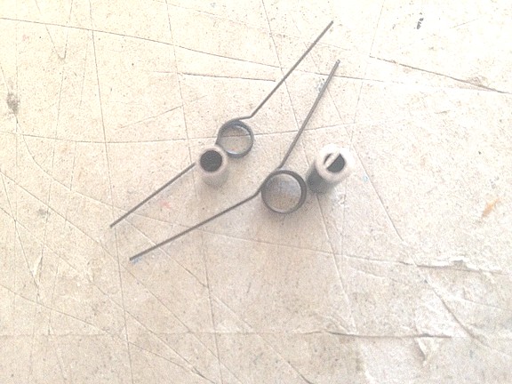

Went ahead with adjusting air valve's spring torsion. Existing set up used single 180 x 0.183 x 0.15 (4 coil) spring with horns bent in. That no longer works---valve's open without any main intake obstruction (given new, increased air speed.)
http://forums.pelicanparts.com/uploa...1505927307.JPG
0.015 wire diameter spring with mandrel compared to heavier 0.021 (with 5 coils.) Buying a variety of springs in one shot was good idea. Allows instantly playing around with different combinations.
System now needs 2 thicker wire springs (where it used to have one thinner.) Higher horn bend (top springs in pic) was too much. Lower springs have bend that works. (Bend is to pre-tension doors to keep them closed under normal op conditions.)
Where there were two rubber and two nylon spacers next to spring... there's now one of each next to 2 springs. Valve now opens as it did before with exception being it not opening as fully as thinner single spring set up. Is still enough air passage so turbine burning up from air-starvation is off menu. Change in system's sound when main intake is obstructed = distinct. Torsion spring source: Gardner Spring.
Playing around with springs and different ways to install doors... too much messing around with doors---I broke a hinge off. Hinge welds were done with 350dF media which can be reheated/reflowed. I did that to both doors (with them on pivot post.) My impression is 750 dF media does not reheat---it gets brittle. Am no expert with this stuff so don't quote me.

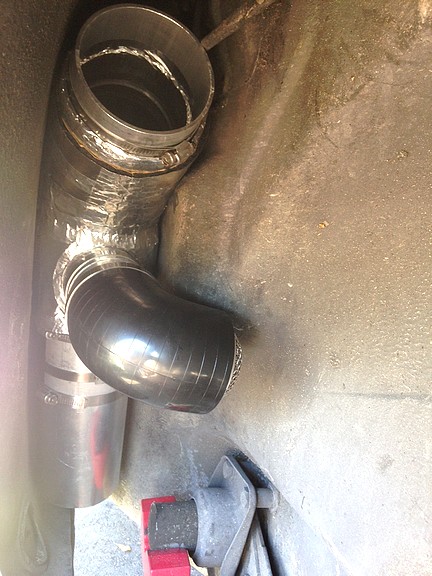

Stack installed. Extension added to Coastr’s air-valve allows 90 degree elbow to turn into wheel well’s set back. Intake’s tilted down for drainage. Would go with short cobra instead of elbow here if choice was made again. Reason = less complicated fitting.
http://forums.pelicanparts.com/uploa...1506358207.JPG
Clearance between air-valve and tub is controlled in part by rotation of stack in cradle. Can also move rubber elbow forward and back. Moving it back gets it closer to tire. Did not mount tire to confirm clearance today---am relying on measures taken a few days ago.

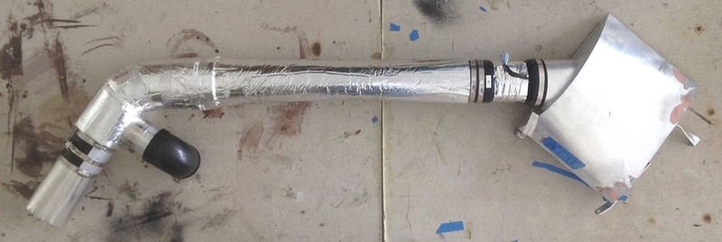

http://forums.pelicanparts.com/uploa...1506359453.JPG
Turbine’s new position = attached to air-bucket. Slight bend necessary (to compensate for air-bucket’s inlet pointing a touch too far towards outside of car) is managed by angling rubber couplers on turbine’s housing. Red wires are “testers” connected to ESC/Arduino/motorcycle 12v batt. (Is first time system is run in car.)
Extra CEET’s been trimmed. Installed length = 26.5”. Another 4” can be eliminated by placing aluminum duct where turbine used to be located (at end of intake stack.) Attempting to slip bare CEET ends onto receiving ends… PITA. Have mounted aluminum duct-sleeves to each end of CEET as “males.” Much easier making connections with this config.
iPhone “panorama” pic.
CEET has heavy duty coil laminated between interior and exterior duct material. Coil is rigid but will deform (and hold new form) given adequate force. Deformed section here is what wedges into crevice. Weggie is done to maximize clearance between CEET and tire below. Will insulate entire duct and bucket prevent air in route to condenser from absorbing engine heat.

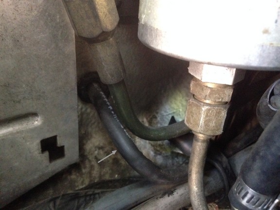

Entry to engine bay (just aft of fuel filter.)
http://forums.pelicanparts.com/uploa...1508166484.JPG

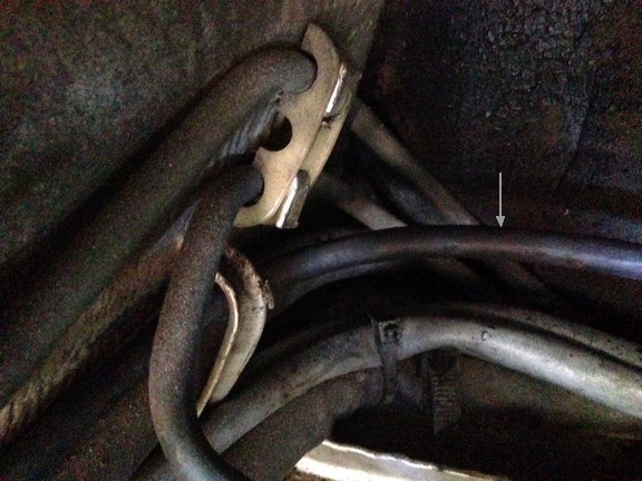

Run is forward along sill through collar... then along bulkhead...
Drop is on right side down through gap between suspension crossbow & bulkhead.
Tub ahead of right axle.
Using speedo port for passage through tub.

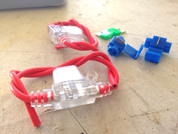

V.4 = final plan (maybe). 16awg is used throughout with exception of BEC between Arduino and ESC where 26awg exists (for 5v Arduino power, ground and signal. ESC has internal step down, 12v > 5v.)
http://forums.pelicanparts.com/uploa...1508255023.JPG
http://forums.pelicanparts.com/uploa...1508255023.jpg
Bundle = Arduino, ESC, 40a Relay. Will place somewhere below dash. 30a fuses and inline spices. Philmore 30-10320 Rnd Paddle Lever Toggle Switch, SPST 3A@250vAC, ON-OFF.

I would probably go with 10awg wire over 16awg for 30A, particularly if the run is from the battery up front instead of the alternator. 16awg is usually fused to a max of 7.5A, so a 30A fuse in there makes the wire effectively unfused. 10awg will cost/weigh a little bit more, but you won't need any "special" connectors.

Would like to think I have the fuse wrong rather than wire Treme---I'll go back and check specs. Hopefully I'm in the ballpark and a lower amp fuse will work. Input is much appreciated (as I'm an electrical-idiot.)
