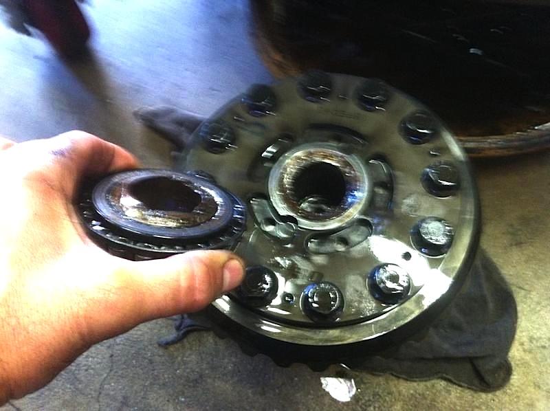

Anyone know a current source for a ZF LSD to fit a 915 gearbox (1973)? Any condition. Thanks.
I think the P/N is 901.332.053.13 but not positive.
Old 10-11-2017, 03:34 PM
Location: Portland Oregon
Posts: 7,007
The problem isn't acquiring the LSD, the real issue is getting the special LSD flanges needed for those coarse-spline units. Just unobtanium now.

Ahh, wasn't aware of that. So perhaps I should just put in an OSG unit? No axle/spline changes required? Only for normal road use.

This seems like a no-go scenario. I don't want to change the gearbox or do anything custom...just add the factory LSD option.

I have coarse splined ZF LSD in my 915 that is undergoing a complete rebuild at the moment, could replicate the flanges if they are in such a high demand?
I can make a drawing at least, just a bit of Solidworks.
'83 924 (2.6 16v Turbo, 530hp),'67 911 hot-rod /2.4S, '78 924 Carrera GT project (2.0 turbo 340 hp), '84 928 S 4.7 Euro (VEMS PnP, 332 HP), '90 944 S2 Cabriolet
http://www.facebook.com/vemsporsche
Old 10-18-2017, 09:46 PM
Posts: 7,007
Sadly, they are not high demand, however its a critical item for anyone needing coarse-splined LSD flanges as they are long NLA.
The key will be making good, relaible parts.

Just off of the top of my head, I expect the flanges are from forgings and the splines are broached.
I wouldn't consider barstock / "billet" equivalent to a forging for a part like this even if you find the same alloy.
It's not the kind of part you can get from just any machine shop, especially in small quantities.

For quite a while now a used early 915/914 lsd has been around $1500-2000. The flanges are generally $400-500 each. So $2300-3000. A Guard LSD which does NOT require flanges runs $2595. Unless flanges can be made for less than $400 each there's no point.

Just to add information for people, the LSD flanges are 61mm to the shoulder, versus 56mm. That's the sole difference

So we're talking coarse flanges with CV "cups" that are 4-bolt (the other two are roll pins) and 108mm diameter?
What if wicks decided to swap axles and install the 100mm axles? Of course he'd also need the associated transmission drive flanges and the stub axles. Only reason I say this is because the 100mm axles are quite plentiful used, as are the flanges and axles.

Well if he replaces the output flanges when he does the replacment diff, he doesn't need the coarse 100mm flanges? That said, I have two sets of the coarse 100mm flanges. I don't know if that means they're rare or common though. Just saying I personally have two.
One set came in the racecar as-bought, which started as a '79 SC but has an '84 915 transmission. Apparently the original '79 SC output flanges were transferred into the '84 trans with the billet LSD it has in it. I think it's one of the early GT billet diffs. The other pair are from a friend's '79 SC, coincidentally, that had a problem with the trans and he needed to replace it. His trans had an open diff. So now that I think about it, I should take a look at the two pair of flanges and see if they're the same dimensions, just to educate myself
