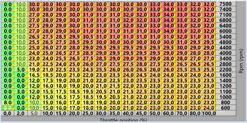

vanda 07-23-2021 01:49 AM
Hello guys,
I am a huge reader of this formum for a couple of years and the read fixed a lot of questions so far :)
I am running the following gear:
86 3.2 internals stock euro spec
taylor made 48mm ITBs
Alpha N engine control
EMU Black ECU
Equal lenght headers with stock heat exchangers
964 exhaust
after 2 years fighting all kinds of issues and different ECUs I am super happy with the result now. But one worry is somehow left:
My fuel tables look super lean, but the spark plugs and the Lambda say ist fine, even still a bit rich. All other tables look way richer...
Do I need to worry for some reason or did i miss something?
Happy for any response!

chrisbalich 07-23-2021 04:58 AM
Your axes being reversed what most of us run is playing games with my brain.
But if you can only go 20 cells in Y and 16 in X, I understand why you did it.

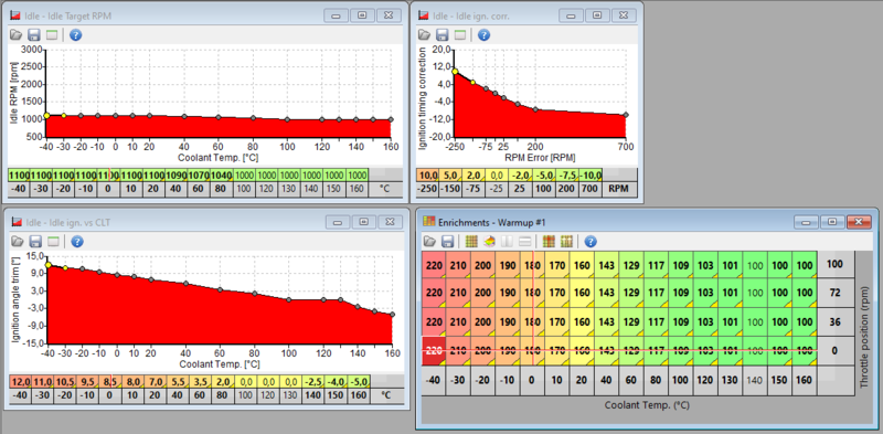

Ha! I have the same ECU! Wondering about your start up and warm up fueling... What do you use to control your idle?
vanda 08-12-2021 06:34 AM
Since I am running ITBs I don't run any mechanical helpers or motors.
I run a few correction tables for fuel and ignition which do a fabulous job. Idle is way better then before switching to ITBs. The correction tables below is what helps a lot
Idle Trgt: Target Idle in correlation with temp
Idle ign contol: any deviation from target idle will be corrected via advance
idle ign VS CLT: advances my ignition based on temp
warmup enrichment: just a bit more fuel based on temp
Those settings helped a lot for start up and idle.
Best!http://forums.pelicanparts.com/uploa...1628778801.PNG
