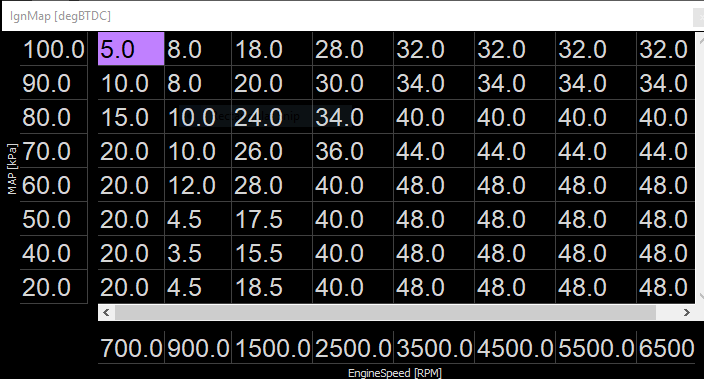

I've seen lots of ignition maps shared around different threads but thought it would be most helpful to have 1 thread to house the lot of them.
if you feel like contributing, please post your map and include motor specs (2.7L, 3.0L, 3.2L SS, 3.2L LS, CIS dome, RSR dome, etc....) and thanks for embracing the open-source mentality!
Disclaimer - no one besides yourself shall be responsible for engine damage from using a shared ignition map. Know well enough what you are doing/risking before you go and try someone else's ignition settings.
Below is my ignition map. Specs in the header of the image but i should mention its single plug too. Most of my light throttle cruising cells are paired with 14.7-15.0 AFR targets.
'83 Targa 300k w/ freshened 3.0 with 930/52 case# 6770540 ARP and Raceware hardware - AEM Infinity 506, Triumph T595 ITBs, B&B headers, Dynomax muff, Fidanza FW, Alum PP-203whp

@Pehlen - are you having much success with tuning based on MAP? is your VE table against MAP or throttle %? Just curious.

Fuel is against TPS, ignition against map. I had it on a dyno at the end of last year and the mix of approaches created some tuning hurdles. I’m also experiencing a bit of an odd minor power loss at constant throttle and RPM’s between ~4500 and 5200, and the most likely culprit at this time is the slightly flakey MAP readings.
Due to those two things, I’m going to switch over to TPS for ignition shortly.

@pfitz911 I know Clay from Closed Course Motorsports has an infinity on a 2.7 or a 2.8. Perhaps he would share.
I would think that they ignition timing would be pretty close to the 3.0 though.
Maybe the distro curve could be a starting point, but I think 35-38 at WOT might be too much but i really don't know.

I've done a little tweaking since the first post where I had included my ignition map. I got a little more aggressive up top. I also added headers since the first post. I'm not picking up any ping however I usually run 93 octane (m+r)/2.
