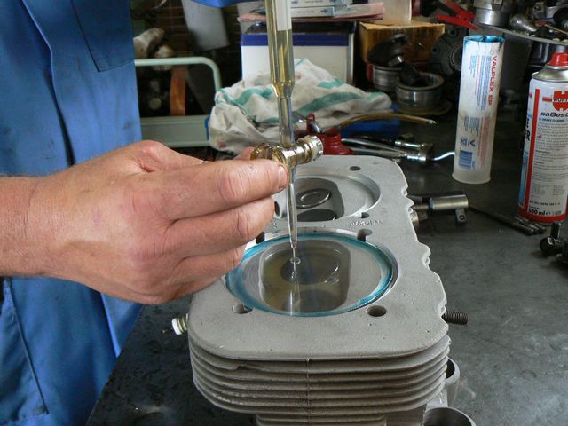

The chamber volume must be measured directly. Small changes in it can have pretty large changes in the ratio. This is usually done using fluid of some kind, most often by cutting a flat piece of plexiglass to fit the recess in the head, with a couple of holes (to fill through and to let air out).
Here's a random pic of someone doing this:
The compression ratio you want varies depending on a lot of factors. Relatively fixed things like the combustion chamber shape, and things you can change like the cam grind. In general, more aggressive cams need higher compression, and less aggressive cams need lower compression. If you go too high in compression, you can experience pinging which can actually destroy your engine if you let it go on long enough. You can mitigate that by using a higher-octane fuel, so that also has an effect.

I finally got around to measuring the combustion chamber volume and to compute the desired deck height for getting the compression to where I want it (8:1). I just would like to run these numbers by you guys to see if they make sense, primarily to make sure I didn't do something stupid.
My measured head chamber volume was between 53 and 55cc. Is this typical for a stock 1.8L head?
I put this into my calculator, and it appears that with a 2mm (0.08in = 5/64") deck height I should end up having a compression ratio between 7.9 and 8.1 (due to variation in chamber volume). Again, is this deck height typical? I am aiming for a CR of about 8:1.
I am waiting to get my new oversized bearings from the shop that align bored the case, so I can measure the actual deck height on my engine, without spacer rings, and to determine if I need extra spacer rings. The cylinders are 96mm bore, stroke is 66mm (stock from a 1.8L crankshaft). The engine is completely stock, with the exception that the P&C are the slightly larger bore (96mm versus 94mm).
If someone could just look over these measurements and calculations and tell me if they sound ballpark-right, it'd be helpful.

They do sound ballpark-right. But you should do what you can to make sure that the head volumes on all four cylinders measure the same. Uneven compression ratios mean uneven amounts of power mean uneven wear, which will lead to things getting out of tolerance sooner.
