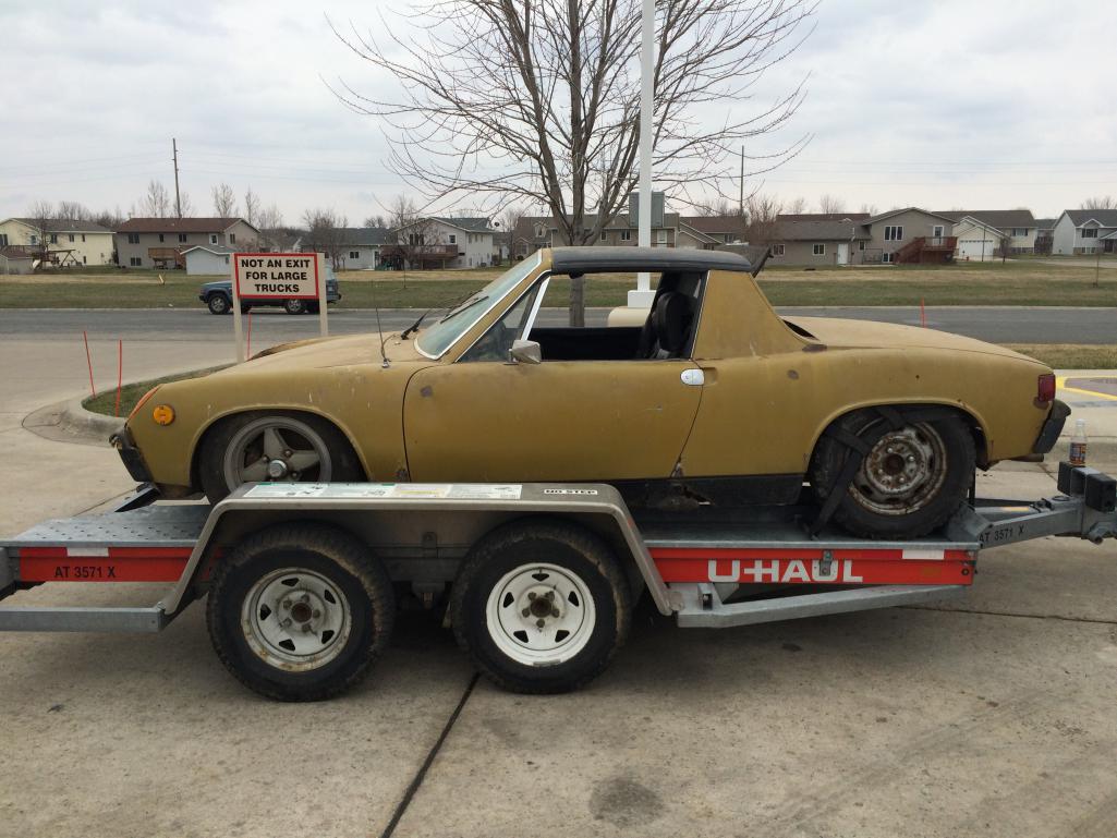

Hi everyone. I posted a while ago, but I am finally in full possession of my 71 914 and I want to start making a shopping list of what I will need for my car.
My car has been sitting for a long time, the most recent registration is from 1980, and I would not doubt if it has sat since then. The car did not have a battery, so I suppose I can start with that. The tray it sits on is kind of rotten, but not completely gone.
I'm sure the fuel has turned to varnish, so I would like to take the tank out and have it cleaned and inspected. The break pedal does not compress easily (at all) but the clutch has life in it.
Right now, I want to get it running and then work from there. I have a Haynes manual and I'm not afraid to get dirty, but I just don't know where to begin.
Any insight is appreciated.
Here are some pictures:

Congrats on your new toy! Get it running. oh boy!
your are lucky as aircooled engines age better than most as they sit. but the 914 chasis does not.
Drain the gas, remove the tank, and clean it out with lye. replace ALL of the fuel lines. get a new fuel pump and filter. if carbs, they need to be cleaned as well,maybe rebuilt. keep the 30 years of trash out of the engine. fuel injection? then new injectors at a minimum. Replace the points with electronic ignitor. new cap and wires. gas pedal assembly is likely rusted, maybe some PB blaster will free it, or maybe you need to rebuild it. Even if you get all the fuel system ready to go, DONT try to start the engine. You can really do some damage that can be avoided. change the oil, turn it over by hand, see if it has good compression, but I would adjust the valves as a minimum before trying to start it. if funds are not an issue, rebuild, or replace the engine. THats a LONG time to sit. All the seals are likely shot, water likely condensed in it each winter, and froze a valve or two. Rusted the rings? etc.
Once you decide to replace or rebuild the engine, and have cleaned out the fuel system. then you might replace the rusted brake rotors and pads, and maybe even Master cylinder. Getting the car going is great, stopping it is even better. Check all axle boots, likely rotted. change the tranny fluid. resurface the rusted flywheel, might as well replace the clutch too, throwout bearing and shims. lube up the wheel bearings.
And then of course, go over the entire car checking for rust. replacing rotten rubber, and generally giving the car all of your time and money
That shouldnt take more than a few hours of your time.
Welcome to the club!

I have to line up with jimbeaux911 on this one. Read everything about these cars and then prepare a comprehensive list of all of the things that will need attention and then approach them in a systematic way. Take your time and tackle one issue at a time.
Don't overlook assessing the chassis for rust. Get it up in the air and spend some time underneath with a good light and a pick or screw driver to probe/poke for hidden or disguised rust. That would be my first mission, were it my car. Once you know the extent of your rust, then you can prioritize the next mission.
For me that would be to assess the engine/transaxle and see if they spin freely. If not, the engine/transaxle comes out.
Then comes the complete fuel and brake system... you get the idea.
Good luck and have fun. Please remember to document thoroughly your car before you disassemble anything and then as it is disassembled so that when the time comes, you will have reference photos for reassembly.

My car has rust. Its a Minnesota car, but it has been stored in a barn since 1980, so it is not too bad. Unsightly, yes, but manageable and certainly drive-able.

caution, as rust can be hidden. I agree with Cairo, get it up in the air, and start probing. are the doors sagging at all?
If you want a set of cheap wheels to get it moving around your garage, find a set of old VW wheels. otherwise. put up a WTB ad here, and try to find something local.
FYI- i recently sold an engine to a guy who wanted to get his running after a long sleep. he got it running, and blew up the case when one of the valves froze up. Be careful! I dont know if Pelican sells engines, but AUto ATlanta sells rebuilt 1.7/1.8/2,0 engines. price isnt bad either.

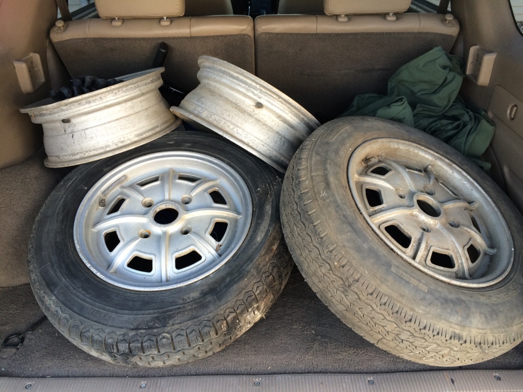

Old 04-03-2016, 02:59 PM

those are Mahle gasburners. Nice wheels! they will clean up nicely.

Those are Pedrini wheels. They should work pretty well on your 71; they were an option for it in fact. The Mahles look similar, but the ribs run on either side of the lug bolt holes. On yours, half the ribs run into the bolt holes--that shows they are the Pedrini wheels.
Any of the stock 914 wheels should work fine--steelies, those Pedrinis, the Mahles, and the Fuchs four-lug wheels. VW Bug wheels will physically fit, but will put the tire far out in the fender well and will significantly limit the width of tire that can fit. Usually 195s can fit in the back with stock wheels, but 165 seems to be close to the limit with the VW wheels.
There aren't very many aftermarket wheels made with the 914's 4x130mm bolt pattern; far fewer with the 914-friendly offsets. The American Racing wheel on the left-front of your car may be one such, though it was also made for Bugs with their offset. Ditto the popular Riviera wheels, those are available in both 914 and Bug offsets.

Can you recommend a tire size that will work with these wheels? I am getting some conflicting information and I want to be correct before I pull the trigger on some new tires.
From what I have read, these should work; but any recommendations are happily accepted. I'd rather not spend money on Chinese tires, but I don't seem to have a lot of options out there anymore.
Nankang CX668 High Performance Tire 165/80R15 87T

If you mean the Pedrini wheels you showed earlier, there are a number of decent 195/65-15 tires that should work. Though "should" means in this case "they don't always", because 914s tend to vary a little. They may rub on the fender lip on one side in the rear, because our fenders are tighter in the rear than the front and they also are usually a little asymmetrical. They will usually rub on the inner front fender when the steering wheel is turned full lock, but that only really happens at very slow speeds and is usually something people will put up with.
If you want something that looks more period-correct, the Vredestien Sprint Classic tires are available in 165/80-15, and from what I have read are decent all-around tires for that size. A more expensive but more period-correct tire would be the Michelin XWX (XZX?) available from Coker Tire.
The Nankangs are inexpensive, and they are the original size. I haven't heard much about them aside from that.
