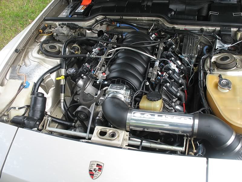

How about a chev G6? I think thats what this is.
Photobucket
Lowell

tnporsche: Oh that is a pretty picture Makes me want to get good at working on cars. Where is it from?
Maybe if I dig through all my old backup CDs I'll come across the e-bay listing I saved of a really nice looking 944. I wish I could remember the details of it.
