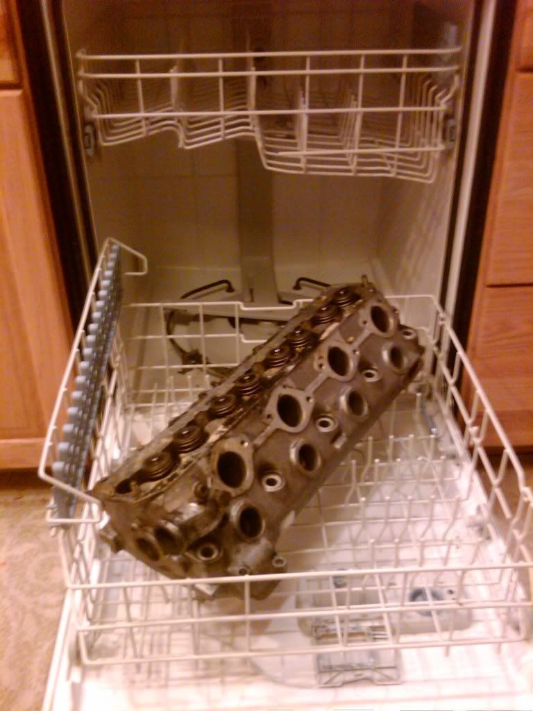

Posts: 142
Okay, Itll stay then.
I threw the head in the dishwasher last night and ran it for about three heavy cycles. It should be ready for duty now.
I also pulled the fan assembly and radiator out, just to give me more room for everything, and today I plan on ordering parts.

Old 12-02-2009, 08:56 AM
Posts: 101
I threw all my parts in the dishwasher as well (wife was gone )
It worked very well.
