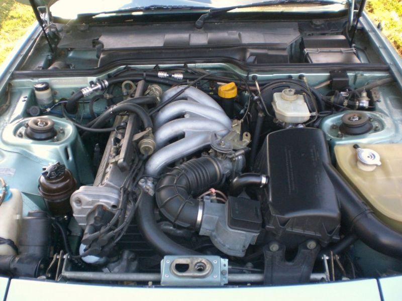

Early Rear air filter box bracket
Hello. Does anybody know if there is a difference between a early rear airbox bracket and a late model bracket? I cannot seem to get the bracket to line up correctly as it sits too low.
I removed a rather hokey cone filter the po installed and trying to put the stock filter back in. I am thinking I may have mixed and matched early and late model parts somehow.
Any help would be appreciated.
Thanks

I'm sending you pics of an 84 & 86 can't see any difference between both & I think but not sure they are all the same on the N/A from 83 to 89.Also sending you a pic of my "sold now 83-944 in case you change your mind & want to go the cone way. hope it help

Sorry ___ Tiramisu I goof on the second pic ,this one is an 84.

Thanks for all the pix. I messed around with it a bunch more with no luck. The airbox bottoms out on top of the alternator and the rear Bracket mounts are about an inch and a half lower. I can't adjust the height of the bracket as it's welded to the chassis.
The po raced the car and deleted the AC. I am wondering if the alternator was perhaps moved?

what kind of bracket? the AC delete brackets available put the alternator down lower, maybe they left the stock bracket on, with a shorter belt, but not short enough n had to move the alternator up higher on the factory pivot, to get the belt tight enough.

Here is a picture of the alternator I took a few days ago. The whole car is in pretty rough shape which is why I got it so cheap. The compressor is missing along with all of the belt turnbuckles. Is this the stock mount for the alternator?

Look closely at my cone filter pic you'll see the breather from the timing belts cover, rigth in the back of it there is a bracket, that is what is missing on your's the rear of your air box is connected to this bracket & I agree with you it is a mess you got a pinch hose & another one witch is almost worn rigth througt that will have to be replace. I really think you should go the cone filter way with this it will be less work & there'll be more space if you want to work that side of the motor,don't get discourage do a little bite a the time it's not that bad the motor seem to be clean at least it's not cover with oil ,clean all the hoses & connector before you reinstall.I will also take the front timing belt cover off & clean the inside it must be full of gunk to. If your not up to frabricate your own cone filter brakets there are not that expensive & usualy very easy to install, also make sure your AFS is in good shape before installing keep use post as you go.

cauzomb was right. The PO just left the stock bracket on and got a longer belt and its maxxed out. The tensioner was missing as well. I bought a real AC delete bracket with belt on ebay along with a tensioner which should solve the airbox mounting issue. Thanks for everybodys help on this.
