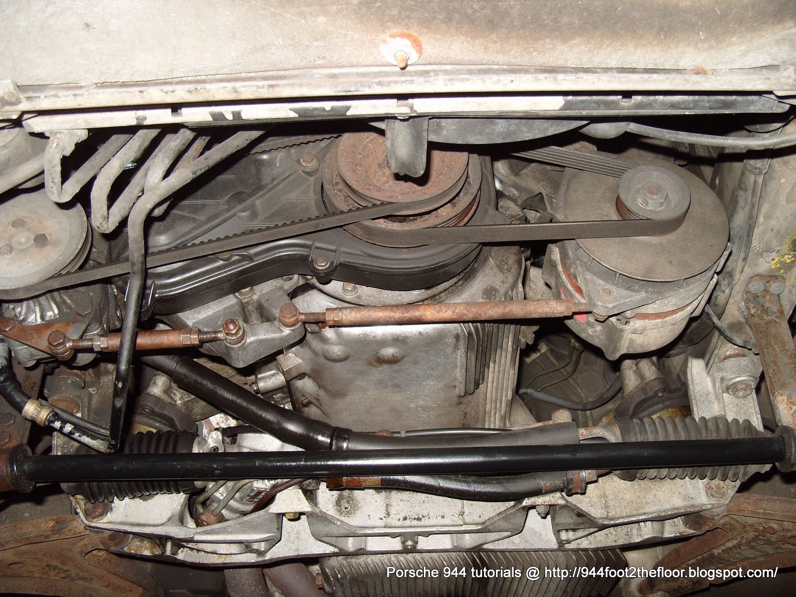

When I make a quick right turn, or a hard right turn, I hear a knocking noise. It sounds like a sway bar bushing, but it isn't. I noticed my AC compressor is actually sitting on top of my sway bar when I looked under it. It looks like it could be the problem and seems like it is the general location the sound is coming from. Is this normal?? Everything is tight, I can't figure it out

is your car lowered?
it sounds like your AC compressor is too low, or the sway bar is too high. can you get a picture of this to post?

http://1.bp.blogspot.com/_LvxjhxOrHgc/TDcfIzyYvBI/AAAAAAAAAPk/_Zc5h1HCdXI/s1600/S1050195+%5B50%25%5D.JPG

I do not. Mine is a 951 though, looks a little different from that pic. My compressor has two lobs on it, one which the tensioner connects to and the other has nothing connected to it. This is the one that is touching the sway bar.

ya know, that picture doesn't look right. i think that is actually the alternator. let me try again with the pictures.

sorry, i cannot find another, better picture. but yeah, i think this car has the alternator in the AC position and a shorter ribbed belt.

Here's my pics. The lobe of the AC is actually resting on the sway bar. SOrt of bad pics because I didn't have time to put it on the lift but you get the picture....My dad seems to think the belt is too big/stretched and it needs replaced and tightened.

are you sure that compressor is attached at the mounting point? that definitely looks wrong to me. the belt tensioner is much more horizontal on my 951.

Was wondering the same ,there is definitely something that doesn't jive here seem to be lower in the rear then in the front.this is my 968 but your should be the same, has you will notice there is quiet a bit of clearence dind't measure but at least 2" between the rear lob & the sway bar & this is an m030 bar.

Sorry got it wrong the pic was taken with the car jack -up hence so much clearance ,when sitting they should be be approx 3/8" to ½" from the front of the rear lob to the sway bar,your's should be a little bit more unless you got the m030 SB on it.

Either the ear broke off the rear of the compressor, or the bolt backed out and is gone. There are two different compressors pictured above, the early cars have a 6E171, the later cars have a 10P15E. Both are Nippondenso compressors.
