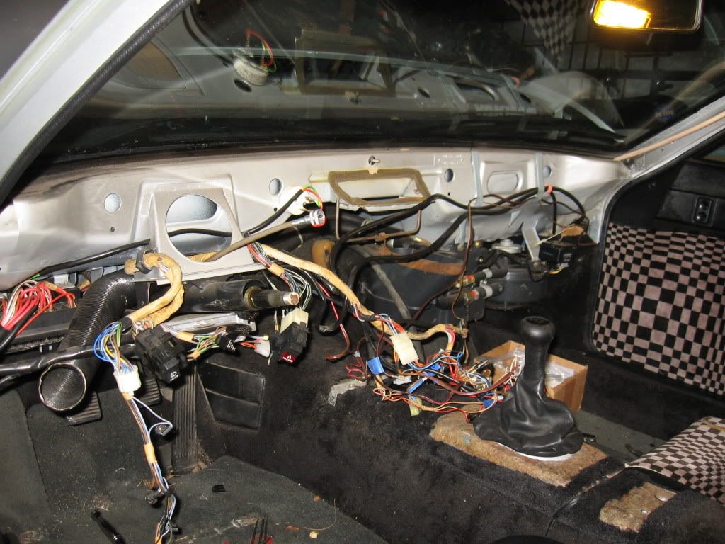

Nothing to worry about, look how simple:

i think my main issue is that my 944 is my daily driver... so i need it to get back and forth to school and dont know if i... scratch that i forgot i have a parts car !!! good idea guys. ill take the dash outta my parts car, send it to get it re-covered, and on a weekend do a swap.

See how easy it is.......no worst tear down than any normal A/C annual

To replace a dash sounds horrible and very complicated big work, but they are not that bad. I have done several and now can do them in 4 to 5 hours start to finish.
Go to Clark's Garage Home Page in the Garage Manual look up dash replace. See Body - 24, Dash Replacement.
Clark's gives a full disassemble and re-assembly that's easy to follow...

IMO it was more work to remove the center console than the dash. Easy project, just take good notes, or better yet, pictures on where the wiring goes. The plastic covers aren't bad for a quick cheap fix, but they will warp over time.

Plastic Dash Caps are the pitts if you live where it gets HOT in the summer. It will warp and buckle like crazy if you don't remove all the old loose dash pieces and it will still pull the loose stuff up. I know how it looks so I don't need anyone else's comments on my dash. If they make a comment just tell them to cough up the money and you'll be more than happy to buy a new one with their money. I have a Suede type cover on now and I can live with that until I want to spend the $300-$500 for a leather one I can install myself. Just follow Clark's Garage.com for Dash Removal, bag and tag everything as you take stuff apart. Be Super Careful with the plastic trim as it is brittle and breaks easy. The Center Console is only held on with like 6 -8 screws.
