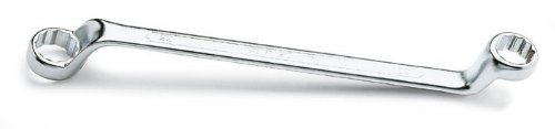

It's actually easier and safer without a spring compressor. There are lots of tutorials on how to do the strut change, so Google is your friend. You will NEED a rattle gun to remove the upper strut mount nut. It's a locking nut, so one use only.
A deep offset wrench will also work...

BTDT. From Vice-Grips on the strut itself to stop it rotating, to deep offset box-end wrenches like the one pictured, I've tried plenty of different ways not only to get that top nut off but also to torque it down properly. In the end, the rattle gun made life so much easier. And faster.

The vice grip method will loosen up every time, the strut rod metal is too hard to grip so you won't be able to get the nut tight enough. It takes two wrenches to tighten it enough if doing it with hand tools, one on the nut and one on the strut rod top hex or allen. So if you don't have a rattle gun you can get an offset wrench for $10 on Amazon and have piece of mind.
