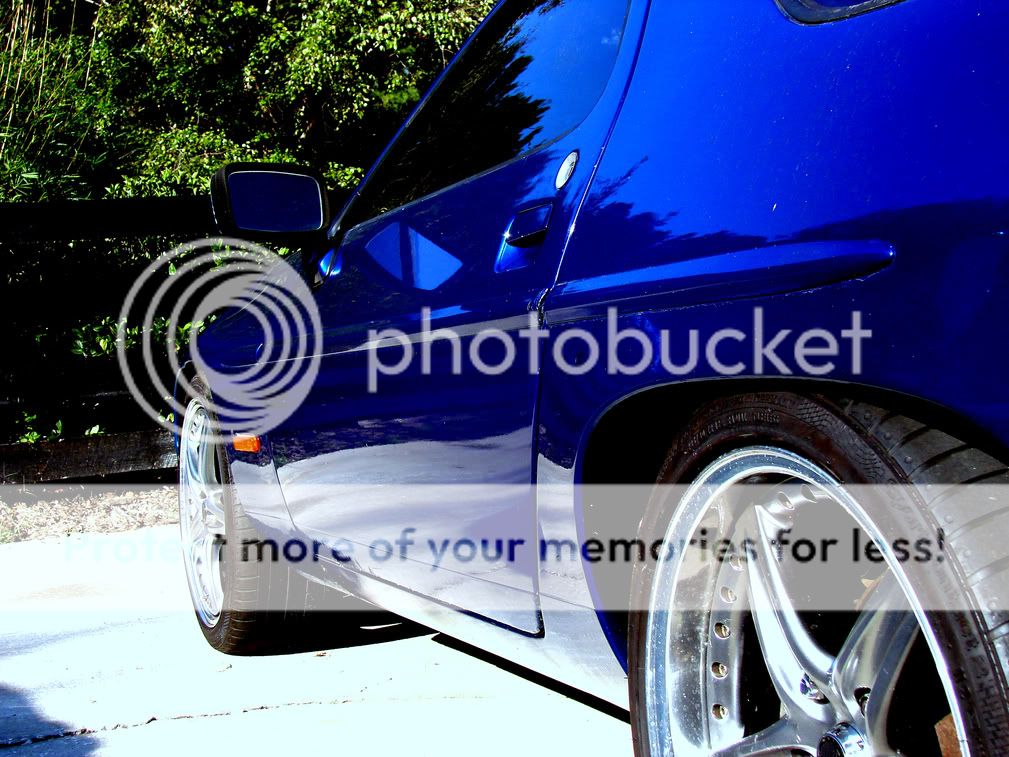

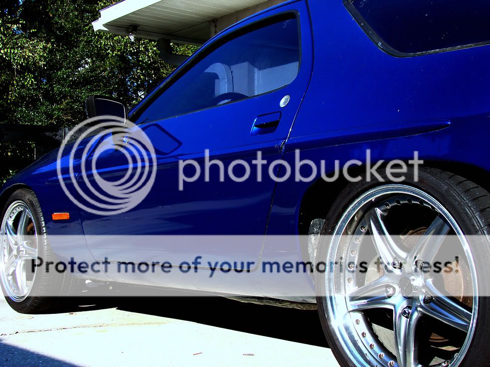

Your car looks great what color is it??
For your problem,what was the last thing you fixed??
i dont know what color it is. i do know that it isnt the original paint color though. at night time its purple until you shine a light on it, then it turns dark blue. and i dont know what the last thing was that was touched. i just got it back from this chevy guy my dad took the car too and now it does this... any ideas? fuel mixture? fuel pump/pressure? anything?

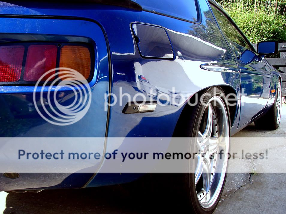

EIP!
DAMN! That car is too cool! I love the color and the wheels! And that is by FAR the best way that I have ever seen to handle the "federalization" holes for the US-required side marker lights! What are those side marker lights, and where did you get them?

Originally Posted by Normy View Post
EIP!
N!
you mean the ones on the rear? i can get a part number off of them if you would like.
