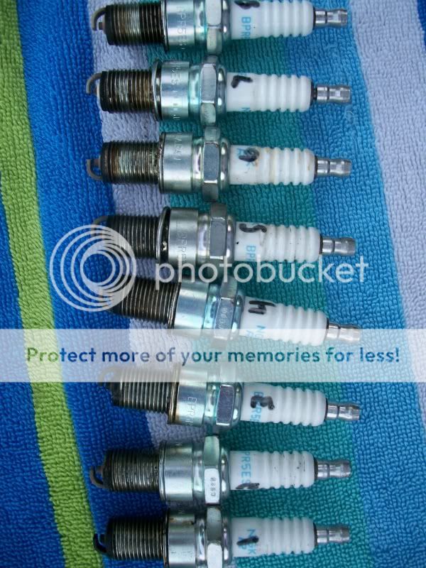

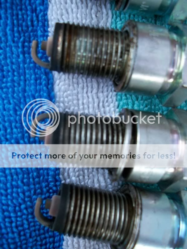

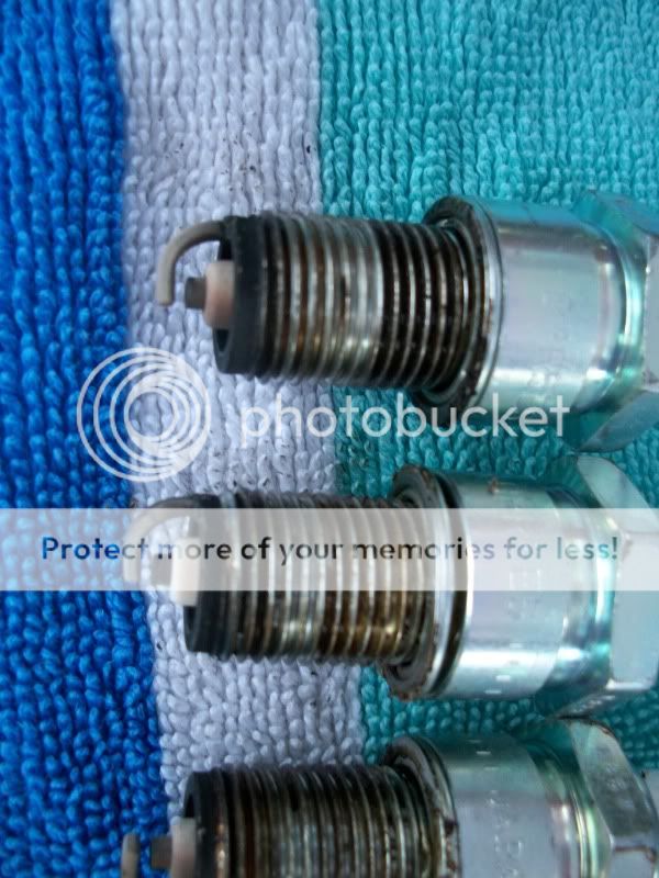

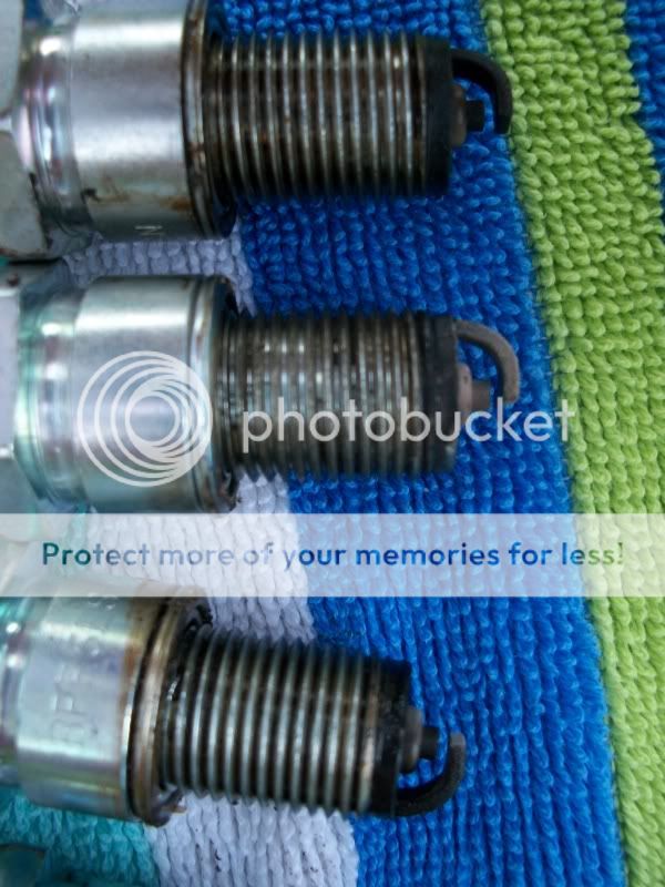

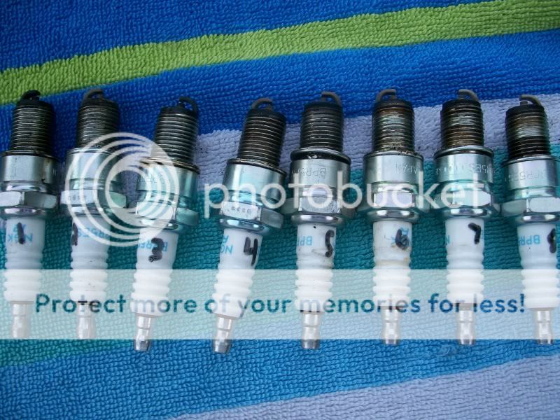

okay, so i changed the spark plugs today and here is what i found:
do those white looking ones mean iam running lean?
1982 928S euro M28/11
That criminal under the hood is a really bad influence on me: "hey...what about another 1000 rpm? And you know, we're doing 75...but I can go 100 and you'll hear my beautiful voice a lot better! Lets go baby..."
dammit! I'm such a slut~ N! -Normy
Old 04-06-2011, 05:02 PM
Moderator
MPDano's Avatar
Location: Sunny San Diego
Posts: 9,025
They look good to me except #1 & 3. Maybe a leaking Injector causing a rich condition. Doesn't look like oil so seals and rings would be fine.

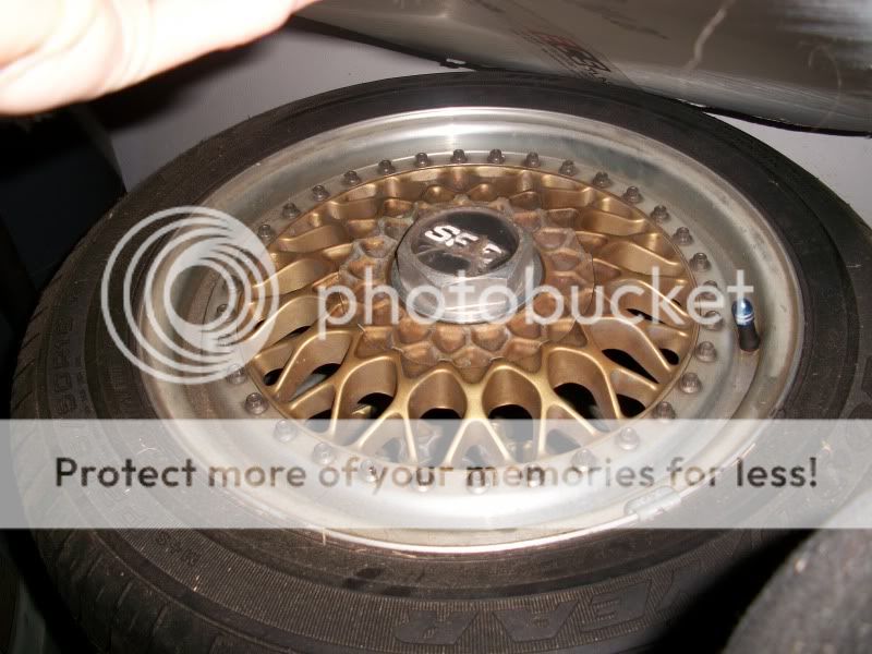

I have basically the same car and problem as you. Mine is running like poo also. No power under load but when it gets going I can rev it way up(tach not working) as long as I'm not going up a hill. I am getting no alternator power even though I have a new alternator and battery. I have been through the whole pod and gauges(checked bulb at voltage gauge) and the issue still persists so now I think I'll go after the" bad blue wire from alt to 14 pin" theory. I see that yours is charging good. When mine gets the revs up it makes a rapid staccato popping from the exhaust and kicks in like a turbo. I think this shows me how it's supposed to run when all is well. Mine also drinks the gas like a tank. 10MPG but I think it will get better when I get it running right. Gunar
82 928 Euro S 5 speed, sport seats,Moss Green/Champagne 04 996 C4S conv tip Polar Silver/Metropol blue
Old 04-06-2011, 07:47 PM
EIPtuningR32's Avatar
Location: Gainesville, Fl
Posts: 620
Send a message via AIM to EIPtuningR32
haha, i wouldn't use mine as a benchmark. its a heap of junk. the only reason why i am not selling it and buying a good one is because i am a hard headed fool who wants to set things right on my own. the interior is HORRID. Nothing, and i mean nothing, electrical works on the car, except the brake lights and turn signals. anyone know of someone that can COMPLETELY rewire a 928 or has in the past that could lend me a hand?
anyways. i have those same wheels... whats the story behind these things? how much are they worth?
