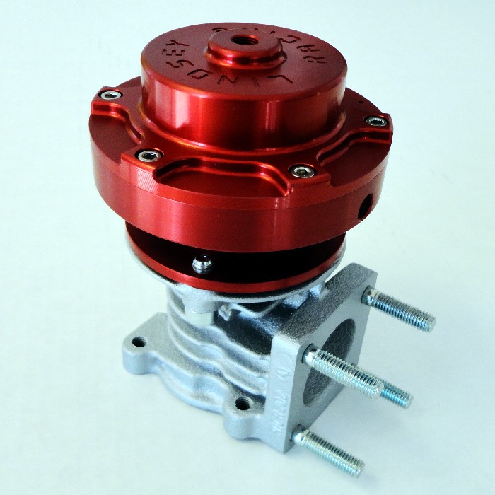

So after doing the characterization of the stock WG and it's control, next was to to do a dual port with a 4 way solenoid control valve.
I have a Tial I am playing with but decided to see if a stock WG could be modified to become a 2 port WG. Much easier to install and no modification/fabrication to the exhaust system.
Short answer is not really....
First I welded the 4 vent holes in the stock WG. Then I put a crush washer to prevent leaks from the top chamber when it is reverse pressurized. Finally I put a 1/8 inch npt 18 barb into the side to introduce air into the bottom part of the WG to hold it closed against the exhaust pressure.
See pics.
The copper crush washer did not work, it leaked as it was not large enough.
Th aluminum crush washer worked to seal the chamber, and it held pressure in both chambers.
Barb installed, notice the welds for the vent holes.
So here is the problem, the piston that moves up and down inside the the WG,s body runs flush with the walls. So any protrusion into the chamber, like the threaded end of the barb interferes with the motion of the piston.
It may be possible to install a smaller barb into one of the vent holes, but did not look very feasible.
So chalk it up to a learning experience.

sox; it looks like you have a tial wg sitting on your bench, but you're trying to frankenstein the stock wg? why don't you just use the tial!?!?
also, don't feel bad about failing to frankenstein the stock wg into a dual-port, many have already tried and failed, which is why the tial wg is the solution.
lindsey has a successful halfway-stock dual-port conversion but it costs almost as much as a tial:
