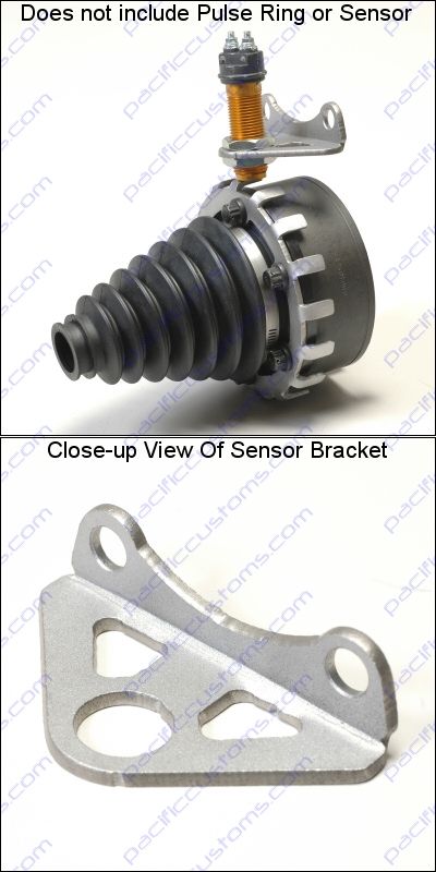

ONQRACIng - You're sort of inline with what i had in mind. Something like this:
From pacific customs. Do you have a link to the sensor/pickup you purchased?

My Pista came with all the need base sensors. Temp and speed were in the box.
Same idea, minus the chopper wheel on the shaft, that is like a crank sensor. Ours will run only one magnet, and the speed setup will do the math from wheel Diameter, to when it see the magnet.
here is where I saw the sensor we have.
https://www.pegasusautoracing.com/bigpicture.asp?RecID=5456
Andrew

The way ONQRacing describes is exactly how I have mine mounted. On the inboard cv joint on the driver's side.

Great info. Is just what i imagined, though i was overthinking that i had to use something like the pulse wheel pictured.
Just so im clear: 1 magnet, 1 "pulse" per revolution, and use the software included to calibrate the reading based on the tire diameter.
Got it!

I welded a little tab to the cv keeper and mounted a magnet, and made a bracket that mounts on the diff cover for the sensor, 1 pulse/wheel rev. works well enough for speed...somewhere I have a pick from underneath the car showing the set up installed, cant locate it now though
You need to know the rolling diameter, not the overall diameter of the wheel for better accuracy.
Keeper with magnet:
You don't need to use the cage type pulse ring. You can mount a sensor and orient it such that the heads of the cv bolts are triggers (in some case 6 pulse/rev). If you have 4 bolt cvs you need to come up with a different solution
