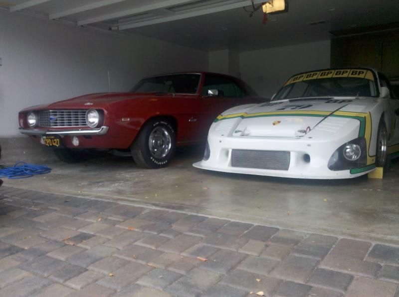

VZ935's Avatar
Join Date: Apr 2005
Location: Burlingame , CA
Posts: 2,607
Vintage muscle is a 1969 Camaro that left the factory with a 427 cu inch motor and M22 "rock crusher" gear box.
The car sitting next to it is a 78 935 with 3.00 liter flat fan motor with upside down box and titanium axles.
Same car with the ex Loos and Akin 930 770 0911 at Daytona. I don't own the black 935 anymore
Restored this one with the help of Hayden and the guys at WEVO and Brumos.
It is a 1976 934 coverted to a full 935 in 1980 by Chuck Gaa of GAACO. 3.2 twin turbo, flat fan with kugelfisher mech inj. , upside down box with ti axles.
A bunch of old race cars
