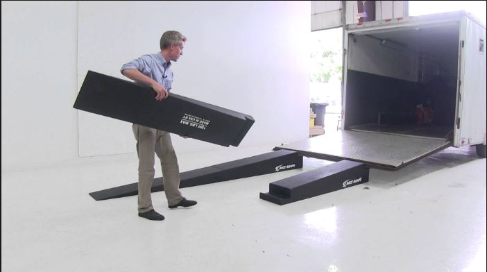

Some guys just carry around some lumber to drive the rear wheels of the truck up on.
Raceramps make some very nice lt wt ramps that can extend the stock trailer ramps
ramp headaches are usually the result of a low ride height+the configuration of the front spoiler
some guys use a quickly detachable front end
I need to use 3.5" Raceramp extensions

[QUOTE=KTL;9389039]I inherited wood ramps (2x12 stacked and staggered along their length) with the 16' Anderson beaver tail steel partial deck trailer that was part of a package deal I got with my racecar purchase. Didn't take long for me to get sick of futzing with the wood ramps each time I had to load/unload the car. Plus the friends at the track kept joking with me about burning my ramps for campfire firewood when I wasn't looking. So I did what Bill shows on the blue car's front bumper and made mine semi-quick release-able with some latches and springs."
-I can clear as I drive up but as the front comes up onto the flat part of the trailer the car's pan would bottom out.
I purchased some race ramps from Jegs and got a great deal on the 11' ramps with 11" rise.

My new trailer shows up in about a week and I suspect I'm going to need ramp extensions. Looks like many people are choosing the RaceRamp solution as opposed to attaching extended ramps to the trailer door. Why? Price is similar and at least in my thinking the attached ramps are one less thing to hassle with when loading and unloading. Am I missing an advantage of the RaceRamps?
Something like this:
