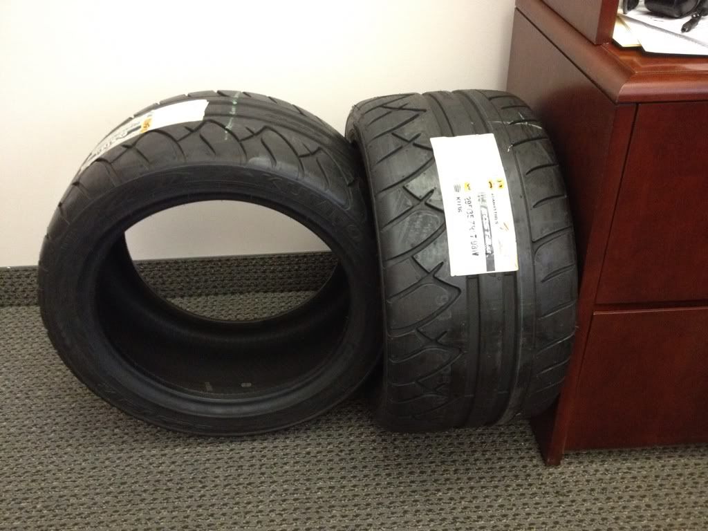

So I am going with 17x10 rears with 295/35R17 tires.
Front are 17x9 with 275/40R17's.

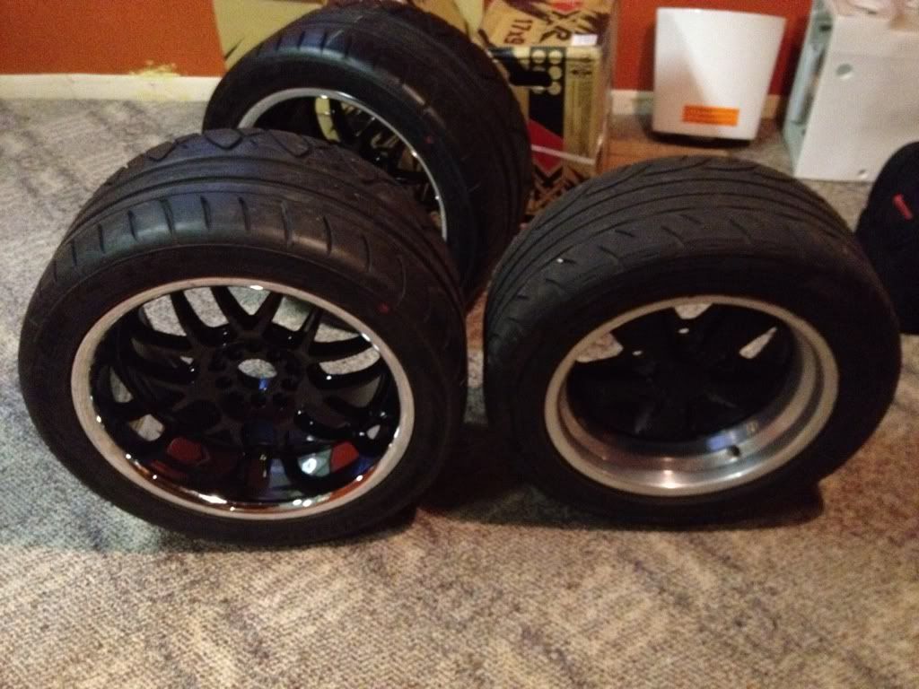

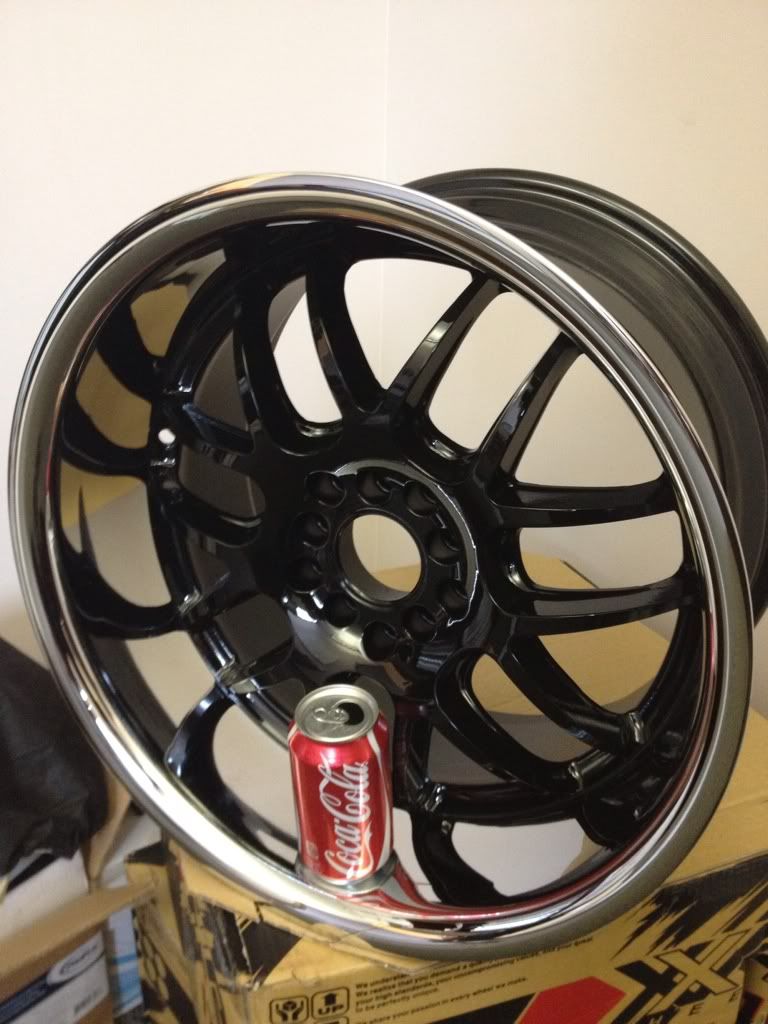

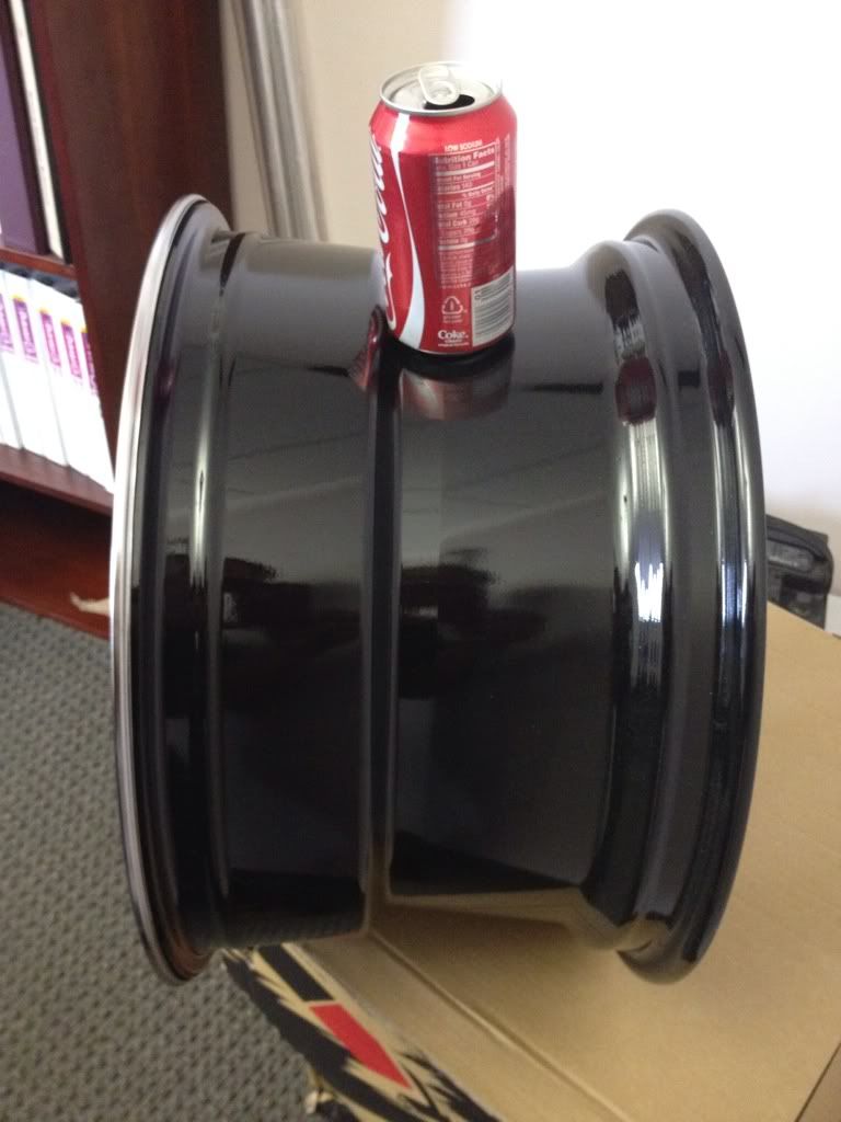

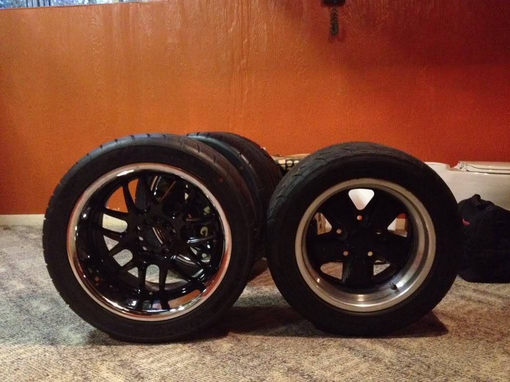

I just got my new rims.
These are what I went with, I am planning 295/40's on them

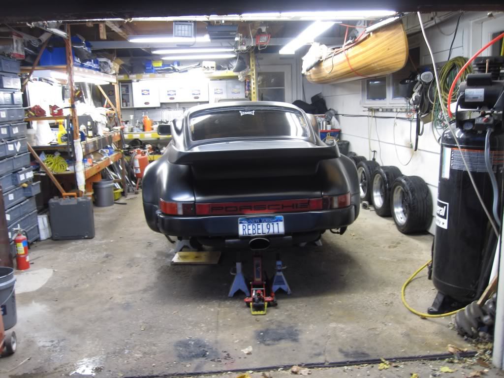

Rebel911 01-02-2012 02:28 PM
Just posting some pictures to bring this up to date. These are posts from my local site:
here are a few pics of the "test fit" of the rears I will post up some of the fronts tomorrow. I already started work on the rear.
http://i690.photobucket.com/albums/v...5/e50d3495.jpg
http://i690.photobucket.com/albums/v...5/ec88584c.jpg

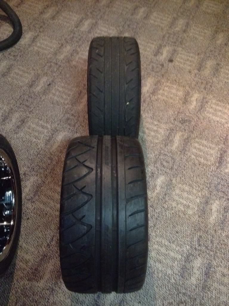

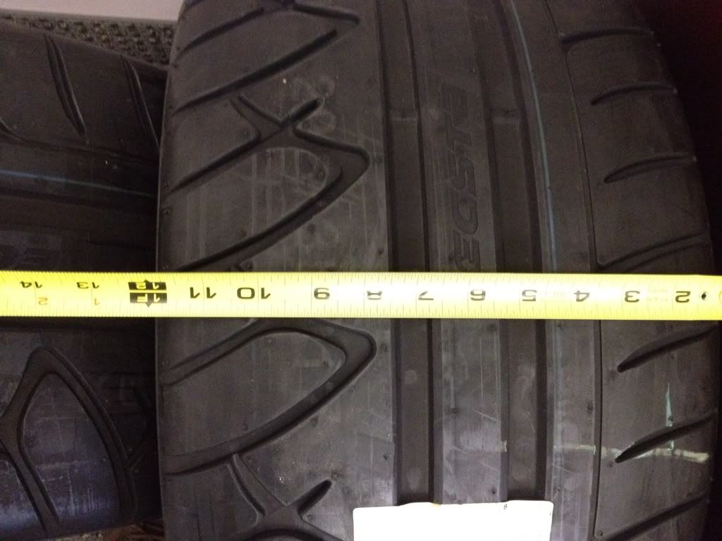

here is the difference in the front tires old to new... not that much :lol:
http://i690.photobucket.com/albums/v...5/a3893d9b.jpg
http://i690.photobucket.com/albums/v...5/c73a2b83.jpg
Got the fronts on... they stick out some. I wonder what the handling affect will be with the new tires? kinda excited to drive it.
again going from original equipment of 195 to 285 makes a big difference.
The weight difference is ~38 pounds per rim/tire per side on the fronts. I will have to wait and see for the backs when I can pull them.
feel free to give me input but know the car is very far from done as of today. please note the side skirts are not on the car.
http://i690.photobucket.com/albums/v...5/9589efab.jpg
http://i690.photobucket.com/albums/v...5/7d10c653.jpg
http://i690.photobucket.com/albums/v...5/22cbb804.jpg
http://i690.photobucket.com/albums/v...5/6d166f81.jpg
I've been in the lab almost every day. This is the smaller of the two bays, easier to heat.
http://i690.photobucket.com/albums/v...5/GOPR0156.jpg
http://i690.photobucket.com/albums/v...5/GOPR0169.jpg
A lot left to do. Very excited.
