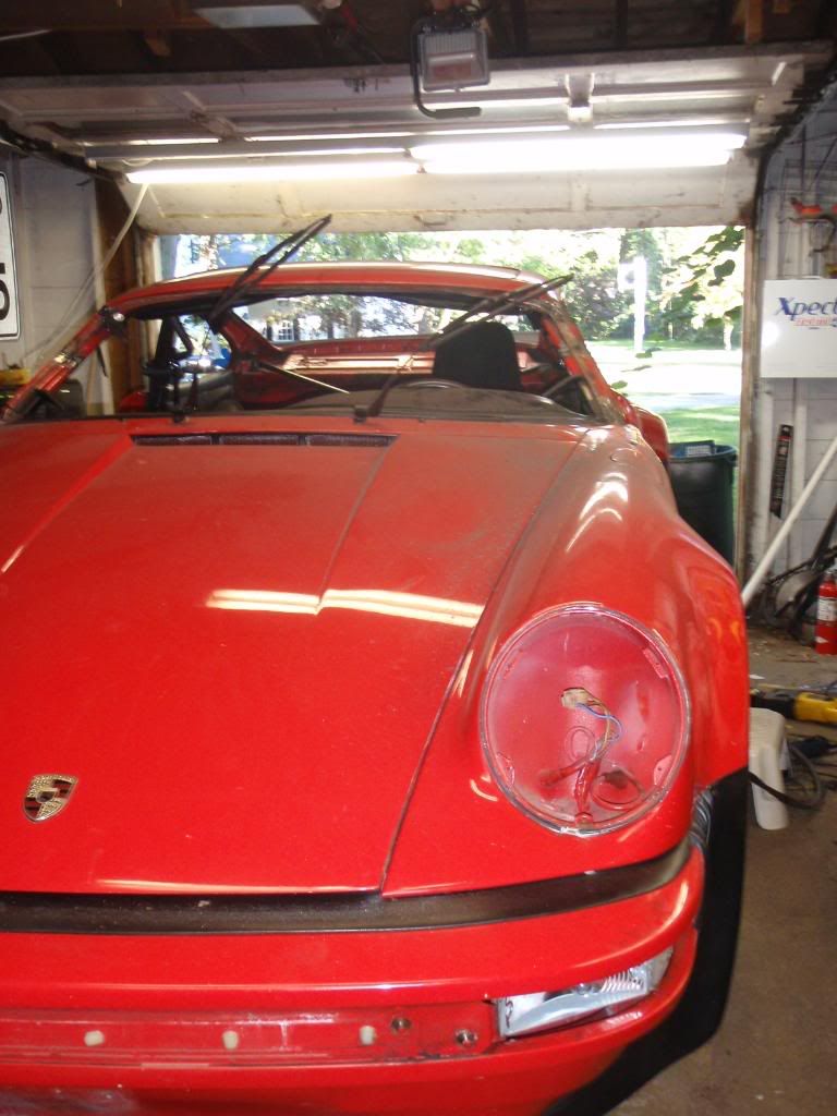

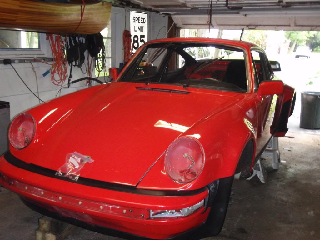

dad911 11-06-2009 01:28 PM
Not my cup of tea.... but I think the lines would flow better now with slantnose or strosek fenders.
http://993c4s.com/wp-content/uploads...sche-front.jpg
http://upload.wikimedia.org/wikipedi...ose_1982_1.jpg
Rebel911 11-07-2009 03:32 PM
Good idea, I just purchased strosek fenders. Hope to have them by Friday. This will cut a lot of weight also.

the top of the windshield looks off on that chop.
however it my personal opinion that the lowered roof line and racked windshield looks better.
The silver Mulholland car uses a stock windshield...A-pillar windshield laid back. Was done by George Barris in so cal in the 70's IIRC. Yeah...THAT Barris:eek:

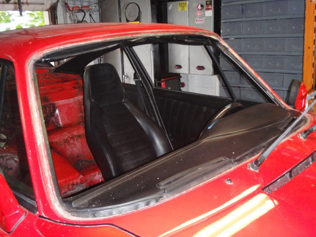

To answer how I chopped the top.
I cut a 3" section out of the "A" pillar removed the "B" pillar and pie cut the "C" pillar. Then stretched the top and bottom "A's" to meet. I run 3/8 steel down the middle then started to weld back each layer.
The B & C pillar's were much easier to rebuild
one thing you have to remember is that the pillars are structural and you have to peal them like an onion then brace each layer as you put them back.
it's not as easy as just cutting and pasting:
