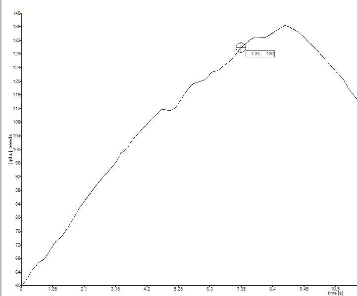

You can see how long a gear change takes on the graph from the data logger, and starting in 2nd and crawling along at 30-40mph on a nice dry level road you'd be hard pressed to spin the wheels, unless you have monster torque!
I've just done a run, with the new turbos fitted, but not mapped yet so boost is down at 1.0bar. You can see my run isn't smooth so maybe the ECU is pulling timing a bit? I just thought i'd see where it is, 7.34 seconds is certainly in the right direction
I think when i get my RS Tuning map and it's boosting properly, it should be touching 7 seconds. That will be with around 520 flywheel HP, which is around 450 at the wheels?
Back to the 1.0 bar by 2600 rpm on a CIS car with 400HP at the wheels.......
This is a graph with my 930 when it was running a small Garret ball-bearing turbo, it is showing flywheel HP so maybe 350HP at the wheels. My engine at the time had 964 cams, ported and flowed heads, headers, tapered injector blocks to match the ports blah blah.... I'm not sure what model Garret turbo it was, maybe a GT30r, it spooled REALLY quick.
What turbo are you using to get to 1.0bar that much earlier than this, AND make a HUGE amount more power???? I may be an antagonistic pain in the arse, but I call BS

Jacob,
Sounds like a very well thought out build and a very good dyno set up by including both AFR & Boost curves! Lots of good info.
Looks like displacment, compression, cam timing, headers, and twin plugs all targeted to help low end and get it into boost quickly.
All these should add up to a pretty responsive build targeted for low to mid range power.
From the dyno plots shown I think I see the following:
1) You might be approaching the limit on fuel delivery.
2) The turbo is reaching its peak efficency at about 4200rpm / 250whp/300chp.
3) Your turbo might be reaching its gross delivery potental (.7 bar @ peak ; .55 bar at 5500rpm).
4) You are reaching full boost (.7 bar) just before 3500rpm which seems late given your build and turbo choice.
5) The test was stoped before the motor hit its peak HP potental. It has a great flat TQ curve that was still holding even though boost was falling off and the test was stoped early.
6) This motor should have about 450whp potental at 1. bar with the right turbo, fuel delivery, and tuning. [((350/ 1.55) * 2)= 450].
A GT 35 Turbo might be a good fit here. It might better hold boost through the upper rpm and do so in a more efficent way that helps keep the charge cooler.
I could be wrong so all I am saying is just watch your boost curve. If you can not hold boost through 6000rpm it is small and could be overly heating the air.
With its ball bearing construction and more efficent turbine it might even boost sooner and help your low end response.
I am not an expert, I just love this stuff so take this for what it is worth.
This is a graph with my 930 when it was running a small Garret ball-bearing turbo, it is showing flywheel HP so maybe 350HP at the wheels. My engine at the time had 964 cams, ported and flowed heads, headers, tapered injector blocks to match the ports blah blah.... I'm not sure what model Garret turbo it was, maybe a GT30r, it spooled REALLY quick. ...
Johnathan.
A stock C2 makes .8 bar by 3100rpm with stock exhaust and a K27-7200.
Stock cams are going to help boost response. C2 cams have about 1 point lower effective compression ratio because of there later closing of the intake valve.
Were you running a boost enrichment delay. If so that keeps the control pressure higher longer and slows boost response to.
Then the is what gear the car was started in and how early in the rpm range the test started.
Then there is timing, AFR's and other small things.
Not saying something can or can not be done or is probable or not, but with the right set up it should be possible to hit boost at a very early point. That dose not mean it will carry in the upper range.
I talked to one builder that with a very small hot side on a custom KKK made boost at idle on a C2 turbo with EFI.
The best.

Originally Posted by 911st View Post
Johnathan.
The best.
I don't doubt you could make 1.0bar by 2000rpm even.... But show me a turbo on a CIS car that boosts that early, AND produces 400hp at the wheels, or around 460hp at the flywheel...

Jonathan,
Got it. And if it did it would probably have a pretty high header pressure at the expense of heat and unrealized upper end HP.
No one in the vocal set of tuners or fellow 930 owners seems to track pressure differentials. They can offer a lot of clues to where our issues or restrictions might lie.
For example:
What is the residual or exhaust manifold pressure relative to boost?
What is the pressure just after the turbo to determine the muffler's back pressure ?
Same on the cold side:
What is the vac just after the air cleaner to determine its restriction.
What is the differential before and after the metering assembly off idle (lag) and at WOT?
What is the pressure drop between the turbo exit and throttle body (IC and plumbing)?
What is the pressure drop through the throttle body?
All info that should not be that difficult to gather and would hold clues as to where the best opportunities lie.
For example. What if we are seeing 2 psi loss on the suction side of the turbo (air filter and metering) and 2.5 psi between the turbo and intake manifold at 1 bar / 5500rpm (intercooler and plumbing pressure drop). With this we know we need to look at the 2.3 bar part of a compressor map instead of the 2.0 (1 bar) part as to the turbos efficiency if we want to hold 1 bar boost at the intake port. Also that there is opertunity to reduce restriction that would reduce our turbo from haveing to work at the 1.3 bar level for lower intake temps.
In a hurry to sell things or save a buck these basics seem to be disregarded. To bad, a differential pressure gage is not more than about $150. Further, with the current crop of wide band monitors, it would not be tough to add a couple of pressure sensors and log some of the basics.
What if we could find that lowering control pressure with first acceleration reduced intake drag 50% for faster spool. What if the fancy muffler is causing higher than expected back pressure at idle or WOT (my B&B style cost me 10% hp at 350whp). Maybe the throttle body starts adding significant restriction above say somthing like 300whp...
Thus a thought.

Hello together,
attached you can dee the dyno data of a stock 3.0 l Turbo from 1977.
The only modifications are the unmounting od the thermoreactor (so it comes to the European layout) and a real load of 1 bar (made a control measurement).
Everything else is stock equipment, even the turbo (3LDZ).
Of course the power is rather "calm" in comparison what I have seen in this thread before.
But as this car is in mint condition no further technical changes will be made, to keep it original as much a possible.
Cheers, cal

Is this a run up through the gears?
Originally Posted by cal007 View Post
If so this shows the opertunity from close ratio gears!
3rd and 4th stay in the 240-300 range.
However, with the shift into 2nd it drops way down into the 150 range.

Hi 911ST,
right this is a run through the gears.
I also see the the drop from 1st to 2nd gear critical.
But there is one critic on the graph. It shows the gear shift rpm at 6050, which is below the max rev of around 7000 rpm. Therefore the drop might become less intensive if reving up to the max.
I let draw another graph showing the max rev. The program only showed the rpm up to 6050 as the torque/ hp graph has been cut at that point (the curves already passed max values...)
Cheers, cal

Hi,
this is the graph for rev up to 6500.

This is such a great way to show info on the average Hp per gear!
Increase the average HP per gear and the car gets faster.
Think about it, if with the shift into second at around 80k / 50mph we could come in at 260hp instead of 190HP how much faster the car would feel right where we use it the most.
