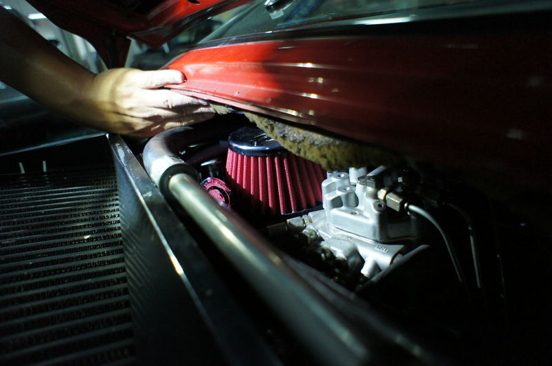

I removed my air box on my 86 930 and used Fabspeed intake system. I now have a 91 Turbo and also wanted to remove the air box . When I tried to order the kit this time around I was told it wouldn't work on my 91 even though their web page states will fit up to 94.
My question is, does anyone have the part numbers for all the filters that would be needed? If I would use K&N filters. Its been sometime now since I put it on my old 930, how many filters are needed? Thanks

You don't need any little filters just vent the hoses to atmosphere under the sheetmetal so you're not breathing in the fumes while driving especially in cool weather if the heat is on and blowing.. thats all engine compartment air.

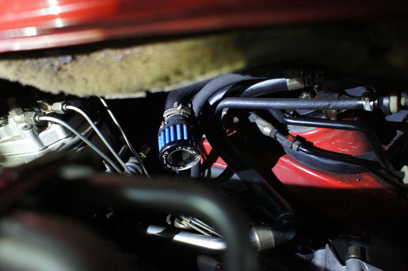

I installed my kit on 1991 965 turbo, you will need 25 mm for oil tank breath valve 15 mm for fuel tank breath valve and main air filter.
For 965 turbo A/C line is secure to air box you will need to tight it down.

Agree....but I would put vent hose close to main air filter. Smoke come out from oil tank breathing hose while waiting for traffic light does not look good.

I order from Simota #1 air filter comapny in Taiwan, I have regular cloth type and stainless steel screen race type. If you want to try it I will sell regular type kit for $70 USD, stainless steel screen kit for $90 USD. Shipping included.

WUR and idle control valve hose is connect to intercooler, the hoses go to air box are oil tank breathing valve and fuel tank breath valve.

I talk about this hose:
Old 11-07-2011, 09:32 AM
race911turbo's Avatar
Join Date: Jun 2007
Location: Portland OR and Taiwan
Posts: 138
That is not a hose connector, leave it open.

Isn't that the "breather" port for the diaphram? If the diaphram ruptures gas flow out of this.

Yes. I have a hose connected to it and then running to the bottom of the engine. If it ever breaks fuel will spill on the ground instead of on top of the engine.

I have a K&N air filter on top of the air flow meter so I drilled a hole and put a small brass elbow in the rubber top and ran a vent hose from the WUR to it. If the WUR vent line decides to take a leak the motor will probably start to cough black smoke and let me know somethings up.
