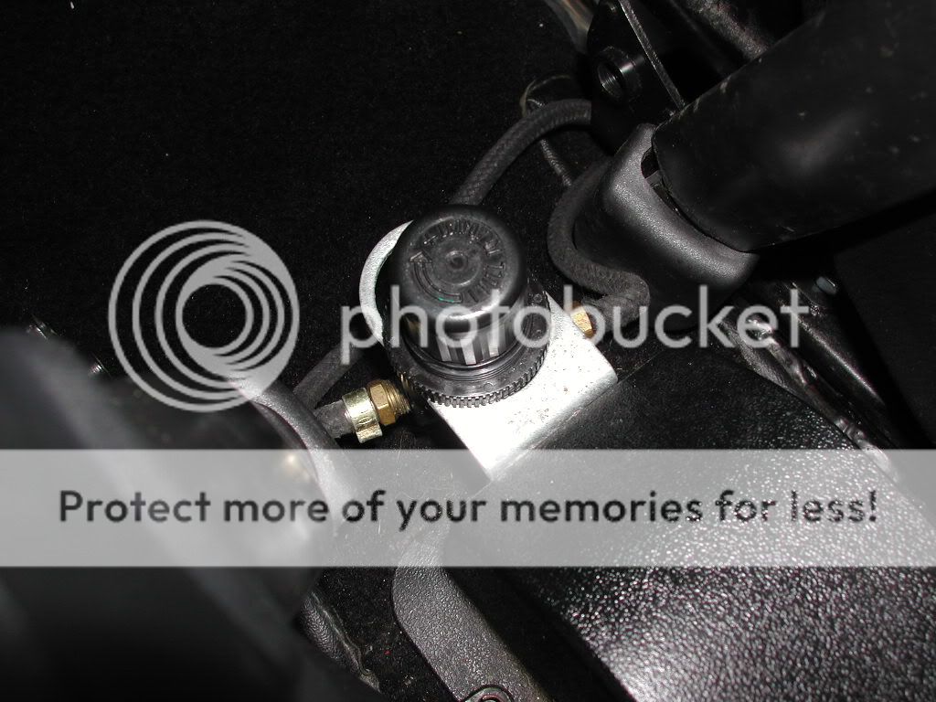

I want to replace it with the same one. I just recently got the car and today I took a look at it. It states on the top to pull to adjust and when I pull it up and try to turn it, it just turns freely, wont stop no matter which way I turn it.

Hard to tell from that pic alone. There are two types 1- is ball and spring which uses the adjusted spring pressure to control the pressure to waste gate and are fast acting at set pressure. 2- is more of a controlled leak. Adjustment opens a vent to increase boost pressure and if vent is closed more it lowers boost. Not as fast or controled to waste gate.
I know that didn't answer your question but there are many different places to buy these. If I wasn't on my phone I would google for a link for you.

Looks like the one from Turbonetics.
Turbonetics Manual Boost Controller Saab Volvo Mercedes Mazda RX7 Ford VW | eBay

Thanks guys... I'll need to take a look at mine again. That one looks to have 3 ports where I thought mine has 2.

That is a Turbonetics 2 port, you can purchase it at Jeg's
Turbonetics 10402-25 Turbonetics Variable Boost Control Kits

Open the case and check the connection with the handle. That never ending twisting happened to me before and it was that the T handle became disengaged from the actual valve. Easy fix.

Andial also has a very similar control. I bought an 84 Carrera that had been converted some time ago by Andial and it had a "dial of death". I called Andial in CA and they had one on the shelf. I don't think they had sold one in a while. It's basically a simple air pressure regulator. It was about $58 if I recall. not nearly as expensive and I would have thought. If needed PM me I may still have the part number. I have since gone megasquirt with boost control and efi. It's under the knife, but now in the car thanks to a good friend.

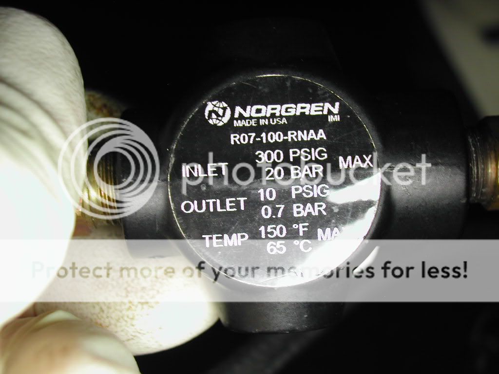

Well it turned out to be a $15 Norgren regulator. I'm going to just order a new one and keep it right under 1 bar. My paper work that came with the car states it has a 1.1 bar waste gate spring.
