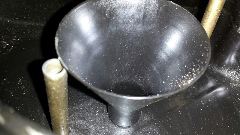

So, you believe on that inverted cone function, what is it about it?

Looks like it's supposed to help spread the incoming airflow out a little so it flows over the edges of the round sensor plate better. Maybe it works maybe it makes no difference. I wonder if anyone ever did a dyno test with it and without it... I doubt it.
If you put a round K&N air cleaner on the air flow meter housing then air is coming in from 360 degrees all the way around. Seems like that would be best in all respects.

^^^I'm with you, but there is another trend of thoughts as you mentioned... and Tadman definitely believes it. Regardless, it makes you wonder why Porsche put it there to start with. I did some testing a while back with the round K&N vs. OEM = no significant difference in power or torque but liked the free access and sound of the K&N.

Yes we did a dyno tune with a aftermarket air cleaner housing which was on the car when I got it.. My shop wanted me to go back to a stock air cleaner as they felt the cone was important with CIS. It did improve the HP . It has been quite awhile but I think it was around 6 hp.
I think Porsche always has reason for what they put into a build.

Just a little background on this addition to Tadman's great build.
The cold air intake was a gracious contribution to the Old Sled build
donated by RSRFAN. He originally planned on using it on his RSR build.
The cold air intake was off an old 935 bodied 930 race car and when
RSRFAN decided not to use it he sent it to me.
I could not use the cold air intake because I decided to relocated
my CIS to the right rear of the engine compartment (ala 934) in an effort
to see if there were any advantages to a shorter intake track. My intake
track from the metering plate to the turbo inlet measures about 9" of 3"
tubing. Turbo spool up is nearly instantaneous.
Tadman contacted me looking for a cold air intake for his track car.
This allows him to feed cool air from 1/4 window to the dual air inlets on
the cold air hat. When Tadman contacted me I sent the hat to him.
No dyno, no R&D, no complicated science, just old school throw it
on and see if it makes a difference.
Cole

The Cone.......................................
So any of you who had a stock 930 intake had one of these. I did ad one to the intake at the same location above the mixture bowl and sensor plate. It was not because I think it adds horsepower and if it does its probably minimal. Now I am guessing like everybody else but I think Porsche engineers put the cones in the intakes and later cone shape sensor plates in the mixture bowls of 934's because the cone somehow helps stabilize and balance AFR's.
As for the the air intake, just wanted cooler outside air feed to the turbo.
