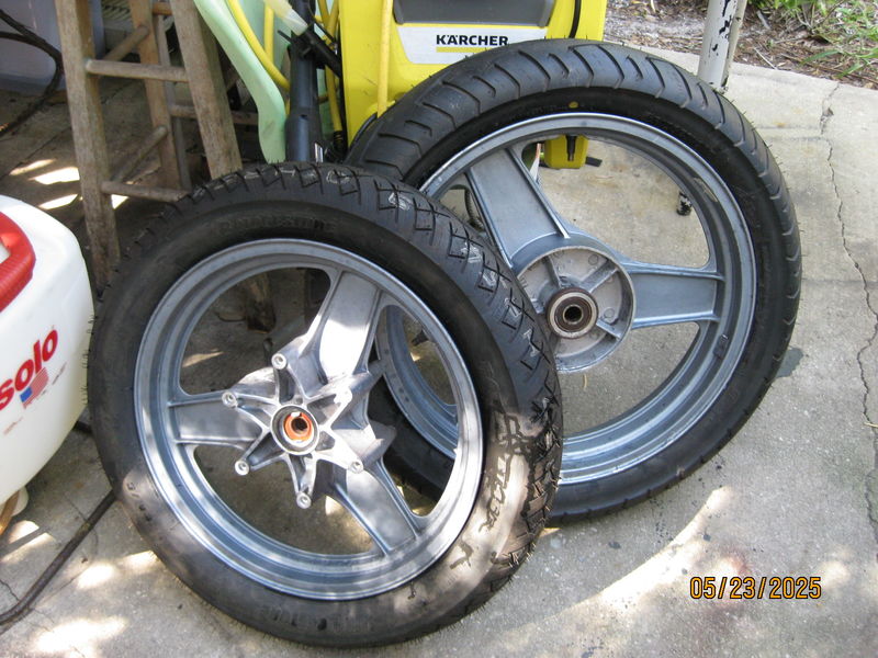

Mounted two motorcycle tires today - first time ever. Really not a big deal as long as you follow a few basic principles.
Checked my rims first on the balance stand and both were already very balanced!
Will do the entire wheels tomorrow. I still have to get the rear brakes working before mounting the rear and then changing the front one.
Hopefully will get that all done this w/e!

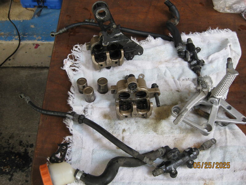

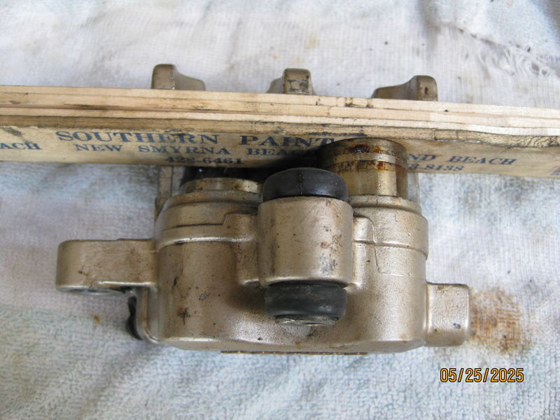

Rear brake work today......going through old calipers and assemblies to make two rebuilt ones.
I use wooden paint stir sticks to get the pistons out a little at a time so they don't fly all over the place!
