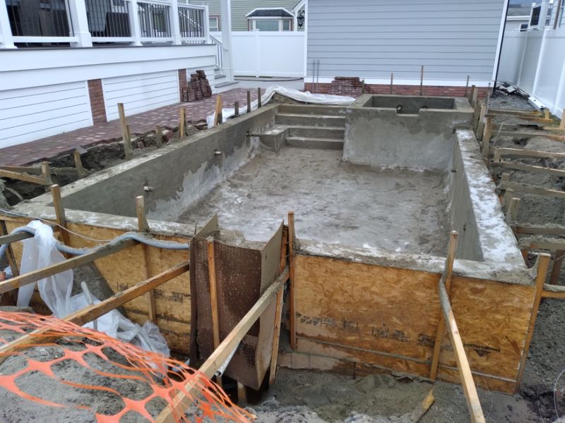

The pool is in and they are still pumping. So you can now see how this pool is very similar to the garage of the condo. If the water table rose during the curing period of the concrete 9the green phase) and they did not relive the pressure the concrete probably cracked. The tide rises and recedes two times per day, add a storm and the water table rises. As the concrete cures it gains more and more PSI until it reaches full cure.

Not sure how closely the water table level matches the tides...
But that pool looks only 3-4 feet deep... Not sure if there is a deep end
Say the tide and water table elevation match inch for inch, the still would be only be a small amount of horizontal pressure on the walls......
Then there is buoyancy... you could float that pool right out of the ground..
The contactor should partially fill the pool to make horizontal pressure and bouyancy close to zero...
This is a barrier island the pool is in the water table, which moves up and down based on tide. Higher during a full moon, storm, etc., lower at other times. That is why there are pumps. as the water seeps into the hole the pumps pump it out.
The walls are not the issue, the floor is the issue especially at this stage where the concrete is still green. If they did not have the pumps running to keep the pressure down the pool would do exactly as you say, it would try and float. The upward pressure would crack the pool floor. When the pool is ready to be filled they will fill it equalizing or exceeding the pressure then remove the pumps.
Interesting.
Currently have a pool being finished, waiting for plaster this week.
Our builder popped 3-4" holes in the floor at the corners to deal with hydrostatic pressure.
Basically any water will flow into the pool relieving pressure and somewhat equalizing pressure.
Obviously when they plaster they will close the holes first.

Interesting.
Think of a pool as a boat. Certainly drilling holes will work, just like a boat, fill it full of holes and it will sink. In the case of the pool where I am it is like the boat being in dry dock or on a beach when the tide goes out. Put the boat in the slip and pump the water out.

Even with the gross weight of the pool won't the changing water table eventually create a problem?
Sorry flattbutt I didn't mean to ignore your question. No once filled with water the pool will have a greater displacement of the water so it will stay put. If they drain to much water out that could be a problem.

A floating pool cost a family friend his home and his marriage.
He was in the trades and decided to diy his own concrete pool, hiring friends to help, dog, form, plumb and wire, reinforce, etc.
The pool was poured right before hurricane Irene and he didn’t know he should partially fill it as soon as it cured.
The pool floated, had to be busted up and thrown away. In the emotional fallout of all of that, he and his wife divorced.
