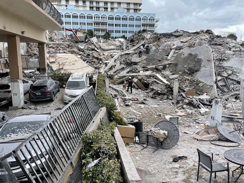

I don't see cables either. The parking garage appears to extend under the pool deck and almost up to the pool. I read they are going to analyze the other sister buildings. I wonder how/if they are monitoring the section that hasn't collapsed(yet).
I’m certainly no expert on hi rise residential nor post tensioned concrete but my understanding of post tension is that it’s called for when there are large unsupported slabs. You wouldn’t need that in a residential tower that has lots of interior partitions.

I'd like to see some before pics of this area. Looks like entire parking lot/patio pancaked onto lower parking deck/basement of some sort.
My comments about Burj K. were more about pushing the boundaries of cement/rebar too far. This seems more foundation related.

This is not good. Something that too many architects, engineers and builders don't give enough thought to:
The amount of weight (also seen in other pics)riding on 2' columns is astronomical. I wonder what was attached to those columns that you have arrowed?
That’s where the parking lot slab used to be. It has fallen 7 or 8 feet, after completely separating from the columns.

Looks like the ground itself collapsed into a sinkhole.
At first I though those were just to hold up a wrap-around walkway, but that could be the corner of the building.
