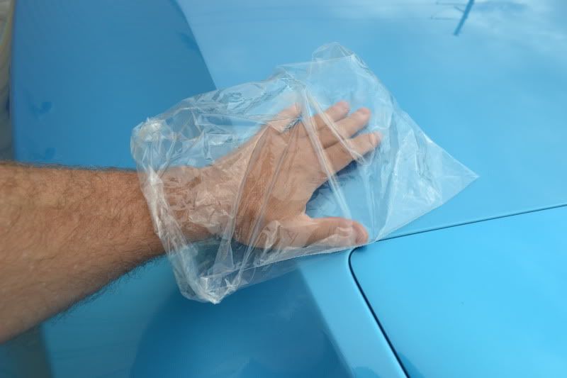

Vehicle surface evaluation*-
One of the most important aspects of a successful detail job is the evaluation of the vehicle surface. This evaluation will allow us to prepare ourselves with the correct products and steps, things like light scratches, swirl marks and other paint imperfections can be evaluated at this time, from here we will have a plan of what products are needed and in what order.
You want to prep your washing materials first so you won't be running back to get items from storage while water is on the paint or wheels. You can use a pressure washer usually with no problems, just use caution when doing so. You don’t want to get to close to any surface of the car with high pressure water, especially to pin strips or emblems, failure to do so can result in inevitable damage.
Now let's evaluate the surface condition of the vehicles paint, if you pass your bare hand on the surface chances are that the surface will feel good and free of defects, however a simple test is to use a very thin clear sandwich bag over your hand ( using it as a glove) and pass your hand very gently over the surface, you will feel what appears to be very tinny bumps, that's an indication that your surface is contaminated and that you will need to prepare the surface better, if you have any doubts simply go to your garage and do this test. If you feel any of those bumps you will need to apply correct that if you don't feel any of them you can proceed with your wax.
