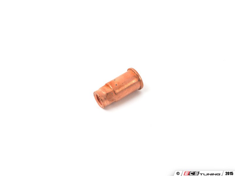

I ordered 12x 057 131 529 G ... I have a feeling they are going to look like this:
Still should work. The 059 131 529s aren't avail thru US dealers so lemme know what you come up with when yours come in. I still may cut down my studs...

Well... the ones I got look just like the one pictured above but they're a few mm too long... won’t grab the threads... so... back to spacers for now.

Update: I cut the exhaust studs down with my Dremel tool, tapered the cut end and re-threaded (chased) them, and stuck with the stock style barrel nuts... and was able to get them all tight with an Allen key and some ingenuity. No spacers, no stud removal :thumbup:
