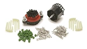

I like this Painless Wiring bulkhead connector for building out engine harnesses:
Item #40130

Here's the wire configuration I went with for the XDi controller multi-pin connector:
Some factory installed wires in the AMPSEAL 23 pin connector were not needed and were removed (MAP sensor etc), and the DFU extension wires were added.
I wrapped the harness in Techflex F6 3/8" sleeving and put some heat shrink on the ends:
Gordo

Now that's disgustingly simple and uncluttered.

Receptacle Mounted
Made a mount for the Molex pin connector receptacle (test fitment). Will be wiring it in today:
