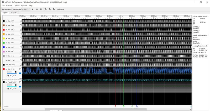

Parts from Futurelec are still underway but I got the logic analyzer working.
Picture below shows the (un)grounding of the reset pin 9 on 8051 with ADC removed @20kHz sampling rate.
I then observed the following, sporadic behaviour (not pulling pin 9 to ground), again at 20kHz
Looks to me that the few times when pin 5 goes from high to low, the appearing signal form at pin 6 of LM373 starts to look like it does in wazzz's simulation between +20 and +31.1 ms.
Analyzing LM373 more closely:
Can the experts deduct anything from these graphs regarding cause of uC resetting continuously?
For completeness sake the 4th OPAMP connected to uC pin 10 RXD:
Other signals on the uC 8051:
@20kHz, pins 2 to 9 RST, 18 XTAL2, 19 XTAL1 and 30
pins 21-24 and 32-40
pins 21-24 and 32-40, some moments later
the above are repetitive (no surprise there).
@30MHz (f_ALE=1MHz, f_XTAL2=6MHz)
@30 MHz
Next EEPROM 27C256 pins 2 to 13 (13= analogue channel just to use all available channels), @20MHz
ADC removed in all graphs. I found no short and open circuits (used a magnifying glass) and all IC's have been replaced in the process. That is not to say that they have become damaged again in the process but still.
I don't know how to check the transparent latch or "the only other item is a NOR gate to generate the OE! for the EPROM".

Sample A0-A13 with 1Mhz using the external clock input of the logic analyzer connected to ALE and trigger to RST. Sample on the falling edge of ALE. You should be able to decode the long jump from 0x0000 to the reset vector.

Here is an example of a healthy startup. Shortly after the reset goes low the 8051 starts reading the first instruction at address 0x0000. The first three bytes in the EPROM are 02 02 0f and this decodes to LJMP 0x020f where the reset routine below starts. The code on your DME is in all likelihood identical:
In the logic analyzer trace you can see the processor reading the first three bytes and then executing the LJMP to 0x020f where it continues to read external code memory.
Zooming out in the logic analyzer capture you can see where the ICV signal begins cycling by going low 17.84ms after reset and then high 23.38ms after reset. Signal period is 11.68ms or 85.6Hz.
So in summary 17ms after powerup the DME is ready and waiting for flywheel inputs. Sorry for the picture quality. I don't know if there is a way where the BBS software doesn't down sample them.

Thanks for re-visiting and your inputs, gentlemen!
Unfortunately, my logic analyzer does not have a provision/input to use an external clock. It has 11 channels + 2 channel oscilloscope, so hooking up A0-A12 (didnt see A13 on the schematics, was that a typo?) already forces me to use the oscilloscope to scope digital signals and leaves no means of connecting ALE and RST to the analyzer for sample and trigger.
What pin is the channel designated 'parallel' im your graph, Ingo? Tbh I don't understand how I get the hex code.
I connected A0-A7, RST, ALE, RXD (UART decode to HEX, @9600 baud), TXD (same decode) and PSNE but the decode didnt yield any sensible results.

The channel “Parallel” is a protocol decoder that uses the address lines to calculates a hexadecimal number. It makes the data more readable.
You don’t need clock or other inputs. Just sample the address signals A0 - A9 on the EPROM. If your init LJMP uses the same argument (check your EPROM content first three bytes) you only need A0 - A9 to confirm the LJMP takes place. That leaves one more digital line you may use for trigger on RST or something else.
I used 10Mhz sampling and no clock. If you don’t have a way to trigger off the RST line just sample for a coupe of seconds start the data collection, and power on. Then find when RST goes low in the data.
Check the EPROM content for the first three bytes and confirm the 8051 reads the first three bytes and jumps to the correct address.
