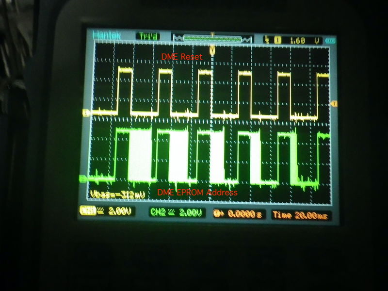

sigrok wont work with my LA hardware but I used their Pulseview software to decode a csv-export from the 'Labtool' software with the Pulseview included parallel decoder.
I captured A0-A9 plus the uC RST pin, ADC still out of circuit.
Decoded A0-A9, only to find that an error is reported 2 cycles after A8 goes high. Since it's all 8-bits I reverted to decoding A0-A7 and no error messages. Why capture A8 and A9 (other than seeing it is not entirely dead)?
I tried several methods of capturing a reset and by the looks of it managed several times (out of 30 or so...) but the hex dumps were all different from each other and none contained 02 02 8B, not even 02 02.
Let's consider the two possible outcomes of this exercise:
1. it jumps to the code in EEPROM but still I dont get the required ICV-signal
2. it doesnt jump to the code in EEPROM and that's why I don't get the required ICV-signal and keeps resetting.

Using two different 911 DME ECMs, tests were done without key ICs; EPROM, S705, S100, A/D. The 8051 address lines were active for 25ms then off for 12ms (reset).
Obviously there was no input to the ICV CMOS input pin 5. By only adding the EPROM, the CMOS ICV output functions.
Therefore, there's only three possible failure points; 8051, EPROM, and/or the circuit board. A simple scope setup is all that's needed!
Dave

Here're the scope images without an EPROM:
A good 8051 should output the correct EPROM addresses! There's NO need to disassemble the Hex code.

Putting the known good EPROM in the NOK DME I still get the reset signal on pin 9 of the uC...

Probes (1:1) are identical on A0 and A1. I needed to reduce the scale to 0.2V/div for PSEN to see what is shown. I didn't think anything of it but now you mention it, psen should be between 0 and 5V right?
Can't tell you why there are spikes on rst line.
The eprom (my bad for calling it eeprom) is a nmc27c256bq and has worked in the past but I haven't used it in the car recently.

Based on the almost not existing PSEN signal, I reckon it is at least the eprom. Can and will you confirm?
Yes, all logic signals should be close to 5V (high) and 0V (low). Something is funny. PSEN is used for as !OE on the EPROM. Look at PSEN with your oscilloscope and confirm it is swinging between 0V - 5V or just swap RST and PSEN connections on your logic analyzer. If that makes RST look funny you know it's your LA and not the DME.
