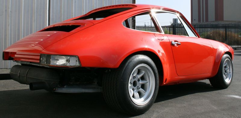

Here's one for the sake of posting...
Old 03-03-2011, 08:49 AM
tobluforu's Avatar
Posts: 4,025
Can anyone photshop this pic without the front flares?
