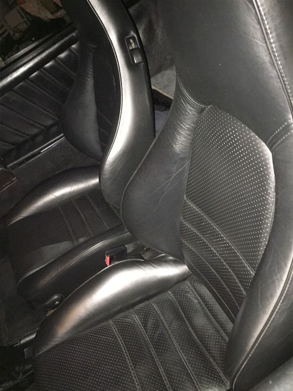

Nope, just the normal wear and tear, just got to keep up with the Lexol Conditioning from time to time until the leather breaks in.
Just be very careful with the steaming at the perforations, DO NOT GET Water in there, it will harden the leather.
One of my bolts for the rail came loose, but, that, ain't bad, next time I will use lock tight like the previous installer did.

Draco, thanks for the write-up. You've inspired me to try recovering my sport seats myself. I have some nice new covers from Lakewell that came with my car. I'm gathering the tools and supplies for the job, and have a couple of questions. I'm ordering the outward clinch stapler with 1/2 in. stainless staples. I'm also ordering the hog ring pliers and hog rings. Do you remember what size hog rings you used? Also, can you clarify your plastic bag technique. I'm guessing it's to help slide the skin on. Do you leave it in there, or can you reach up in and pull it out? If you leave it in does it leave any residual lumps? Thanks again for taking the time and effort of documenting the process.

Sorry forgot which size but maybe 1-1.5", get the copper coated if you have allot of moisture in your area.
Bag, technic, you can leave it in, no residual lumps, if it bothers you, I guess you can pull it out but it is pretty tight and you do not want to lose the alignment of the seams.
