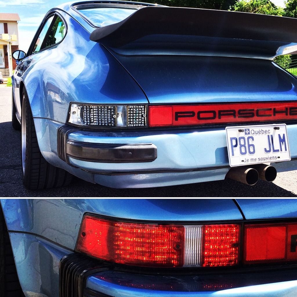

Installed the rear turn signal boards and am taking current from the rear position led as you mentioned. Looks great, well thought out and now my whole rear end is lit with LEDs ��
