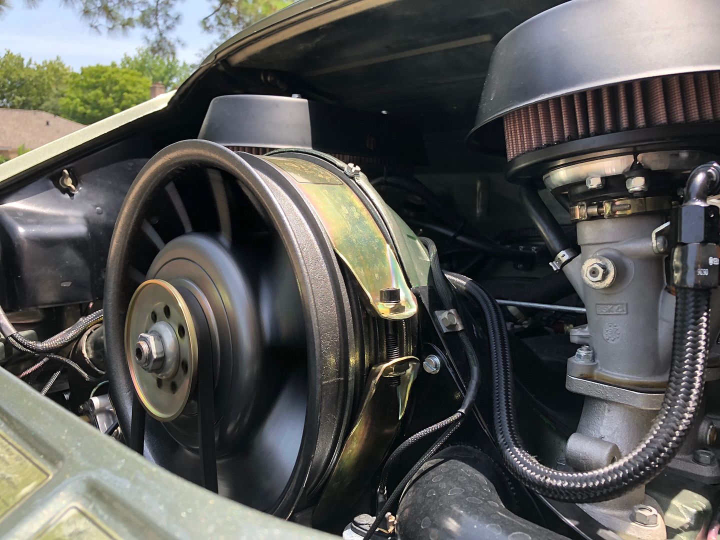

Clay.0 07-28-2018 01:23 PM
Still running strong!
http://i35.photobucket.com/albums/d1...psehnr9vcr.jpg
http://i35.photobucket.com/albums/d1...psy8lpbsk1.jpg
http://i35.photobucket.com/albums/d1...psxen85aqt.jpg
http://i35.photobucket.com/albums/d1...psvqfgvuez.jpg
mikedsilva 07-28-2018 01:39 PM
How does the bar mount? The flush look, looks great :)
Clay.0 08-07-2018 03:32 PM
Which bar?
