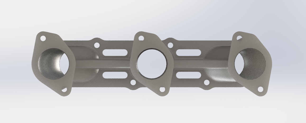

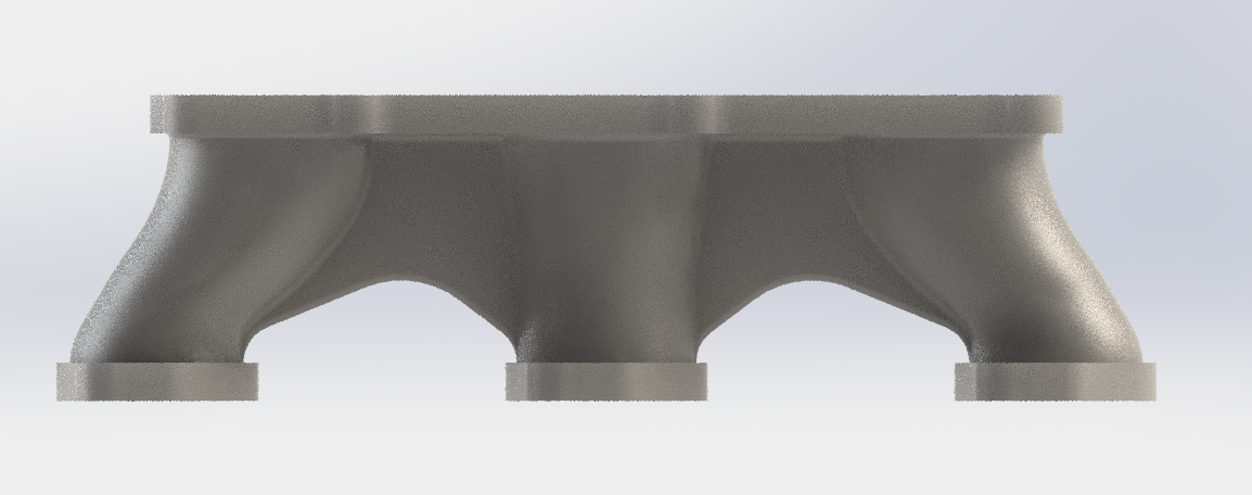

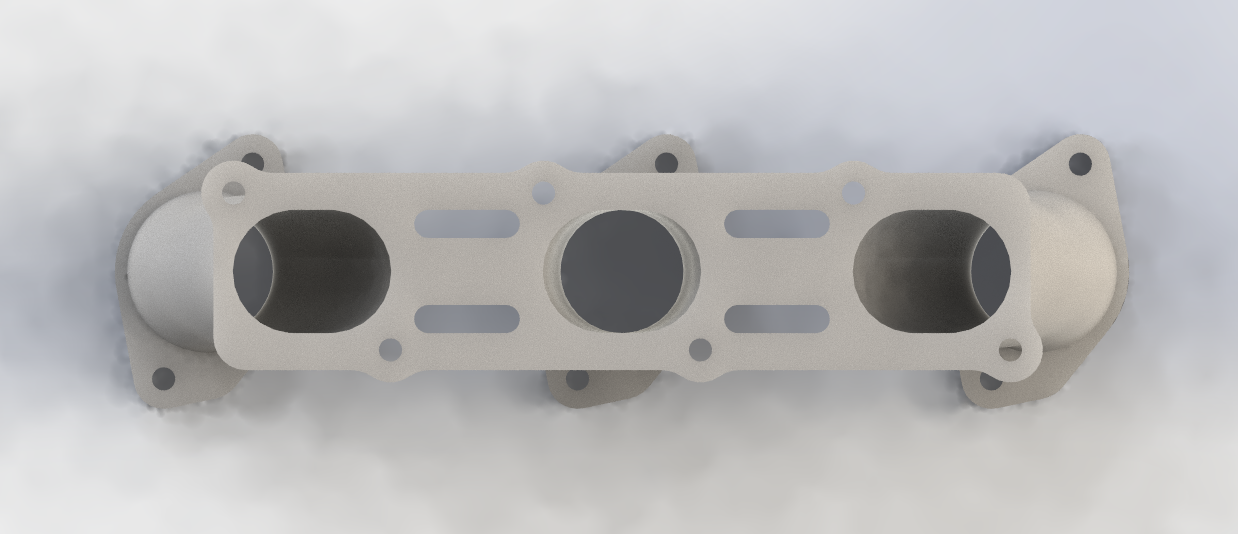

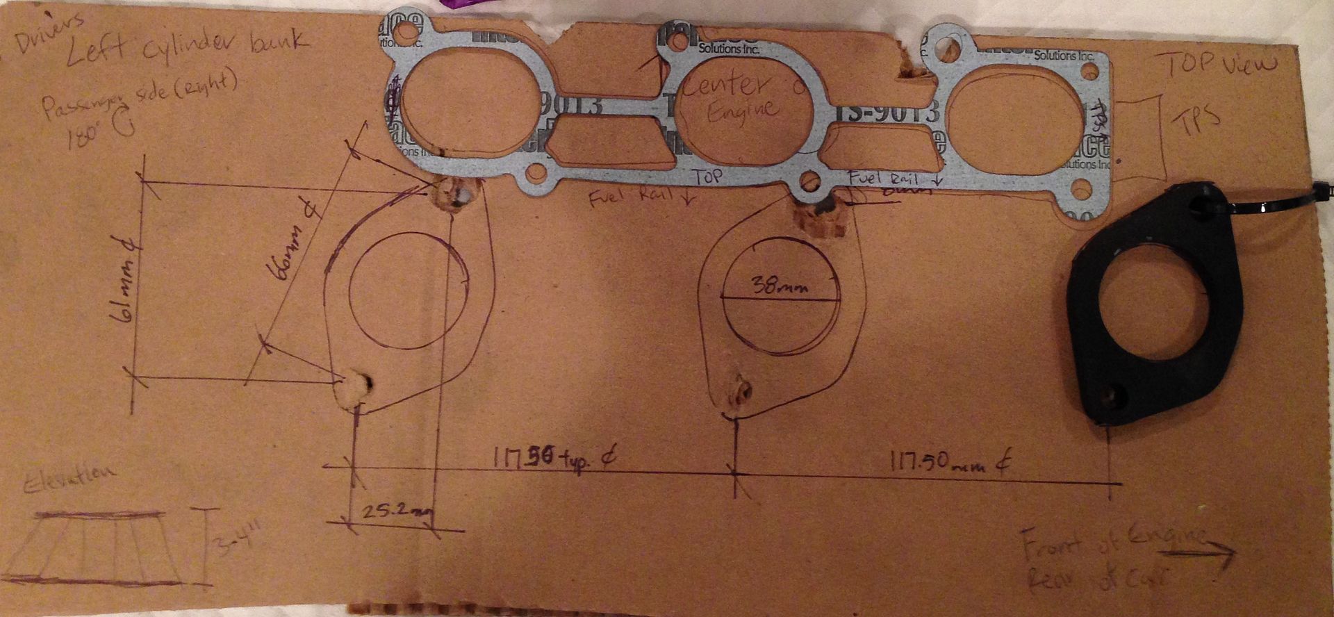

It all started with a few chicken scratch sketches
And a preliminary 3D model

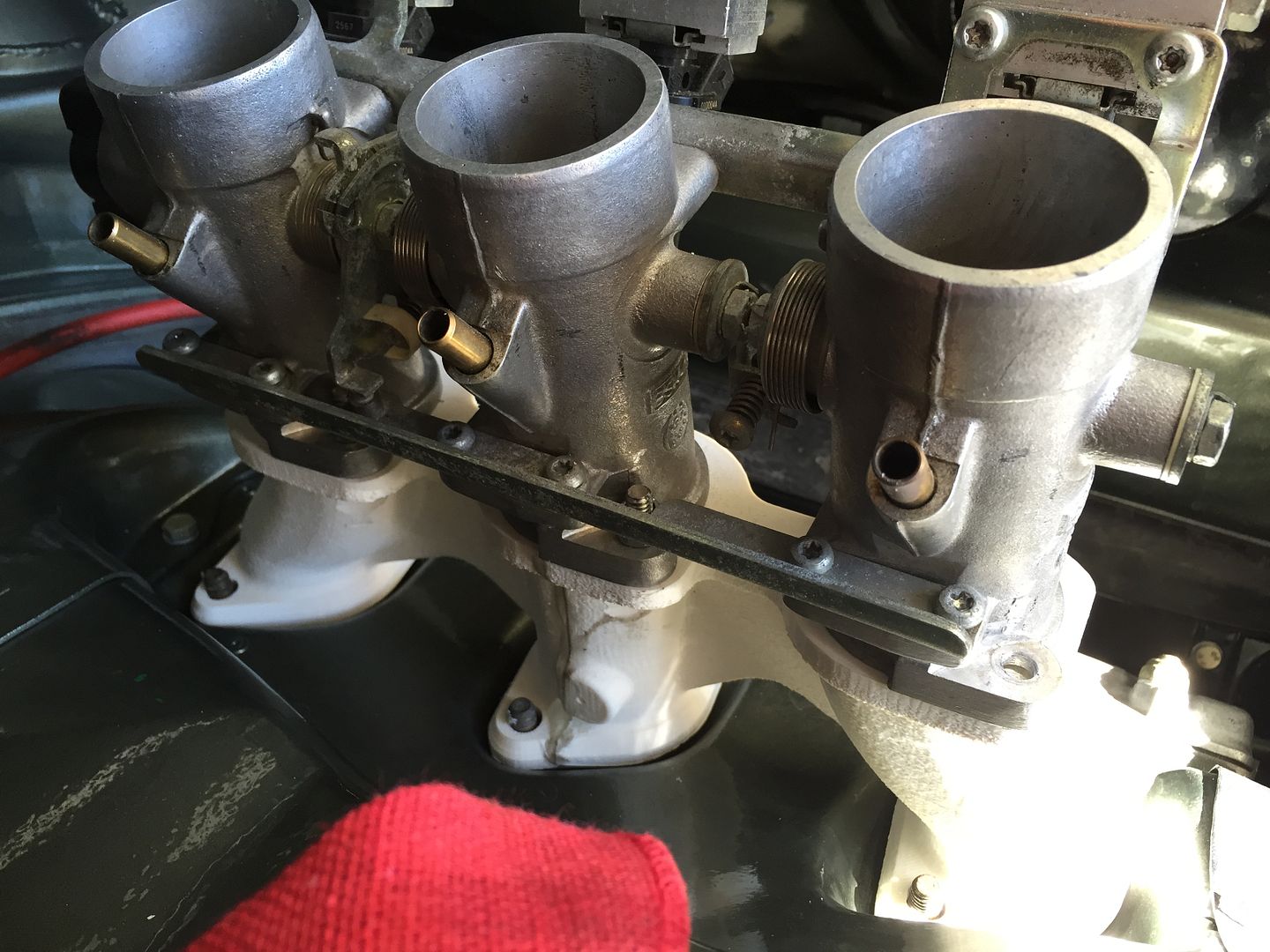

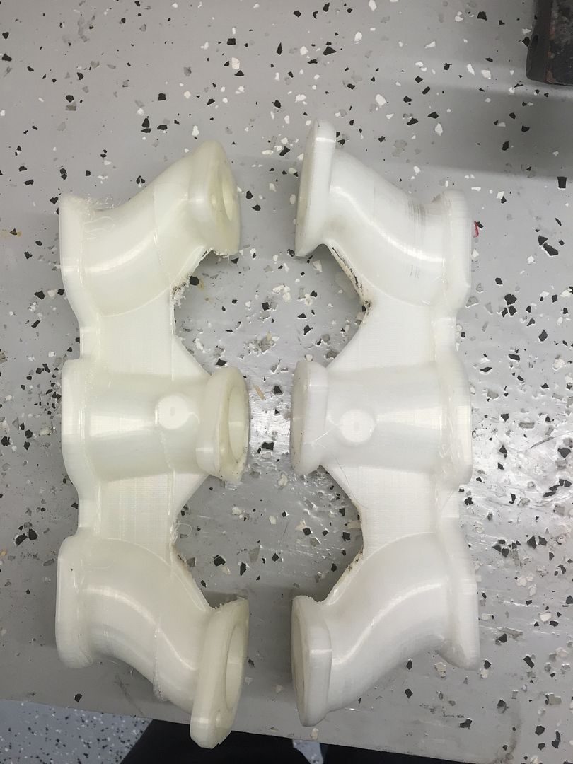

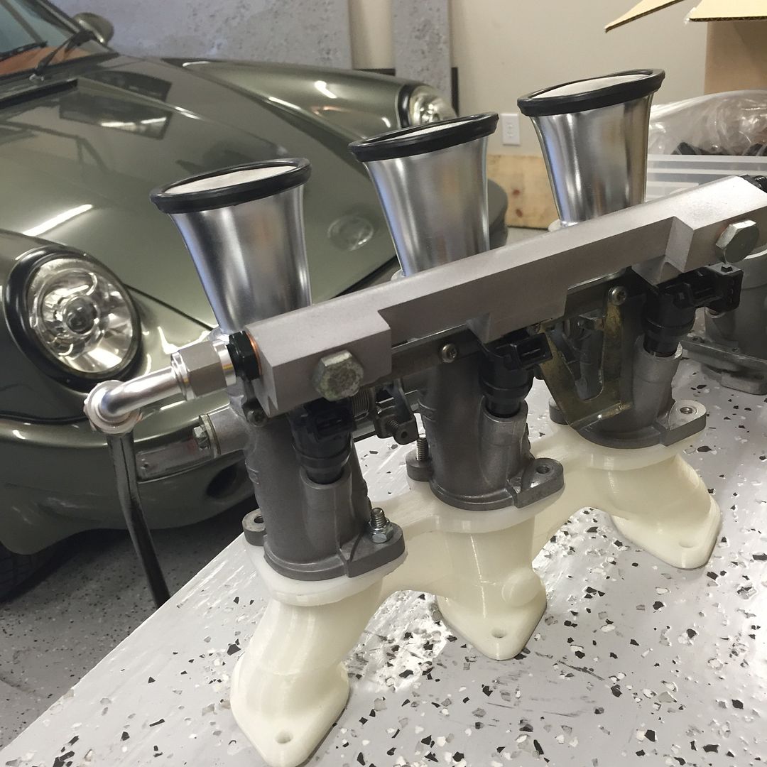

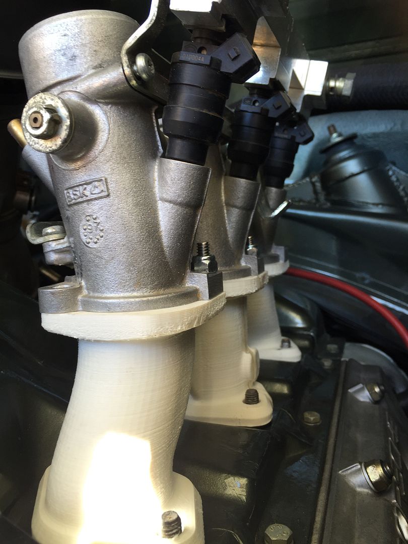

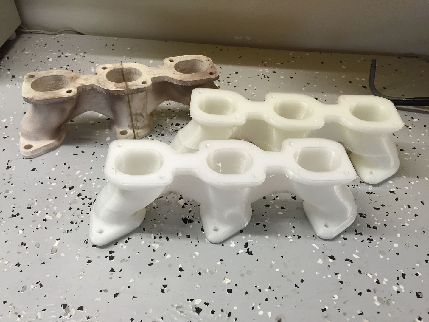

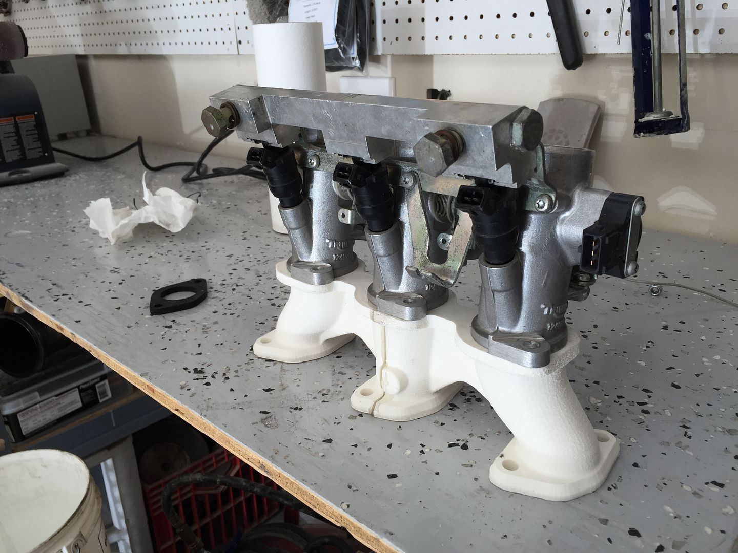

Once the model was made, we 3D printed a sample. My printer's print bed was too small for the full manifold so this test piece was done in two halves and epoxied together.
It wasn't too pretty, but it fit well.

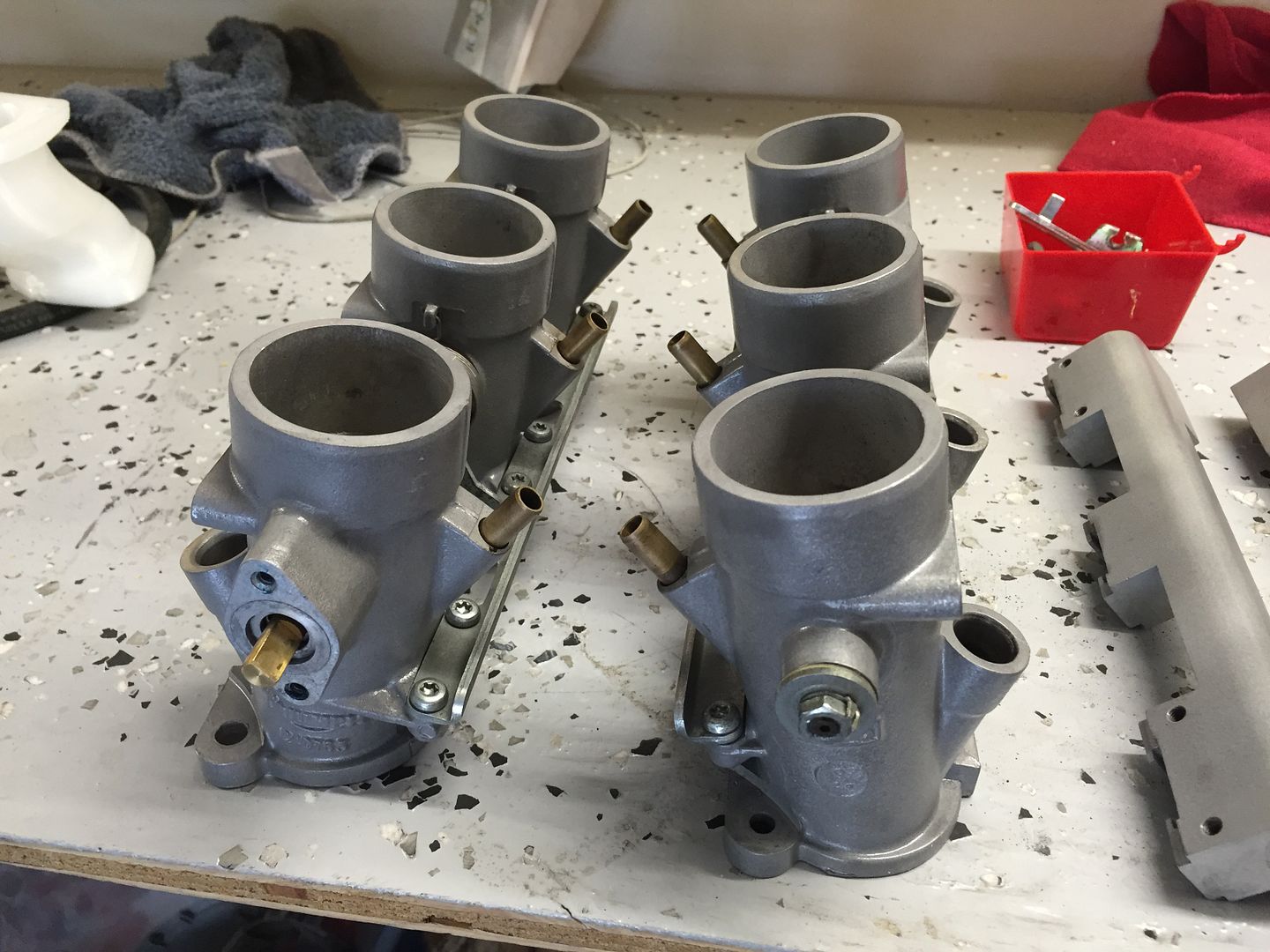

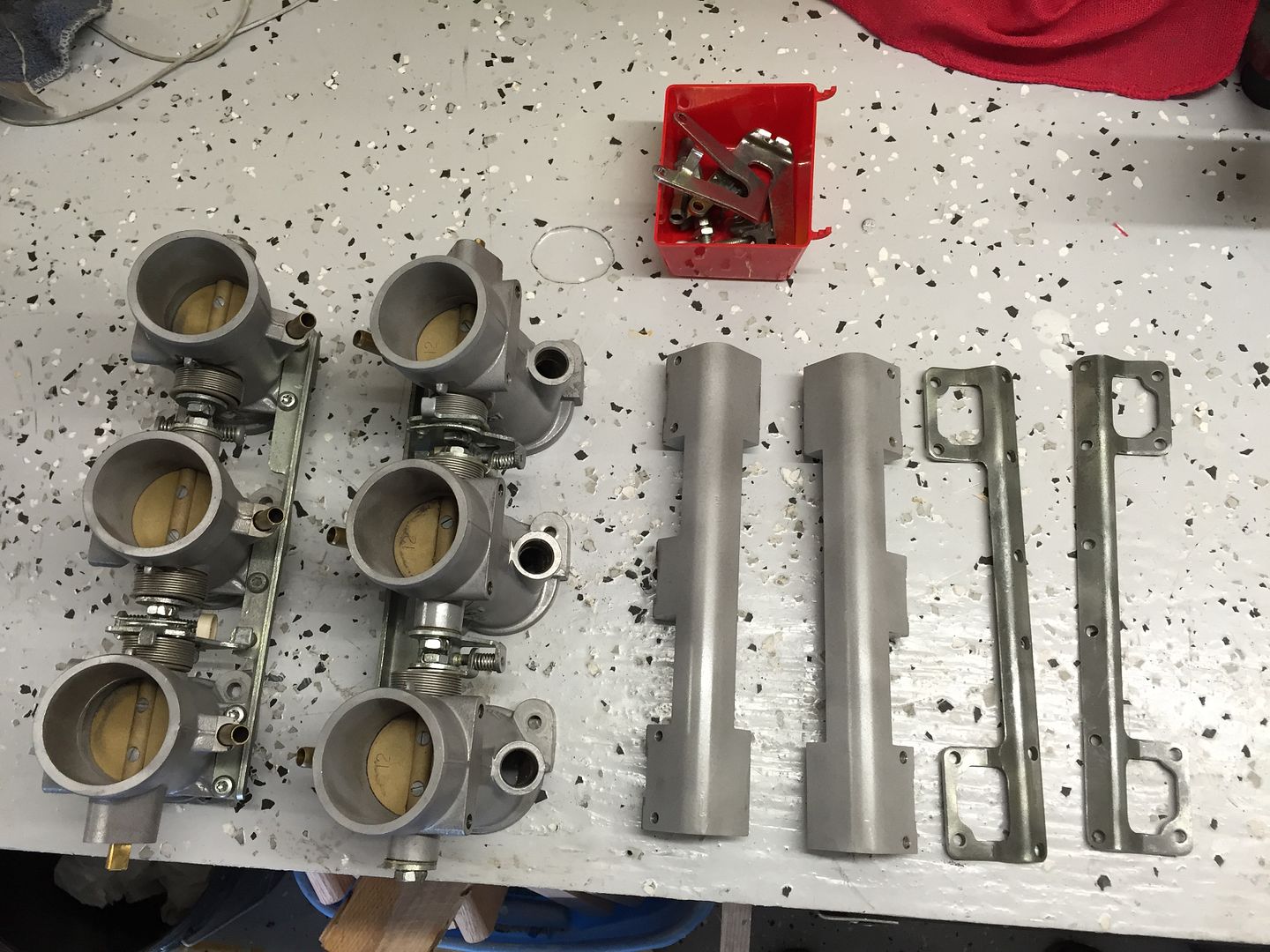

While the printing was going on, I stripped two sets of ITBs, sand blasted and cleared them
And started collecting other parts; donor distributor, AN6 fuel lines and fittings, full sized test 3D prints and other misc. parts

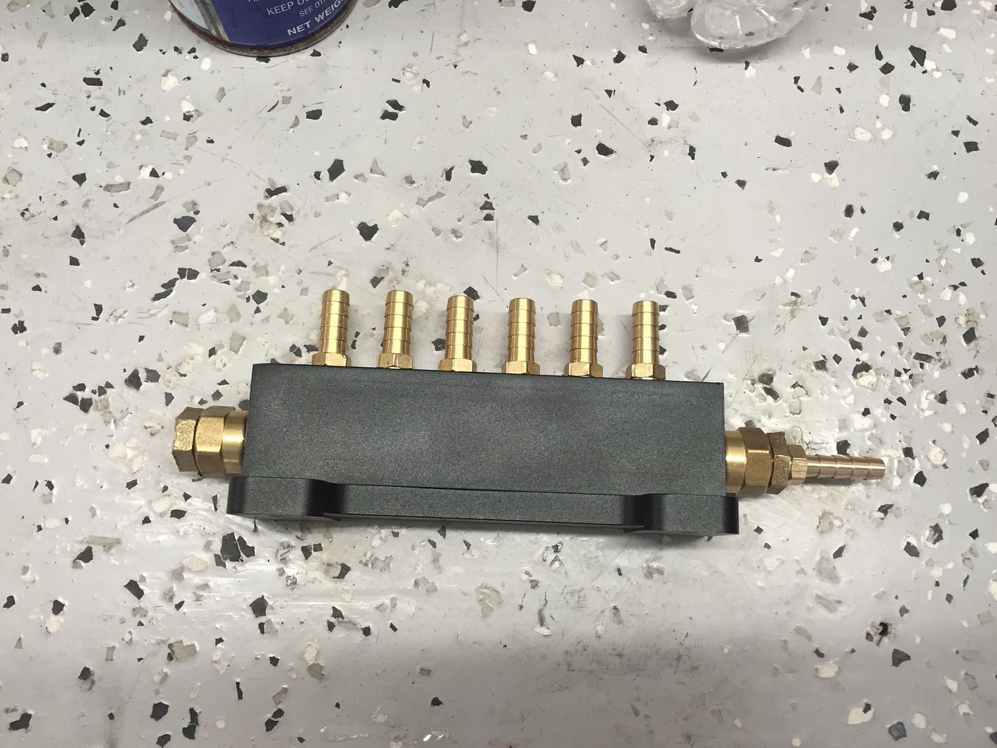

For the vacuum manifold, I used an Ebay manifold and fittings off supplyhouse.com This allows for the 6 ITB vacuum lines, 1/8" NPT for MAP sensor, and 1/4" barb for FPR

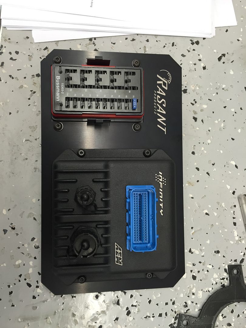

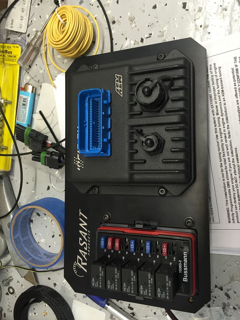

For the fuse panel, I used a Bussman relay fuse center and a bracket to mount the AEM ECU and fuse center. Rasant's kit includes this ready to go.
THIS IS A GREAT DIY FOR WIRING THE RELAY PANEL AND GENERAL WIRING TECHNIQUES:
DIY Bussmann RTMR Fuse Block, Part 4 – Wiring and Schematics | Bodenzord
Again, if you get the Rasant Kit there is little wiring to do, but I wanted to wire mine myself

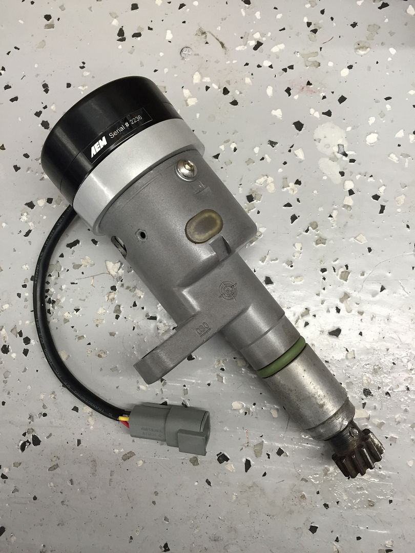

One of the greatest things about the AEM setup is that it uses an Engine Position Module off the distributor for the engine crankshaft position and camshaft positions rather than using a trigger wheel or other magnetic based reference sensor.
Installing the EPM on the distributor is a simple task with Rasant's distributor adapter kit.

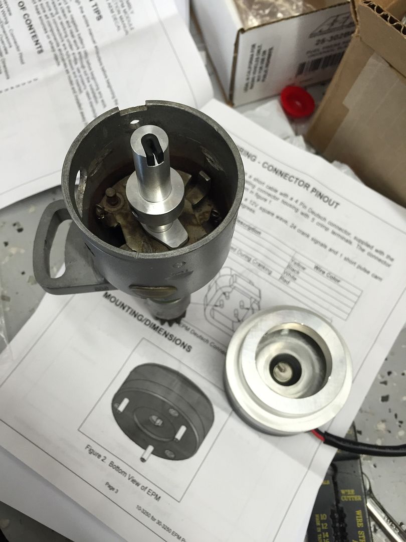

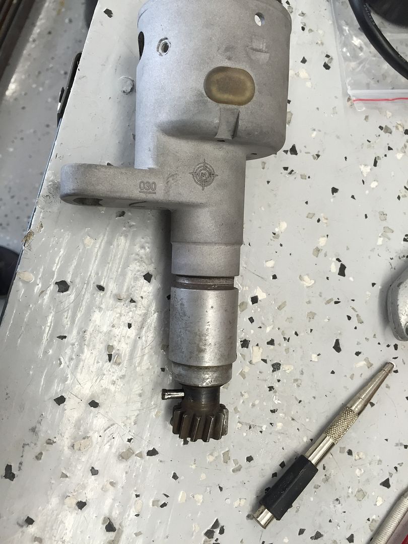

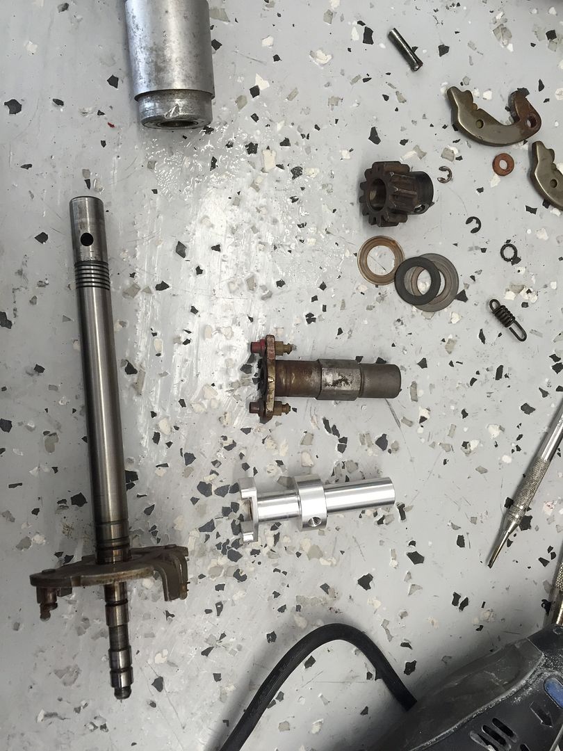

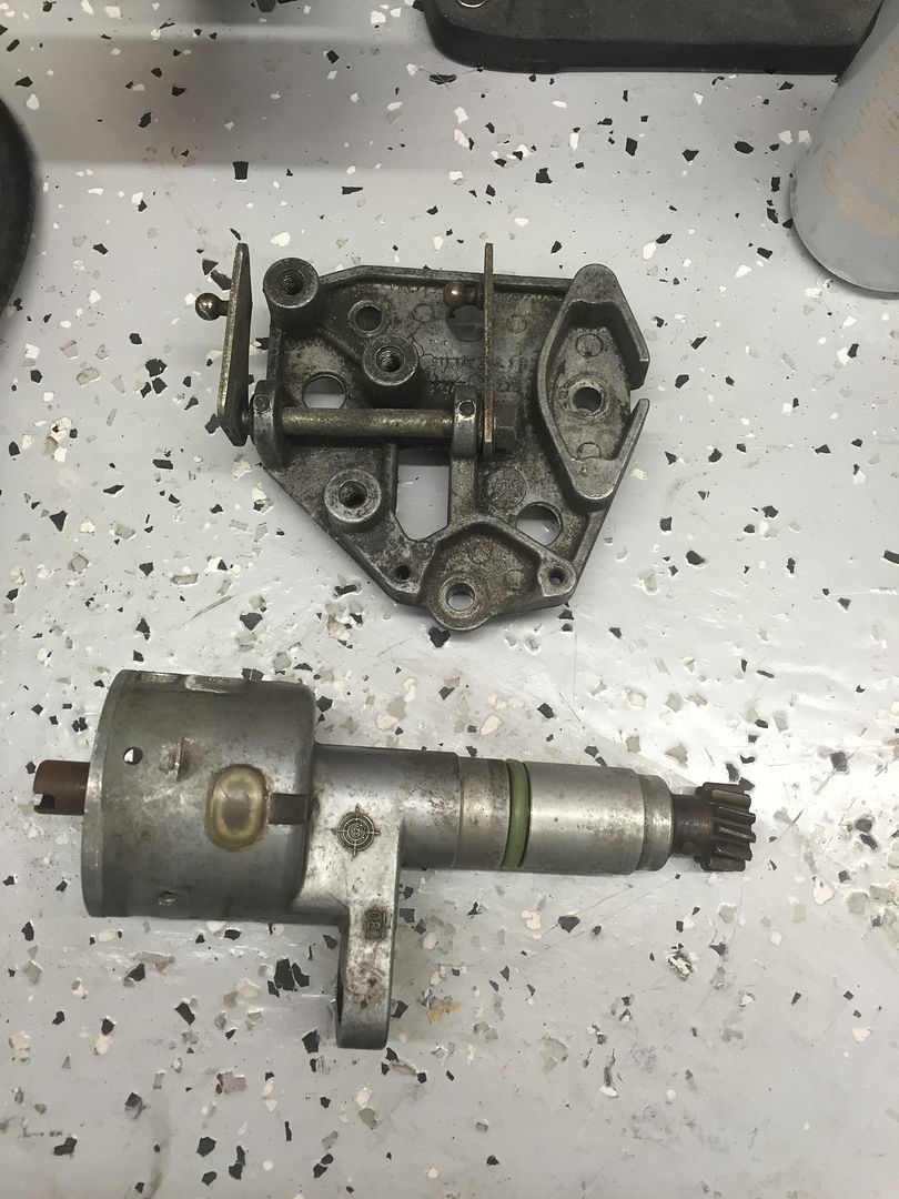

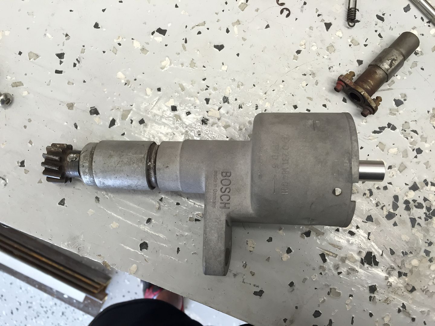

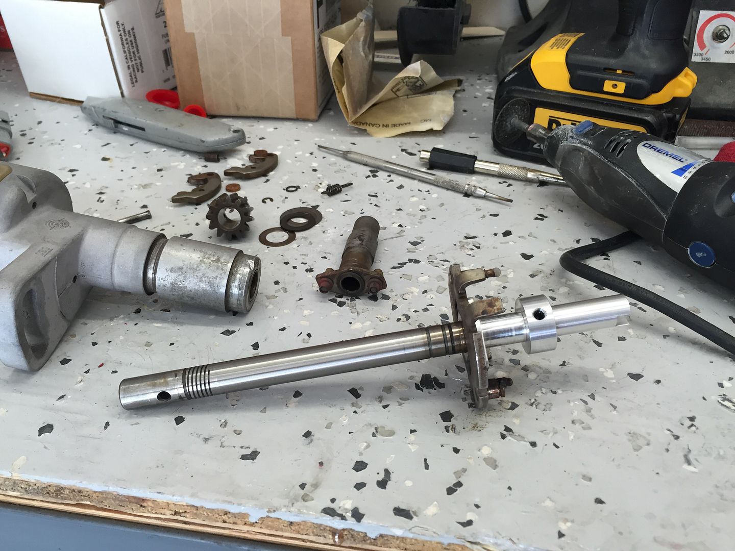

I started out with a donor distributor that I bought off the classifieds section. It was just a core and was picked up cheaply. I started by sand blasting it to clean it up, then punched out the drive pin.
Then pulled off the drive gear and center shaft
Removed the mechanical advance parts to install a fixed drive for the AEM Engine Position Module (EPM). The aluminum fixed drive is part of the Rasant EPM adapter.
Drive installed with set screw
And reassembled with gear drive

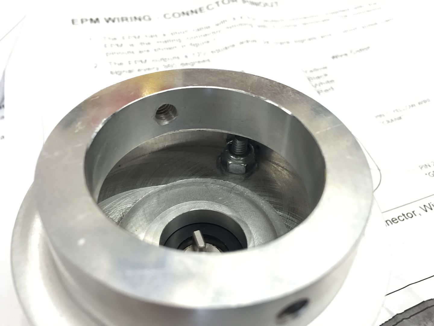

Then installed the Rasant EPM adapter to the AEM EPM which was a slow process. Only got 1/8" turn with box wrench on the nuts.
The keyway on the drive lines up with the pin on the EPM for signal. The EPM is an optical hall sensor which gives the AEM ECU cam and crank position.
All together.

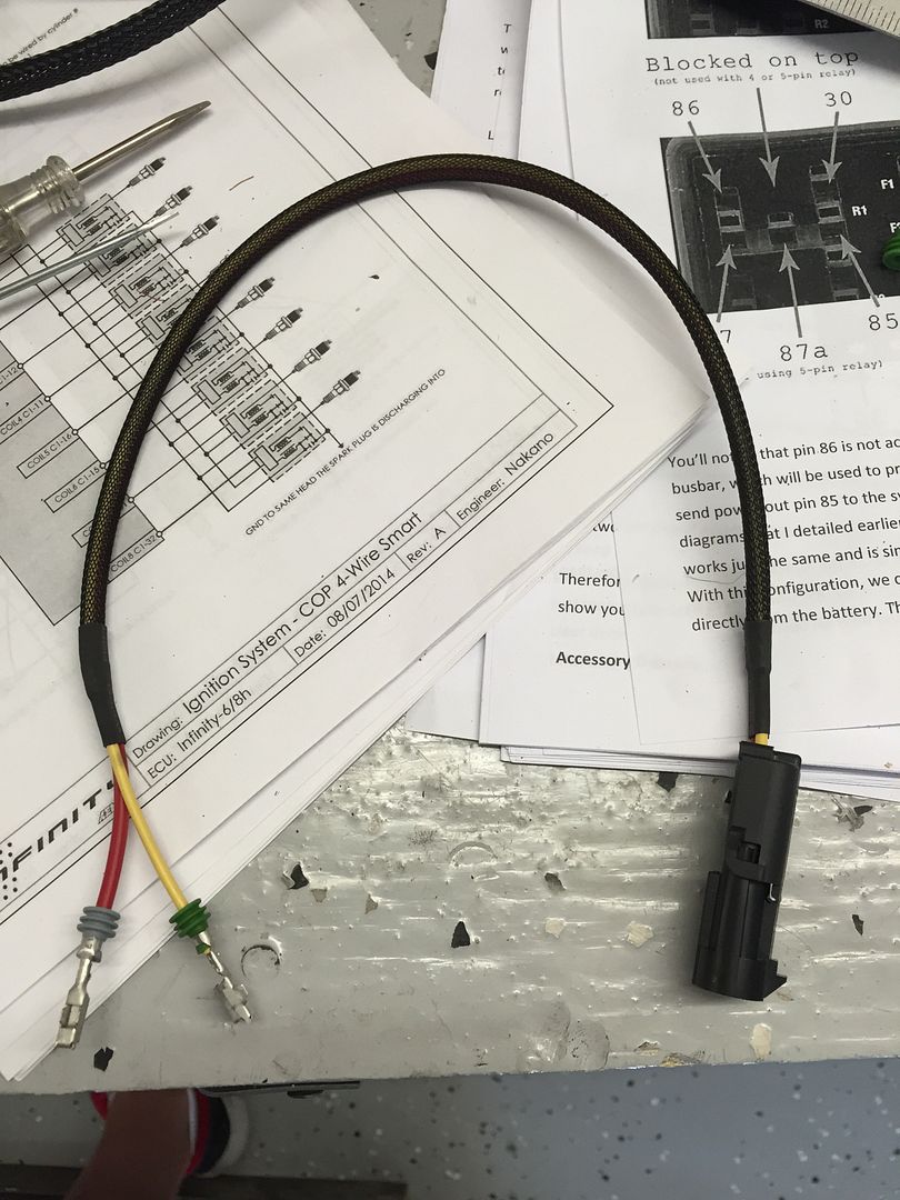

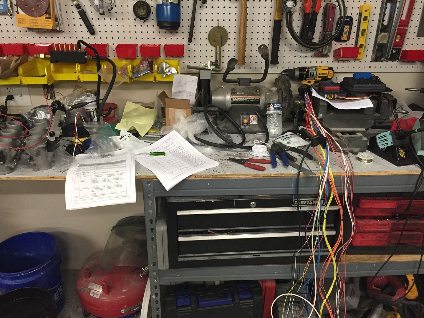

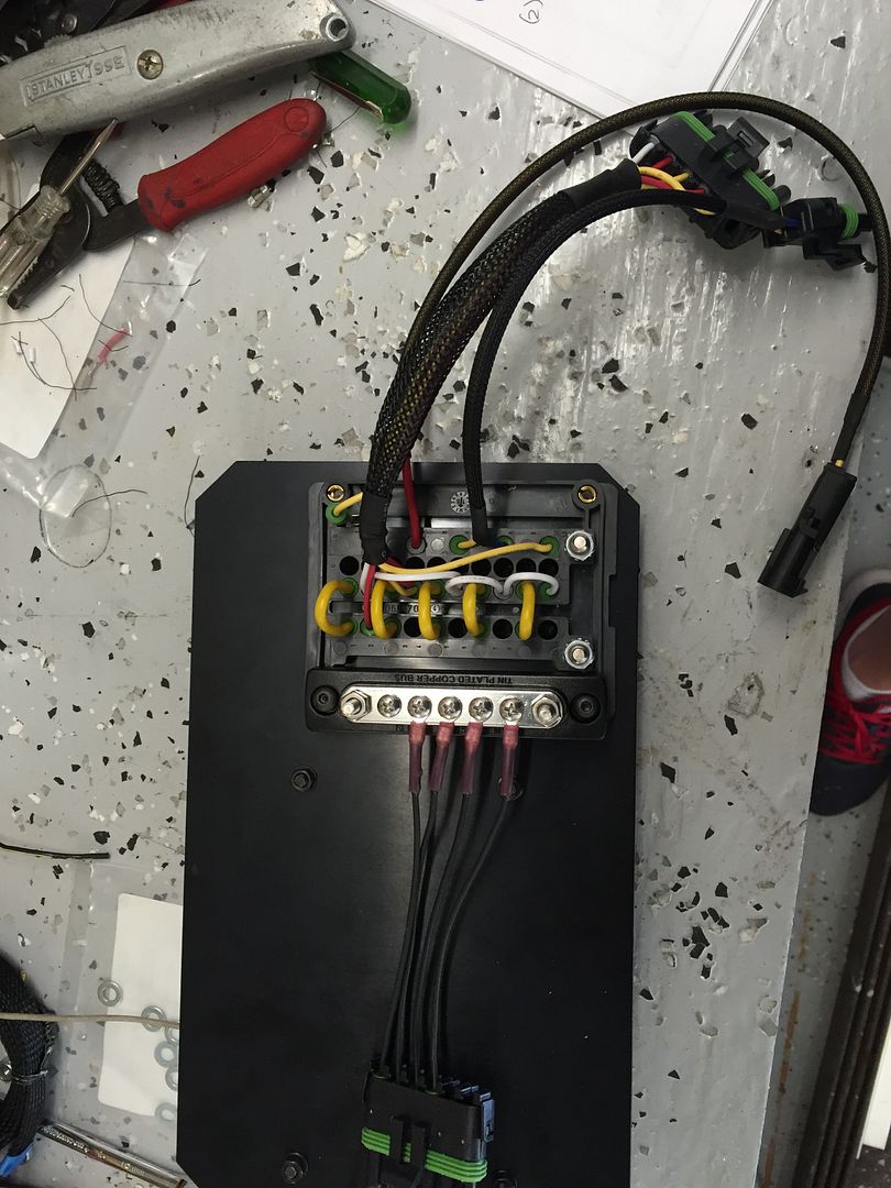

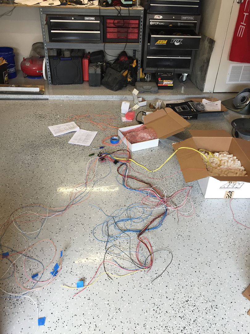

The start of the wiring came next
I started with an universal flying lead harness from AEM, this harness is a good start but needs some modifications. It comes wired for 8 cylinders with 8 coil and injector leads, and fan relay output, all of which I don't need. Pulled those wires out and added fuel pressure, oil temp, oil pressure, analog input from existing AEM AFR gauge, knock sensor and probably a few others i'm forgetting.

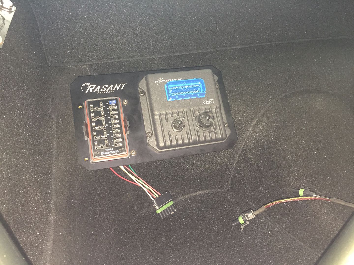

Bussman fuse/relay center with Infinity ECU mounted to the Rasant bracket. This will be installed somewhere behind the passenger seat.
More wiring...
Relay panel wiring... Installed circuits for the ECU main power, fuel pump, injectors, coils and O2 heater.
Then started the braided sleeving
These plugs are for the ECU main power, fuel pump, injectors, coilpacks, grounds, and O2 sensor heater wire.
One of the front of the fuse panel

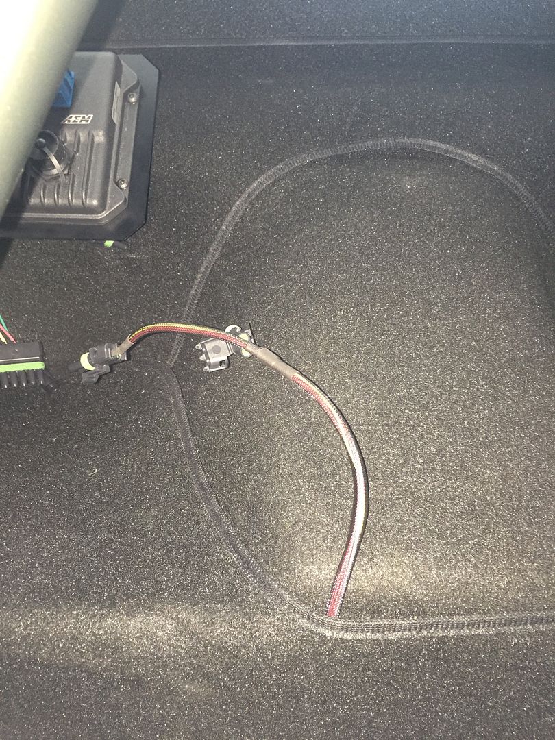

I installed the bracket and ECU in the passenger rear seat, there was not any room on the floor because I have a roll bar. The ground is attached to the old seat belt hole.
I ran new wires for the fuel pump, ignition switch and lead from the existing AEM AFR gauge through the tunnel to the ECU.

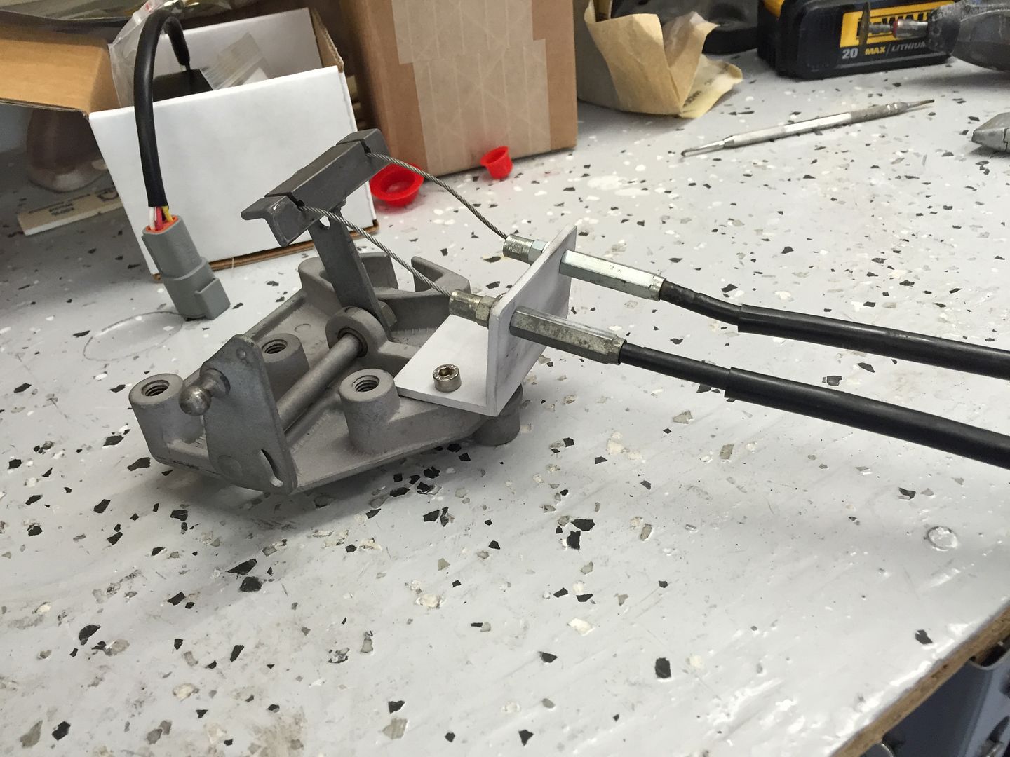

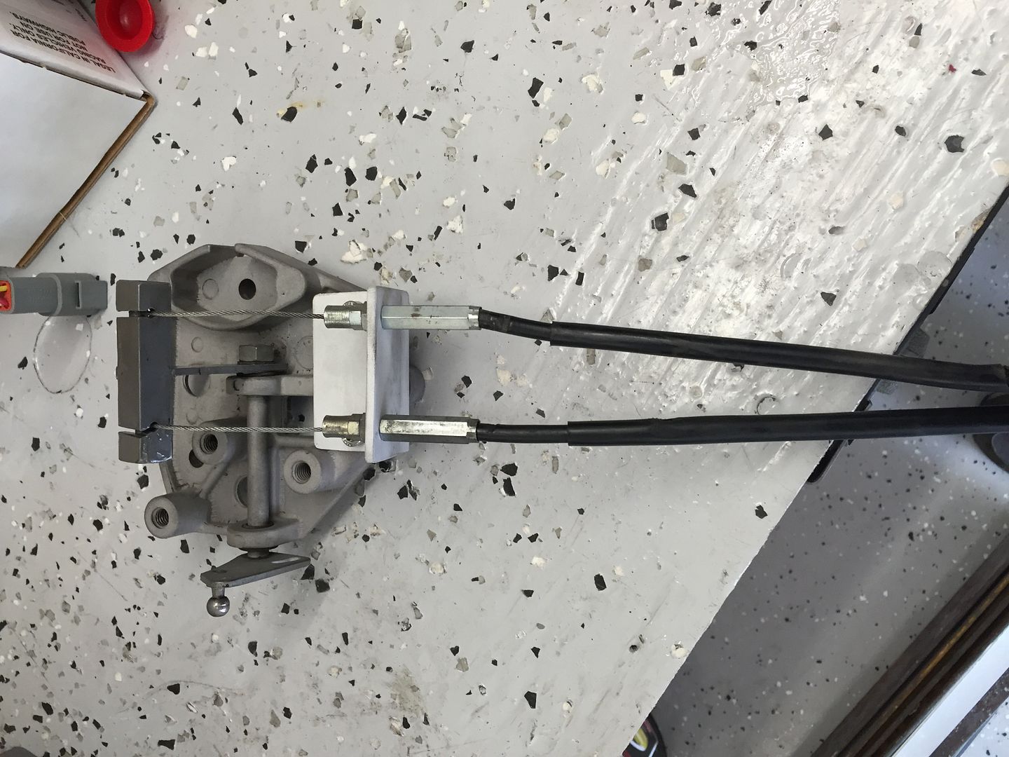

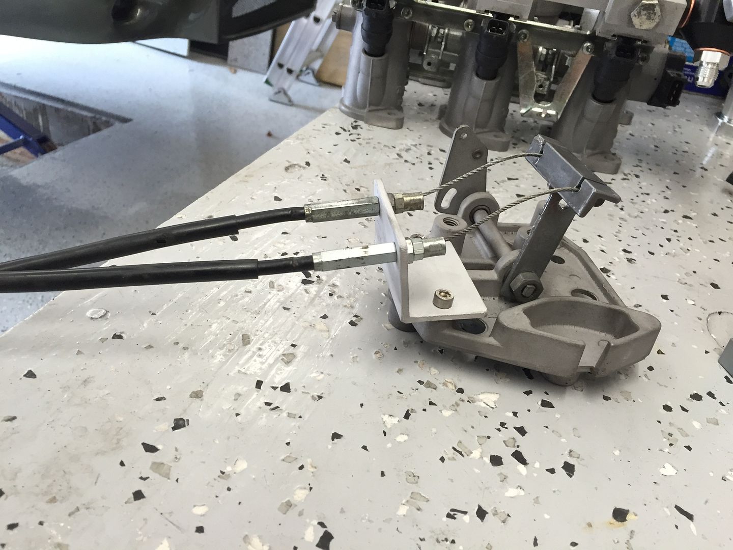

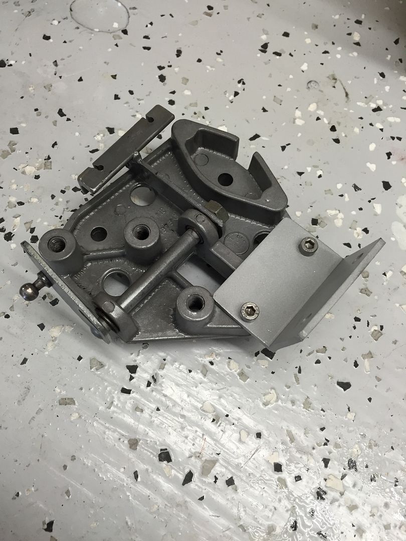

Originally I had planned on using Triumph motorcycle cable linkage.
I've decided to use modified Weber crossbar based linkage instead, but wanted to show want I had come up with using cable linkage.
Using the CIS throttle bracket I posted earlier, I made a bracket to hold two triumph linkage cables and welded a steel angle to the CIS linkage to attach the cables to. This would likely need a spring to help the return, but there are springs on the up stream throttle linkage and spring on each of the ITBs. There will only be able 1" of travel, so i'll have to get all that dialed in once it's all installed.

Are you having intake manifolds casted somewhere? Or are you using 3D printed manifolds? If using printed manifolds, what material?

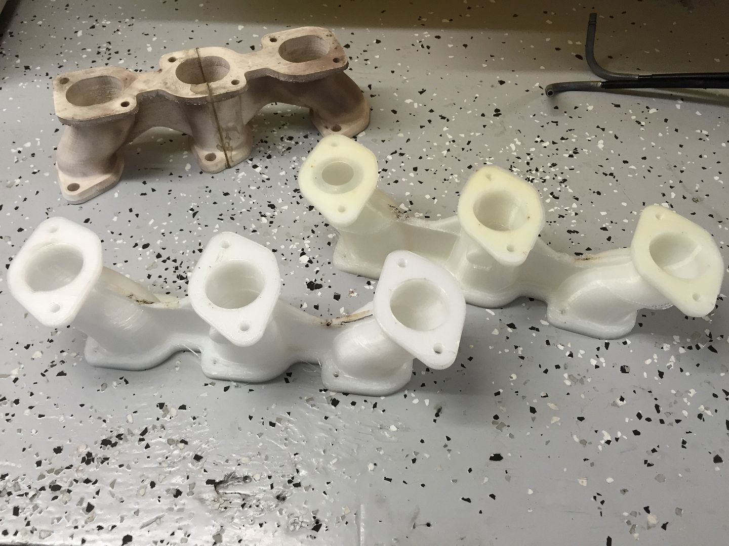

Nice project. Love the use of the 3D printer. Just a careful note about the manifold. The printing process works great for mocking up. I have researched these materials for printing quite a bit for automotive applications. Most of them are not suitable for actual usage beyond a test. Keep in mind that ABS is not solvent compatible. It will dissolve itself from the inside out with the fuel mixture. There are some PET and PET/Nylon blends that would work but have softening issues. I fully support this process but don't want to see a meltdown on the new system.
Yes, but i'll get into that below...
Originally Posted by al lkosmal View Post
I thought you might like to see this pic of my proto bellcrank mod. l
Always love to see your work! Thanks again for all the inspiration!!
You hit the nail on the head with this statement.

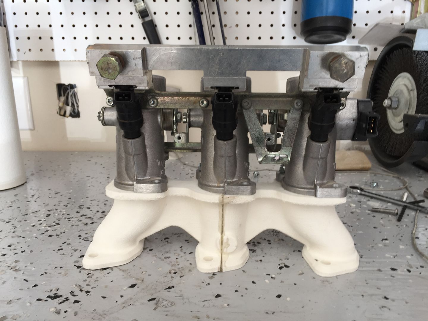

The original idea was to install a 3D printed manifold.
The first 2-piece printed sample was ABS and very hard and machinable. It printed well and was relatively accurate.
We then printed some in Nylon. These ended up being much softer and more difficult to print. The two below that are a single piece are Nylon. The tolerances were much further off with these and during the printing process they started to sag, you can kind of see a line mid-runner where they shifted. I tried to clean them up and even coated them in a fuel tank epoxy, but in the end, I didn't want to risk them leaking fuel or not creating a good seal.
http://i35.photobucket.com/albums/d151/c_hundley86/porsche/AFDB39B5-D6AC-4B17-826F-7E97C816C8C6_zpsn4hd1ijz.jpg

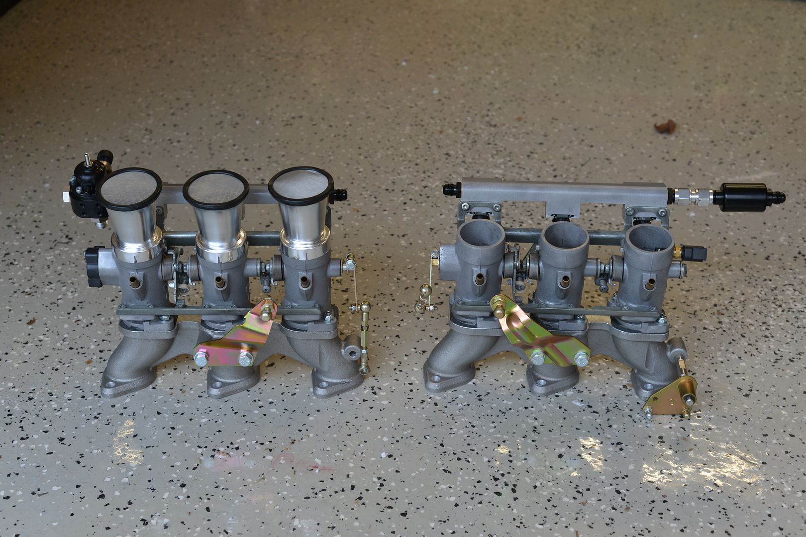

After messing with 3D printing for a few months, I finally bite the bullet and had a pair casted in aluminum. On these I included bosses' for Weber/PMO crossbar linkage and a pivot rod for the Weber/PMO bellcrank.
At that point I ditched the idea of using cable linkage and picked up some modified PMO linkage from Al @ x-faktory.com .
And one of the hardware mocked up with the distributor and plug wires still installed.

The 3D prints I had made were not used for the casting. I just sent the casting manufacturer the files.
I assume the modified linkage is to match the arc travel of the entire system.

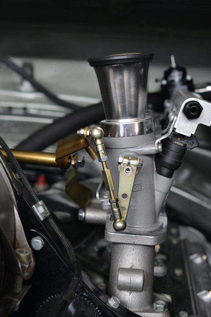

Indeed. Weber carbs open up by pushing down on their linkage. The Triumph ITB's open up by pulling up on the linkage. So Al's linkage modifies it to pull from the top.

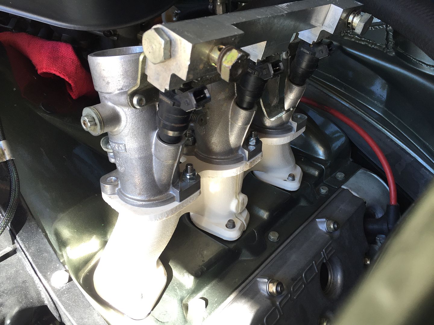

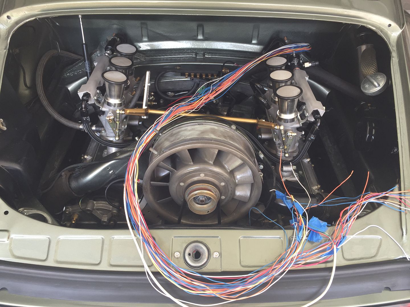

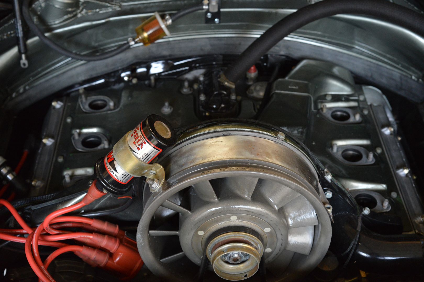

Speaking of, the hardware is installed.
I pulled off the Weber's I had on there before and was left with a relatively blank slate. I reused the phelonic spacers that I used with the carbs.
Installed the linkage on the ITB's.
I'm using a Russell 650133 inline fuel filter and AEM fuel pressure regulator
The black fittings on the triumph fuel rail are M12x1.5 to 6AN adapters to run 6AN fuel line and fittings
And onto the engine for good and removed the rest of the carb fuel setup.
I tried to keep the linkage parallel to the ITB's to start which worked out well
Then removed the stock distributor, MSD and plug wires.
Installed a fuel line between the two ITBs like a 3.2 setup.
and pulled the AEM harness into the engine bay to start the engine wiring

One caution, I'd ditch that AEM dizzy adapter, it is not accurate enough in my opinion for what you're doing.
If it were fuel only, I'd say it'd be ok, but if full ignition control, I'd be hesitant using that.
Think gear lash and what that equates to in degrees!!!
Go with a crank trigger from GoingSuperFast.
