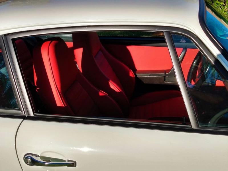

oh yes Brooke!...that does pop and I really like it! I'd do the strip....and that, to my way of thinking...would add just enough color/contrast to tie things together. But........I could be wrong.

I like the pop of stock door panels in red

Yah, I am considering doing red door panels with the black top trim/pullhandles/door pockets, like you have.

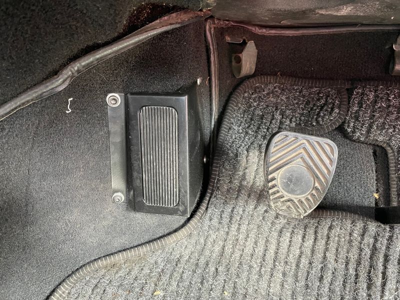

Installed a dead pedal. I’ve put one of these in all my older 911’s. I’m definitely a fan of them for spirited driving.

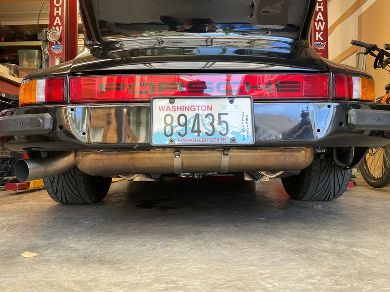

I’m currently running a 2 in 2 out Dansk sport muffler. I’ve had good success with these in the past on smaller motors, but with this 3.6 and B&B headers I am getting a lot of resonance in the 2000-3000 rpm range. Enough to give me a headache and make me resort to earplugs. I’m going to look into alternative options on mufflers. I’m thinking maybe a Monty M21 2 in 1 out.

Continuing to shake down and sort the car. The Monty muffler is a HUGE improvement. It is much quieter than the Dansk 2/2, but still has a nice deep tone and an authoritive growl under hard acceleration.
