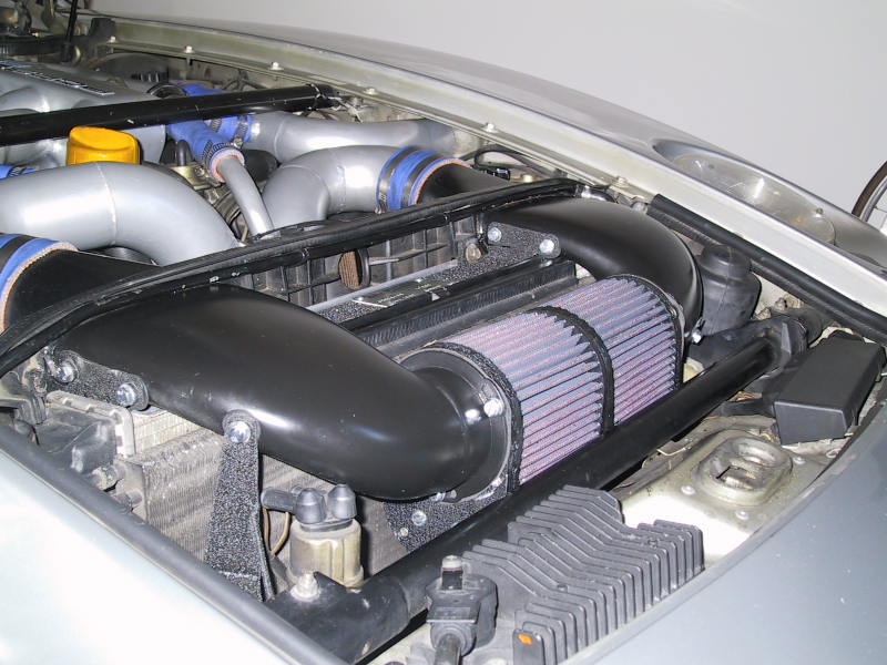

I've been very busy this summer making some mods to the twin turbo system...more like finishing touches to it. My engine bay now looks pretty freshened up with the newly powder coated intake and plumbing. While I had the intake off, I fabricated an in-block air/oil seperation system and also installed the 2 other breather ports into the valve cover on the driver's side. I introduce purge air in on either side of the engine through the non-cupped breather port, then vent the air through the center port and as well the two additional valve cover ports. Then out to the Provent, so there are two air/oil seperators in the system. Thyanks to Louie Ott for the advice on the crankcase breathing methods.
The air snouts went through a mounting upgrade and now use a different fastening method to keep them fully secured down with zero movement. It took some time, but they turned out very nicely. I also added a serial number tag to the system and stamped mine as S-001. Serial numbers S-002 and S-003 are in production right now.
I'll be putting some videos up on youtube that cover an entire 928S4 twin turbo conversion...start to finish.

The car for Serial No. 2 should be here next month sometime. This will allow me to make certain all documentation is done for the system. It will be good for me to see it all fit in to make certain everything is just right and falls into place as planned.
The work is never done...it's part of being an Engineer at heart. There is always something which can be improved upon.

I still hope you decide to sell the dual cone system for us N/A guys.
Old 07-27-2009, 01:27 AM
Herr-Kuhn's Avatar
Join Date: Aug 2006
Location: Cincinnati, Ohio
Posts: 1,019
A few people have mounted the air intakes on other projects. I think I've sold 3 or 4 sets this way. For me it was a necessity based on the spacial constraints of the 928's engine bay. I'm not sure there is really any benefit for a NA car though...but I can't prove it either way.

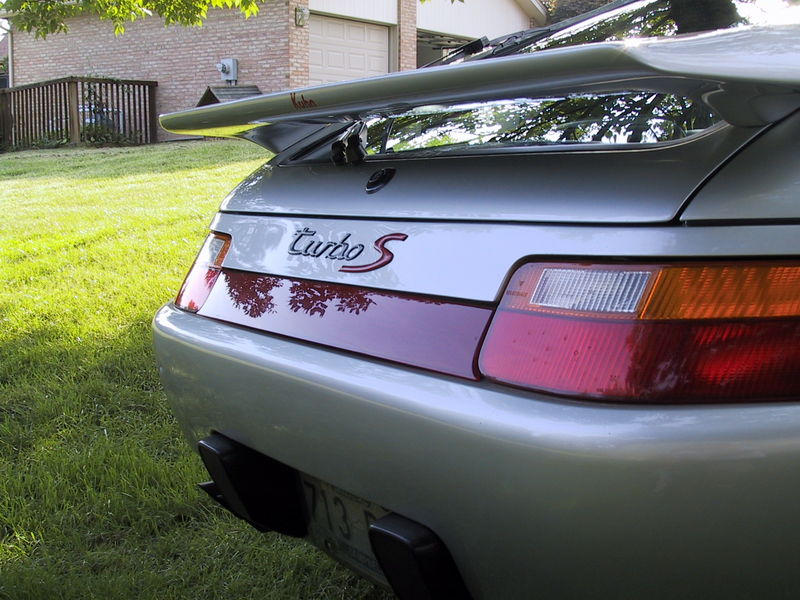

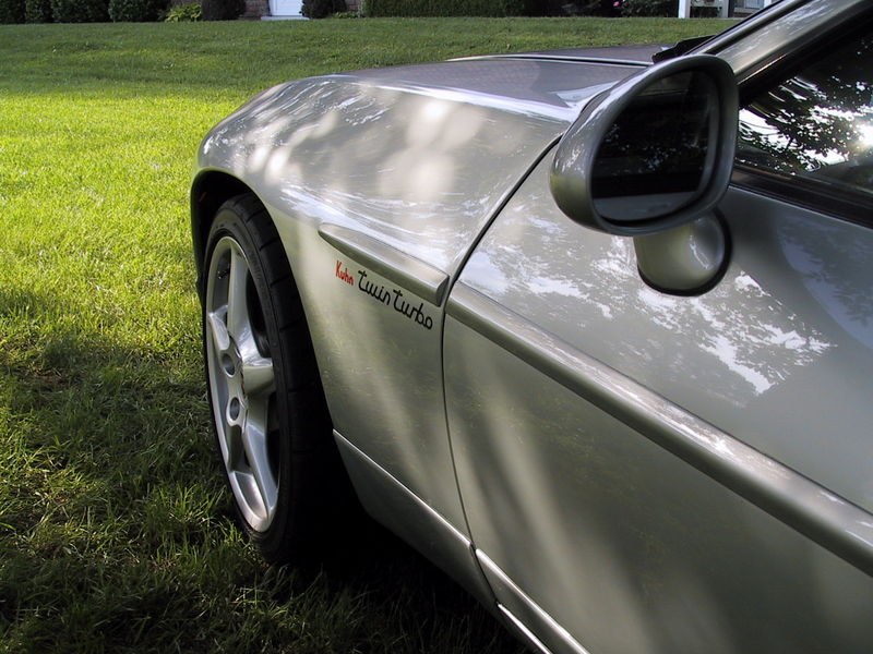

Here are some better photos in natural lighting:
