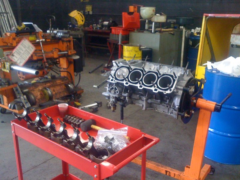

Ok so after getting the engine pulled and on a stand I started disassembling and cleaning it. The reason I am rebuilding is because Cyl #6 had about 6:1 compression with some coolant in the cylinder - so it was probably lower than that due to the volume of the coolant. This lead me to believe the head gasket was blown. All the other cylinders have perfect 8.5:1 based on 14.7 PSIA. The car has 131,828 miles on what I believe to be the original ODO.
Engine on stand:

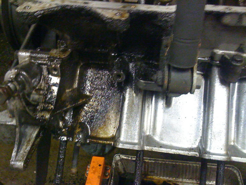

sludgy oil pan (on the outside):
And after some "brake clean":
Can you tell the difference???:

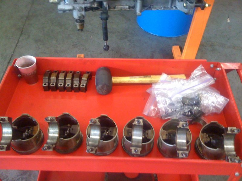

OK so I got the pistons out. I'm really happy with the way this motor looks inside.
I also just ordered a butt-load of gaskets from pelican and getting ready for the reassembly. Hoping to have the engine reinstalled and running by the end of the month.

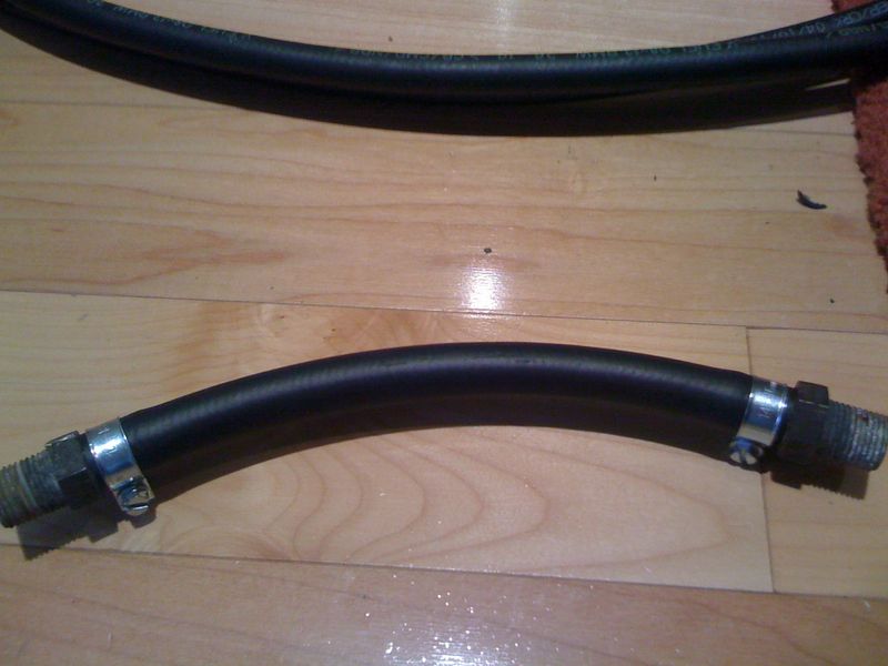

I feel like this has been asked before somewhere but what is the best way to go about rebuilding the fuel lines? I ordered the high pressure hose from pelican, are the fittings reusable? Or is there somewhere I can buy new fittings?

Also I rebuilt the fuel lines and installed them in the car, the old ones were just scary and I'm lucky they didn't leak when I drove the car home. I replaced the hoses with 180 PSI Working Pressure fuel injection hose so they should last a long time.
Here's some pics.
Before:
After:

OK. so I havn't posted anything on my engine rebuild in a while. It sat for a while but I have recently been able to take the engine to work at Midas, and work on it when I'm clocked out.
So here's what I've accomplished:
-I took the cylinders out and cleaned them up along with the rings and the rod bearings.
-Drilled out, tapped, and thread inserted the #6 spark plug hole. I used a drill press and an expanding thread insert kit so it actually went very smoothly.
-I cleaned the block with more brake clean and cleaned the gasket surfaces with a fine rotary buffing disc thingy.
-Then reinstalled the pistons using moly/graphite assembly grease on the wrist pins and the bearings.
